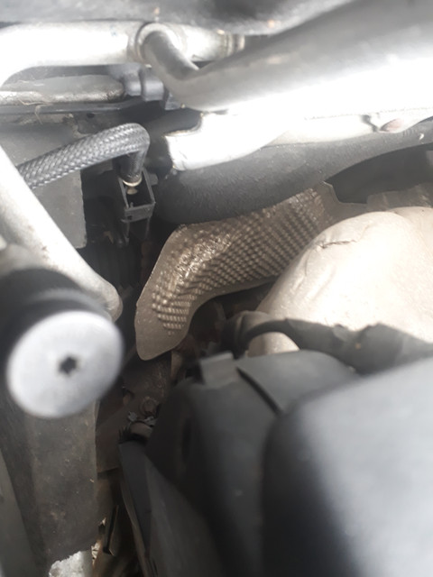

Interesting. If we're talking about #75 and the heat shield #5, I don't remember these having been mentioned before.
If "lump" removal (to tidily fit a protective gaiter) is done, what does that mean for the heat shield - or wasn't it fitted to all models?

I have a petrol, so I would guess it is to protect the rack from higher exhaust temperature on a petrol VS a diesel...

Yes, the heat shields are only fitted to the petrol model, not the diesels.

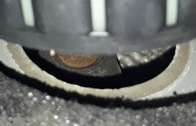

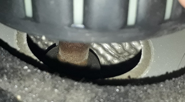

Looking at your picture above - yes, looks like it won't be long before yours fails I'm sorry to say
The rust build up is already there looking at that, but it's on the lower part of the pinion that is hidden inside the rack where the rust starts bubbling and deforming the seal until inevitably the leak will slowly start and get worse.

No worries at all, I prefer to go ahead with open eyes rather than being caught by surprise ! And if I can had my 2p comments/feedback...
So...what are the symptoms on a non-hydractive car ?
Oil leak through this seal ? Contamination is the steering liquid bowl/tank ?

If you have conventional metallic suspension, then you will have a smaller LDS tank just for the steering. So the same issue really - the LDS will start coming out from the top of the pinion area when it does finally deform. I think you can just about see the black seal from the last picture - it looks a bit squashed in places as the rust has started to misshape it.
