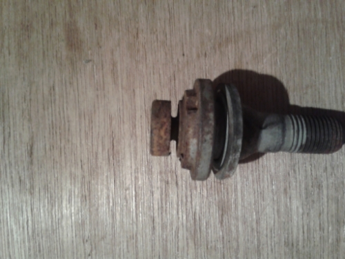

Found a "cheaper" solution to my problem ...

Interesting, but I think you would want your lovely car to remain intact, and not slide sideways under the load. Good luck anyway in how you resolve the issue.

grr bobins I lost one of my security bolts after my rebuild
I brought a normal bolt last week to fit..
Vb, what a pain.. I once banged an old 18mm sockect on (19mm wheelnuts), and was lucky.. if you have a decent quality 16mm to sacrifice, you probably will win...
tough call..
tough call..

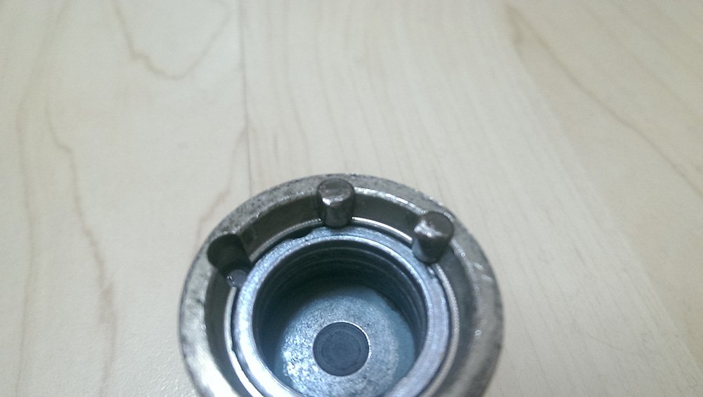

Regarding the security bolt adapter (key), here's how mine looks like ... not that damaged, but obviously, enough ...
I've read on the net that it should be possible to order just the key (general discussion, not related to any specific car brand), but you have to have the VIN available (duh ...) and the wheel key code (alphanumerical combination, sticked as a bar code on the plastic bag that usually contains the adapter (key) ... will see how that goes ... if not, one mechanical solution would be to use the reverse drill, and reverse screw, which should give the same result like the Emergency Wheel Nut Remover ... in the worst case, some welding will be required ...
Afraid that pattern is nothing like my spare one

You may need to be a little creative if you go down the brute force or welding route as the security bolts have a weak point built in......vborovic wrote:
I've read some reviews for the Emergency Wheel Nut Remover as Sticky suggested, and there are mixed results ... but that seems the cheapest solution so far, even if I'd have to buy two sets just in case

On one of my Citroens with that type of key there was a number stamped on the key and when I knackered it like that it was simple, go to pug dealer/approved citroen repairer, give him old key, they ordered another which was posted direct to the house. The end of these bolts break off if subjected to anything other than the proper key, and the centre of them are hardened to stop you drilling them. This I know from experience when I knackered the new replacement key. Now I get these lockers off and bin them and put on normal nuts. The most akward of mine, I slackened the other 3 wheel nuts and drove round a deserted car park until it broke. Not exactly a recommended method of removal [emoji48] [emoji4]
