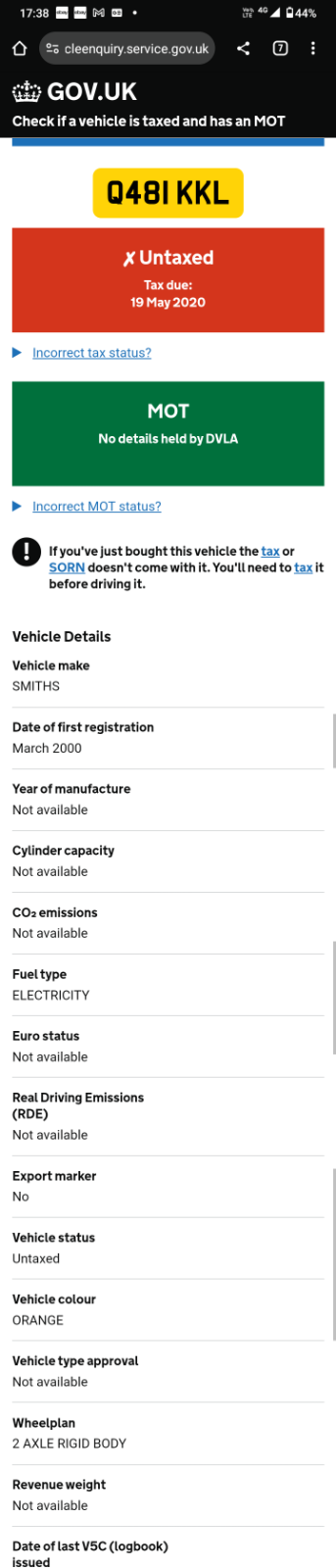

Q plate as said indeterminate age or its been through Single Vehicle Approval (SVA)
The pale-eat orange I've seen for a while!

Hmm, no tax, built 2000, do electrics pay tax after 23 yes? Or have I stumbled onto a crime syndicate....

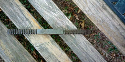

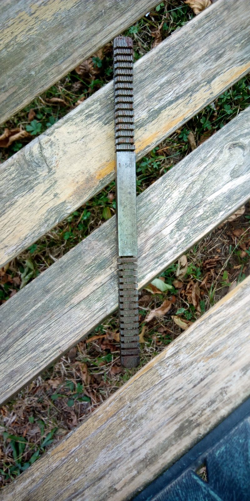

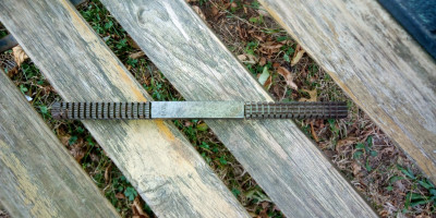

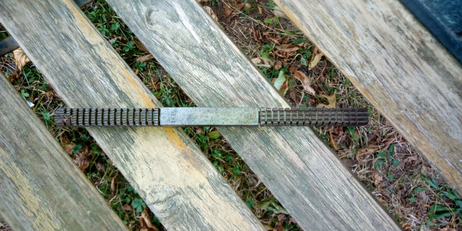

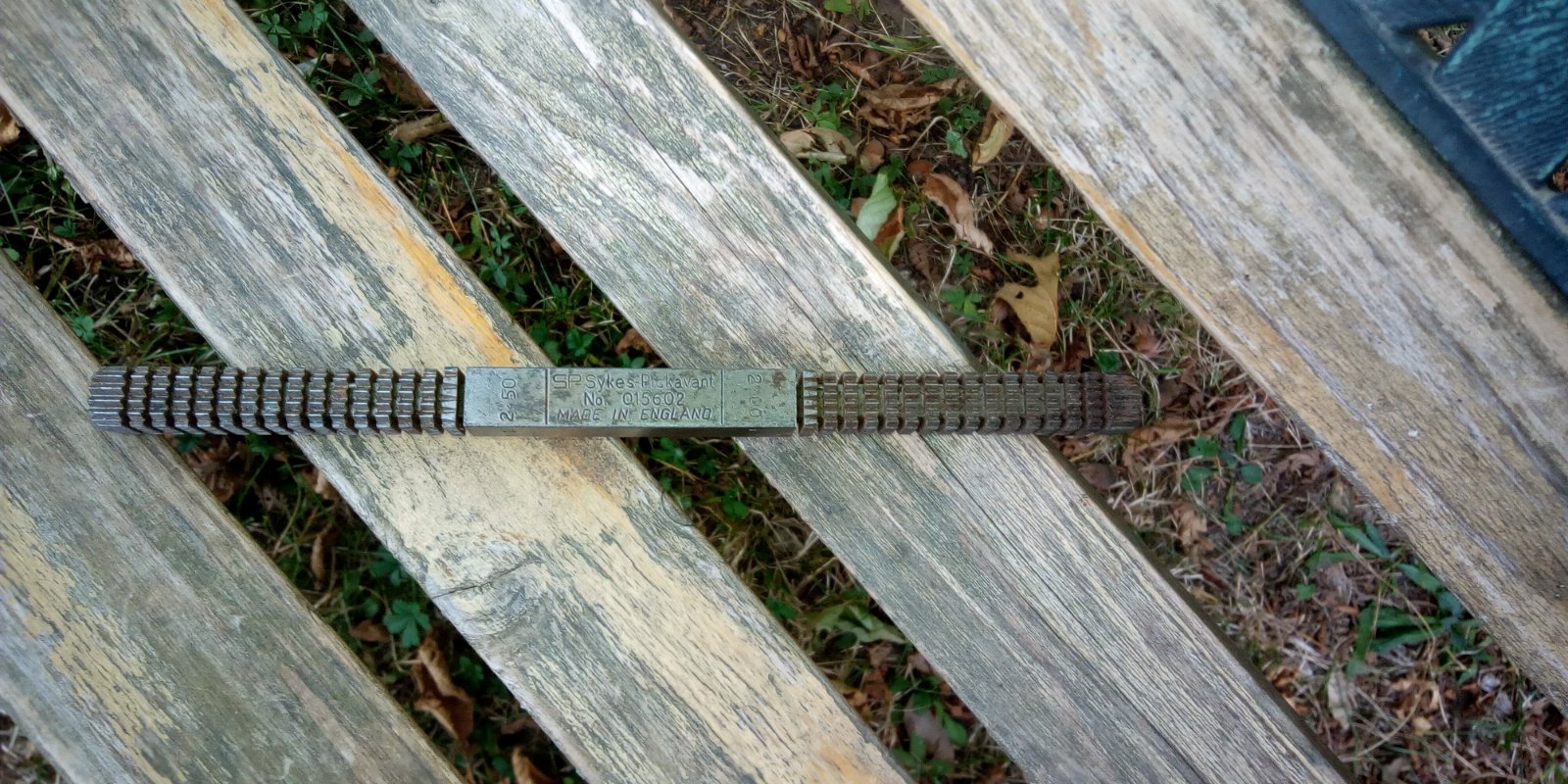

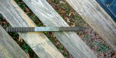

Come on then, what's this?
Came out of my mate's dad's toolbox when he was clearing stuff. Neither of us are retirement age so never seen one. Guessing a thread pitch measuring tool but why so many?
Thought I'd put it to the old gi..., sorry, more experienced people on here.
Any ideas? Love to know

Is it some sort of gear/cog gauge?

Onesuch was recently mentioned in another thread and an example purchased and used.
- Posts: 26424
Re: Whatsthisthen?
They are referred to as ‘thread restorers’ here, in various sizes

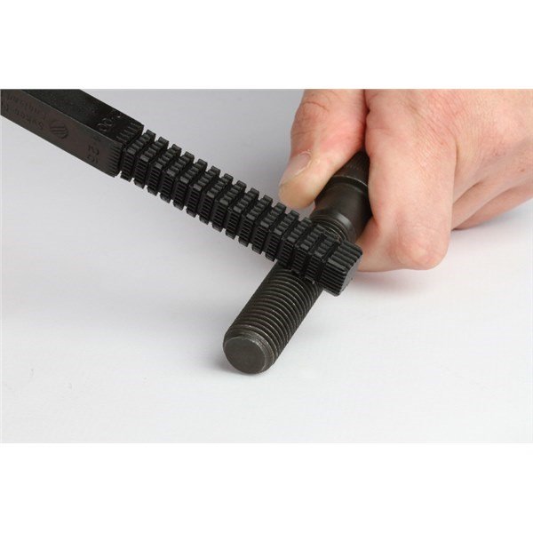

Ta, just did a search. Wasn't far off with my guess, How could it be used when a conventional tap doesn't?
Edit....Die, not tap

Good question, how do they work?

Just checked and now I understand

Which is why it works on lh and rh threads, blimey, simple but clever tool

I think I'd be putting the thing that needs re threaded in a drill on slow speed

Got two of those in my kit,
" by Rp0thejester » Thu Oct 19, 2023 5:04 pm
I think I'd be putting the thing that needs re threaded in a drill on slow speed."
Not exactly the answer if the screw is like the drive shaft talked about earlier, still in situ on the car.

First gear, idle speed and the opposite wheel chocked then, surelyGibbo2286 wrote: 19 Oct 2023, 18:36
