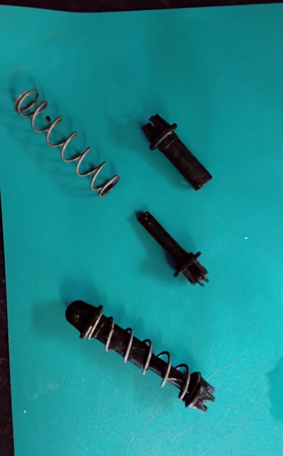

clutch pedal repair
First task remove the return spring on the pedal
It fell to bits
Spring has sprung !
Spring has sprung !

Above the broken original compared to a new part .

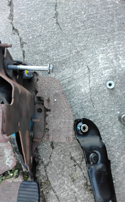

MAJOR UPDATE

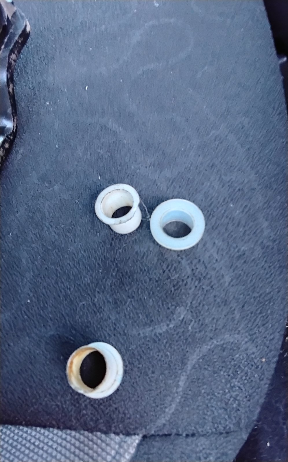

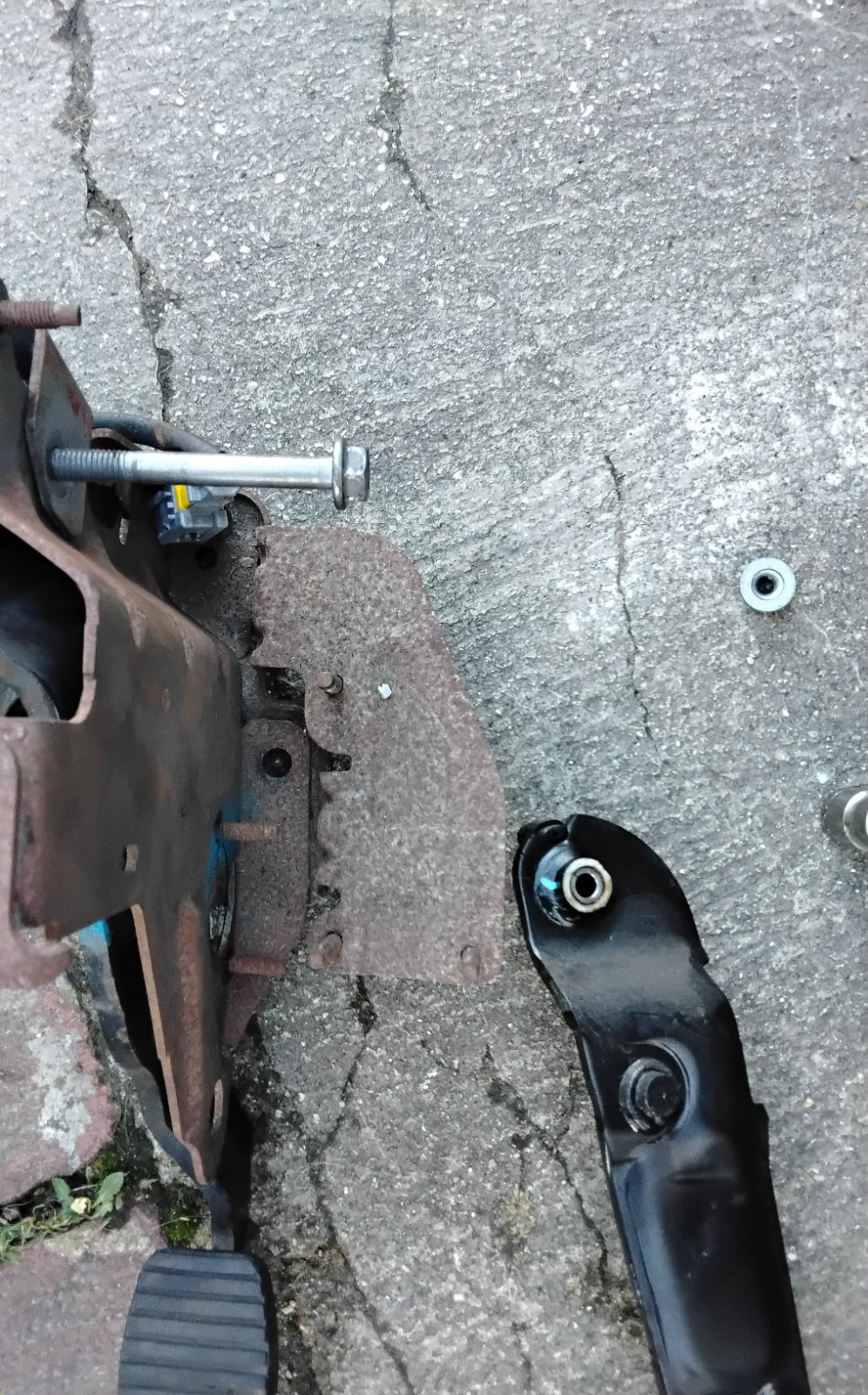

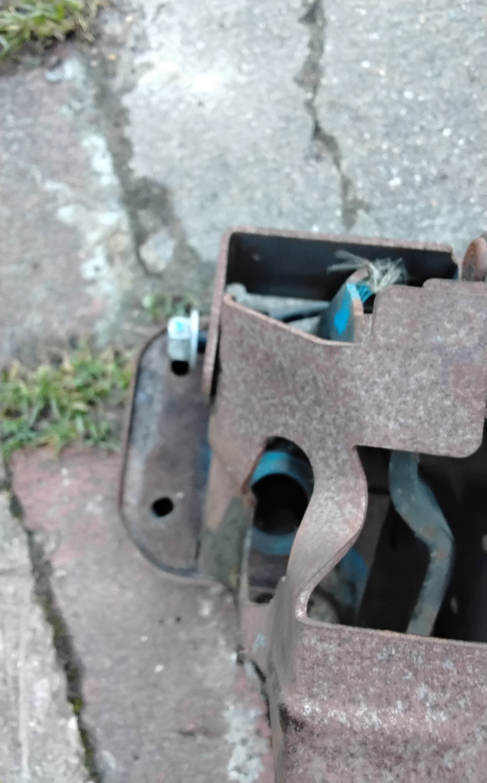

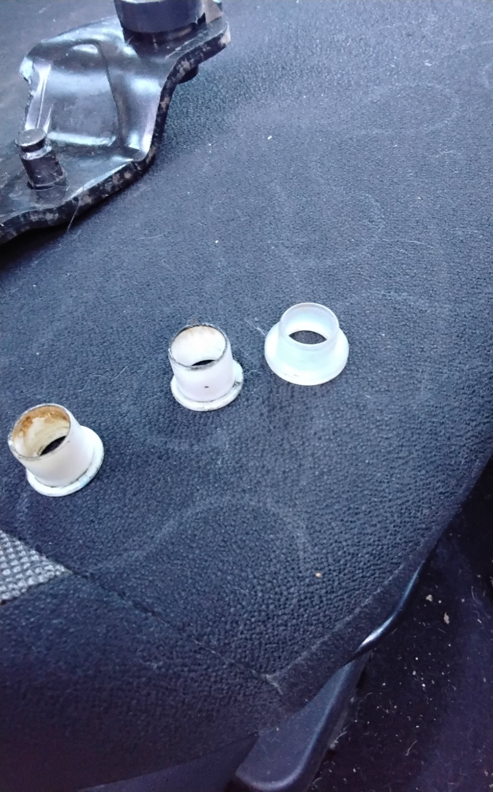

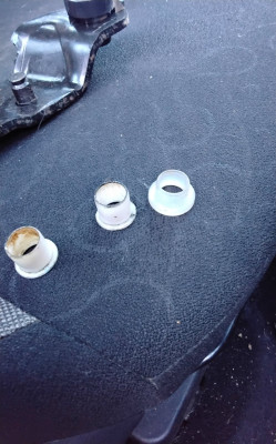

So ontop of the pedal box your will see a 13mm nut & bolt that goes through the brake & clutch pedal metal dowls & nylon bushes.
So removing the 13mm nut with ring spanner & small rachet with 13mm socker get the covers out of the way on the lower driver side dash it opens right up to be able to get your hands in to undo this nut & bolt on the pedal box , someone said it was a fitted pin type which cant be removed , utter billhooks its a nut & bolt , so i slide the bolt out just enough to be able to removed the clutch pedal , this is dine by lifting the pedal then sliding the pedal downwards its a bit fiddly but one your free of a switch which sits top read of this pedal then it can pull pull down and outwards towards you , once you work this out then your know it will go back the reverse way of removal with a little wiggle too.
WOW WHAT A SHOCKER !!!
The bushes in the pedal were worn , so i fitted the new ones , which one bush needed the coller cut so pedal goes back this dont effect the pedal postion at all. New bushes fitted i then refitted the pedal , wiggle push life , then it fell into place , the bolt & nut then in place and tightend up
OH WHAT A DIFFERENCE

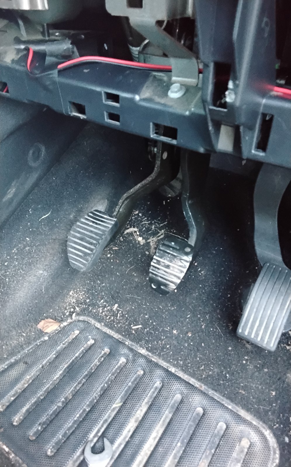

Yes indeed the pedal is like new there is no play what so ever , i didnt realize how much there was before till i did this repair , shocking very very i was taken aback by the end result & very chuffed.
Just look at them photos

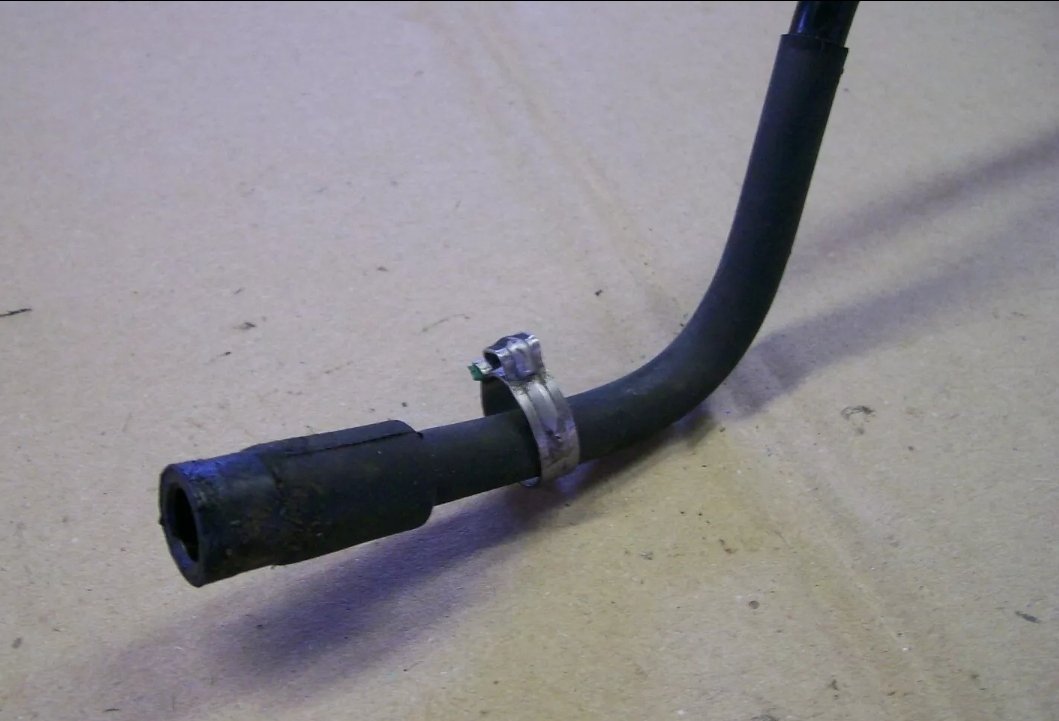

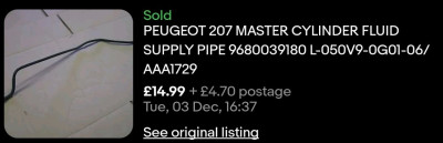

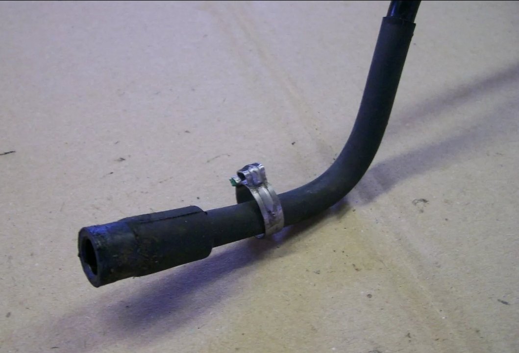

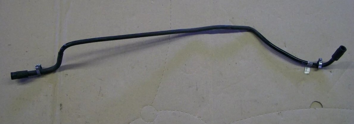

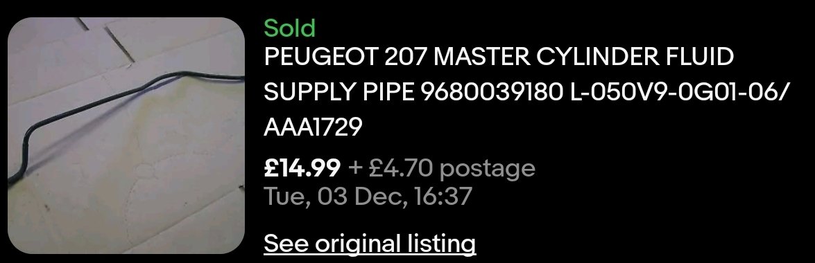

BYE BYE RUBBISH OLD FLUID FEED PIPE
So now this new clutch master cylinder has been fitted its time to fit from a 207 yes a peugeot , the fluid feed pipe , this was quickly done with just a little fluid loss , the new pipe fitted like a dream , each end squeezed on to its new home tighter than a mizers wallet . Not only that but each end had squeeze clamps to give it more support to keep them in place , unlike the other absolute crap design of a flimsy flexy plastic pipe that sat over the top of rubber gromits that sucked more air then an old worn out lester diesel pump.
So now ive done, pedal rebuild and all put back , all lower dash put back, nee clutch master slave cylinder , fluid feed pipe , it took 20 mins to fully bleed the air out of the system i can now say FIXED
The photo (ebay one ) is a perfect upgrade for these c3 picassos the lenght is the same but the fittments are so much better . See photos
