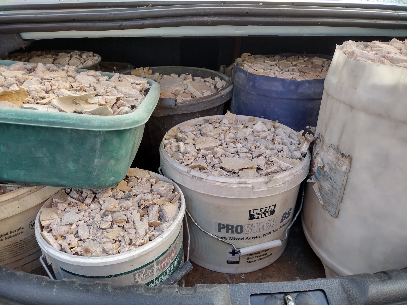

Trailer + bins of garden waste (pictured above) and
Coupe boot
Coupe boot

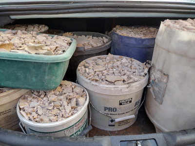

Full boot of plaster in buckets
All off to the tip this morning in the Coupe.

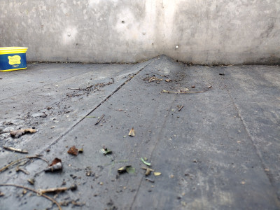

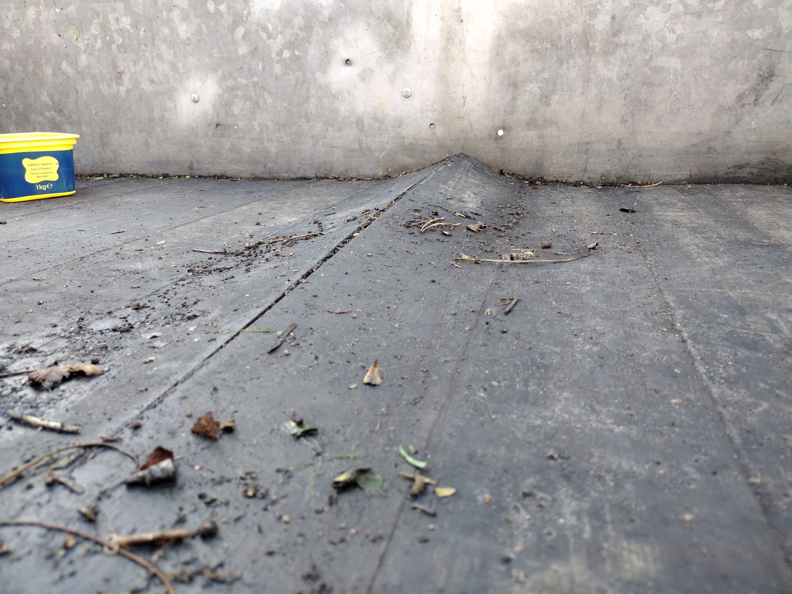

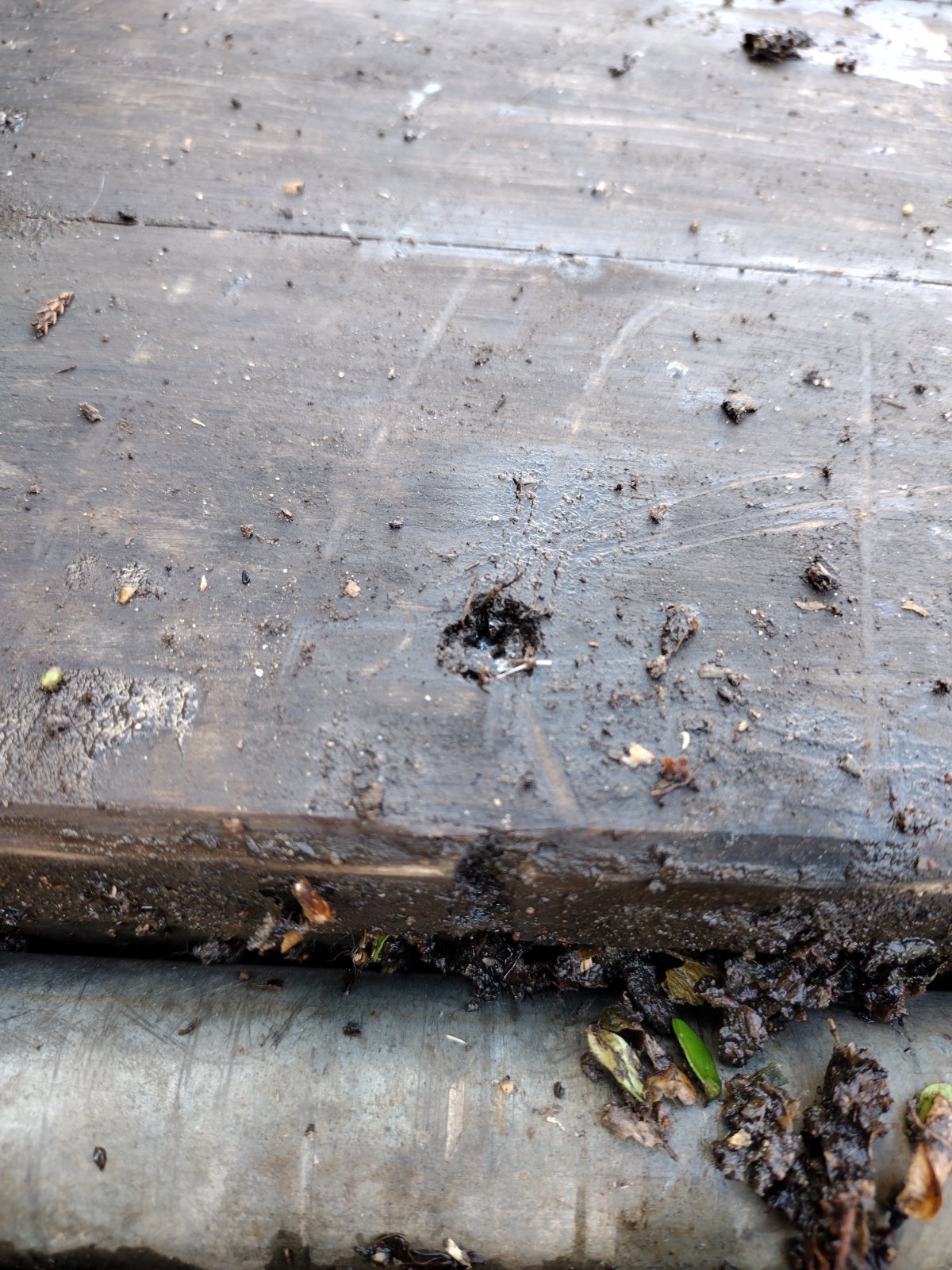

Trailer needs a fix if it's to carry plasterboard in the near future. This is the issue:
Traffic calming measure in what should be a nice flat floor.

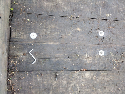

My tongue and groove floorboards, though thoroughly treated, have expanded in the damp conditions and are wider than when installed!

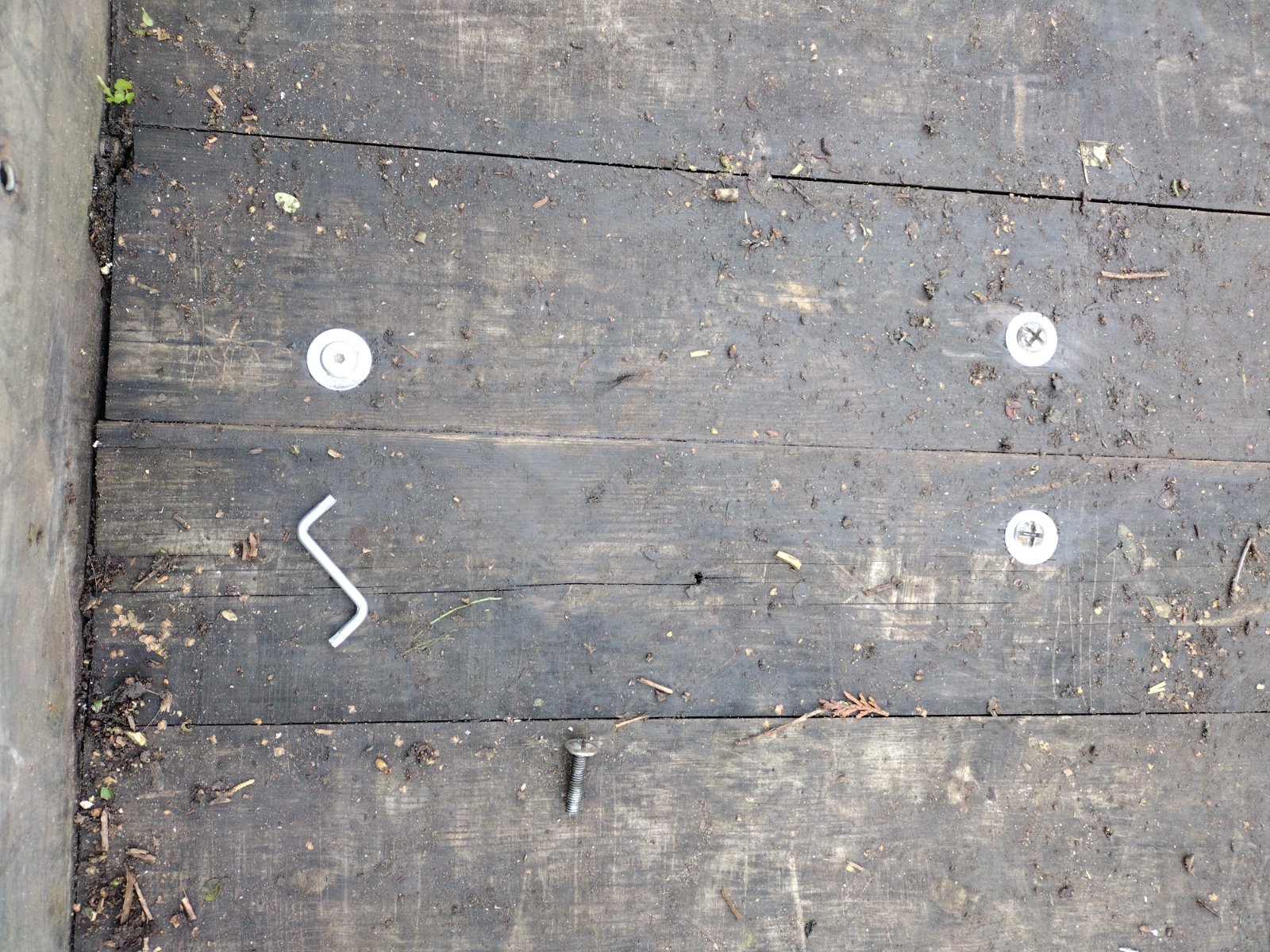

Next problem was these screws. M6 into the trailer frame. A lot more recessed than when installed! (IE the wood has grown around them!)
Spot the screw head!

Calling that fixed. Wood decidedly warped too.
Mix of 4mm Allen head (likely remove with grinder) and M6 roofing bolts (too short for the third fixing)

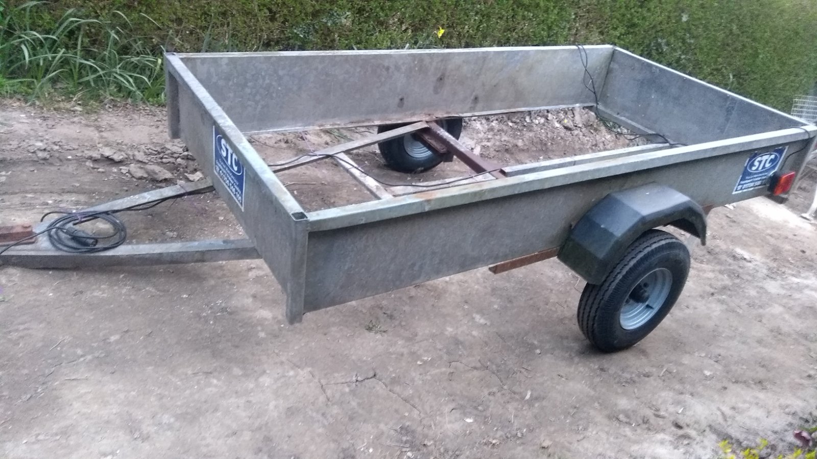

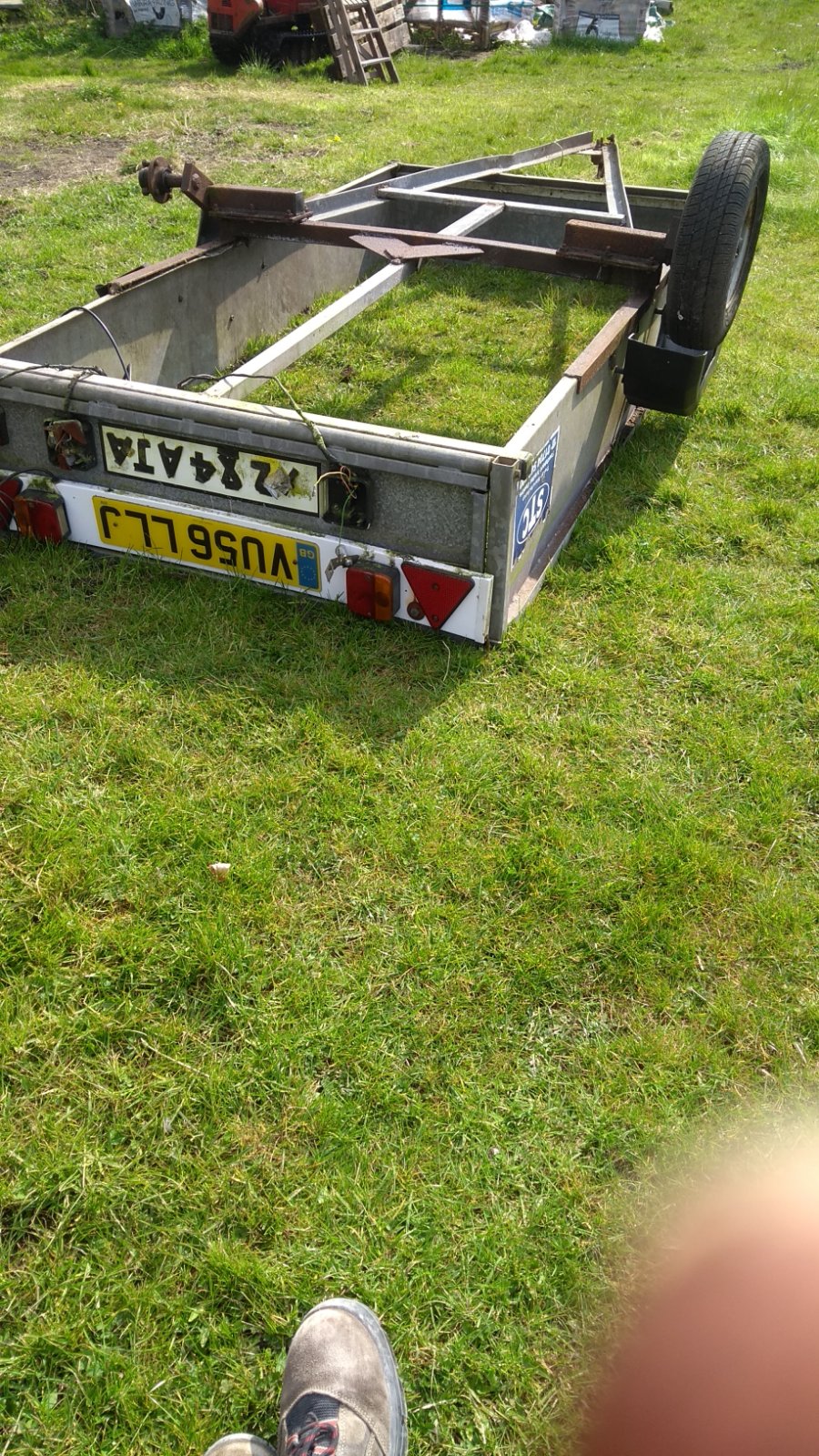

This is how the trailer was when it first came into my ownership:
Rather minimalist trailer deck!
It had sat on a farmer's field for an indeterminate amount of time.
I had a dig into what to make the floor from. Proper trailer boarding (effectively a waterproof ply normally with a non-slip coating and different glued used) = very expensive.
Marine ply also very expensive.
Normal ply doesn't like water much at all - delaminated in short order.
Galvanized sheet either cheap but bit too flimsy and thin, or nice and robust but bit expensive and heavy.
Possibly fishplate / Durbar sheet, stiffer, hopefully less slippery when wet. Again quite expensive.
All choices above also impacted by the trailer's dimensions= 1220 x 2500mm (larger, just than a standard 8' x 4' sheet = 1220x2440mm) so would give an annoying need for two sheets to cover it completely.
So, £35 worth of tongue and groove to get the trailer to get it functional and then change at later date if I can decide best way forward :)

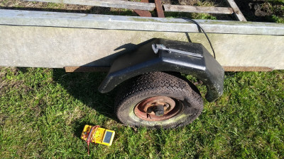

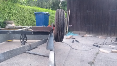

Was quite an evolving project really
Inverted, in field, preparing for the journey home

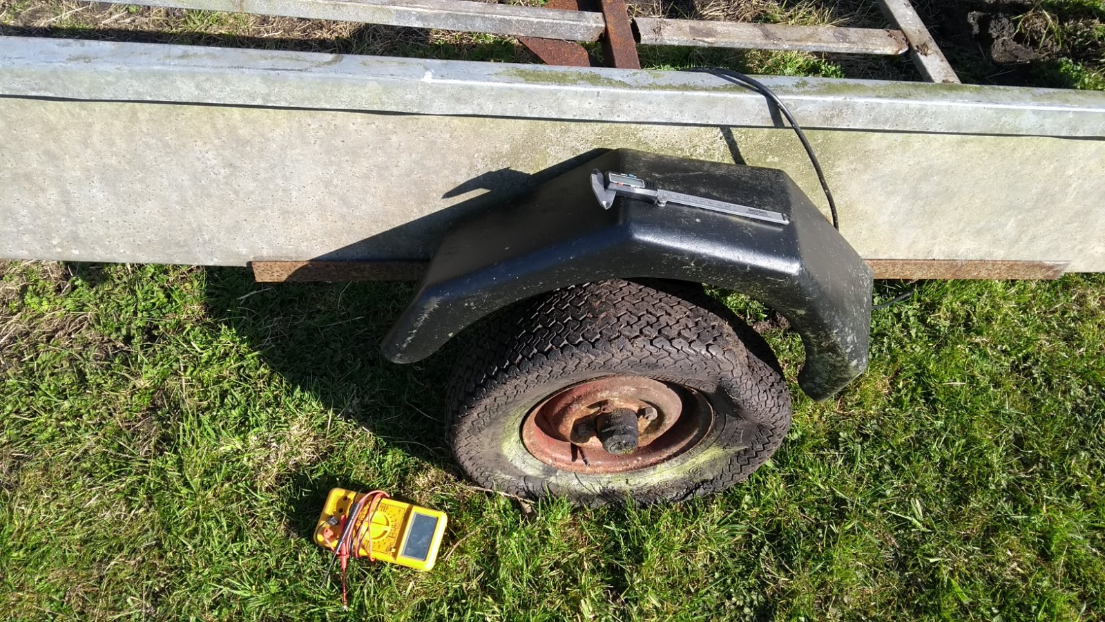

Trailer wheel one side, rusty ex mini / metro wheel the other. Fair to say that wasn't going to inflate or be safe on the road!

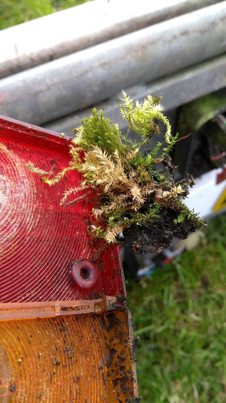

Microclimate inside a light housing ideal to support this moss!

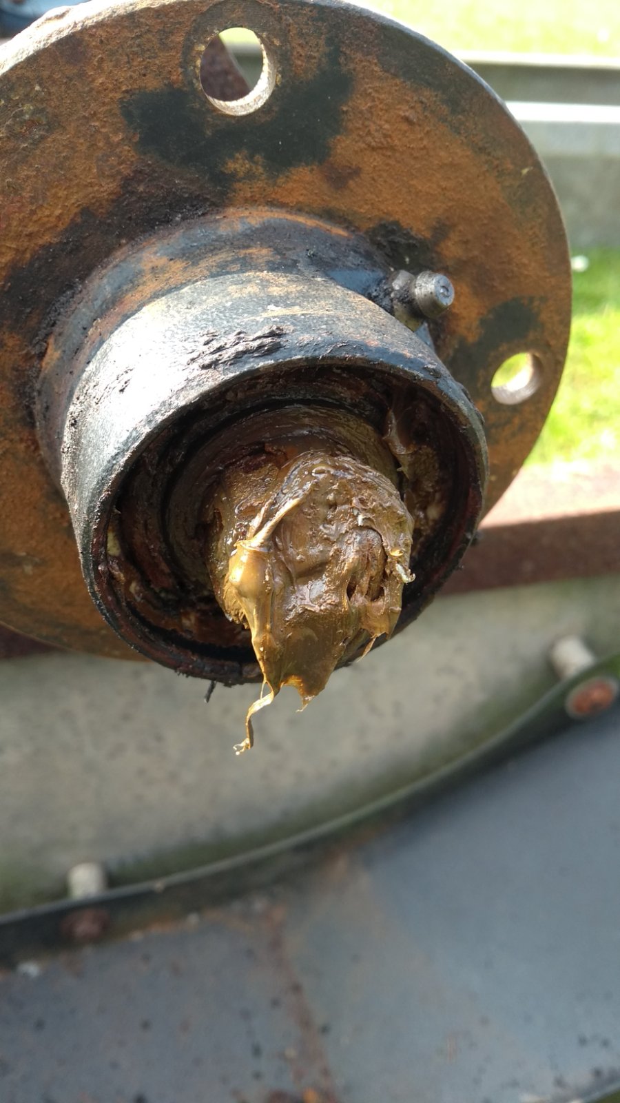

Grease probably rather overselling this crud inside the wheel bearing.

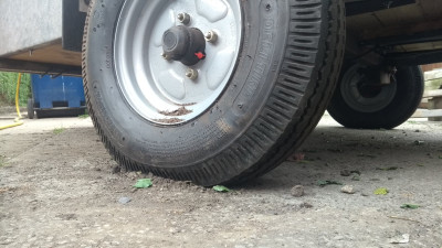

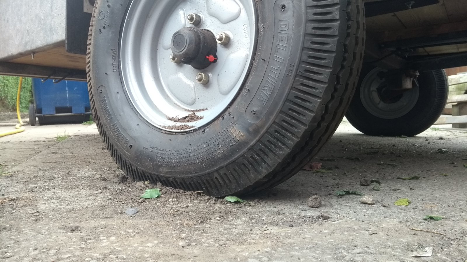

One of the first tasks for the recommissioned trailer was taking a load of soil to the tip.
In hindsight, this image rather explains what happened next
Tyre pressure ok, but rather under strain!?
On route to the tip, a wheel fell off! Thankfully only about 30mph at the time and fortunately the wheel carried along the road without hitting any of the surrounding traffic - it followed a line of cars who set off at just the right moment (roundabout with traffic lights) so as to clear the way. Wheel continued in a straight line and came to rest in the bushes in the centre of said roundabout. All happened very much in slow motion and still very conscious of how lucky I was that day!
Having not considered the density of the clay soil, quick conservative calculation after the fact says my "500kg capacity" trailer probably had 1000-1200kg on board that day. I am endeavouring not to be quite so daft / oblivious going forward.

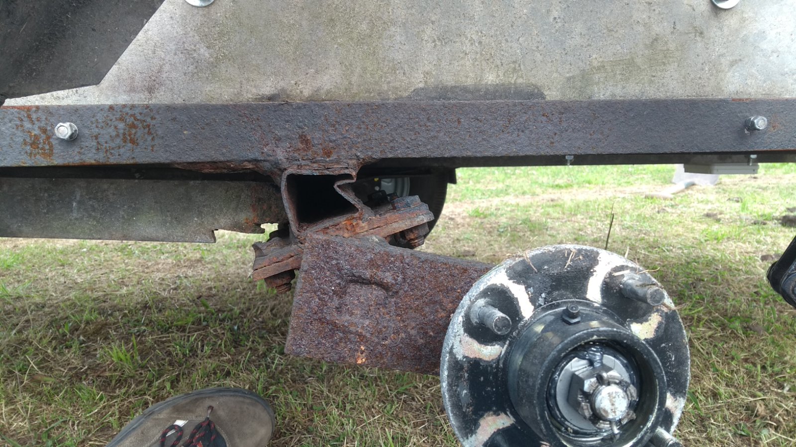

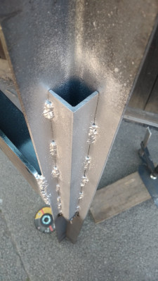

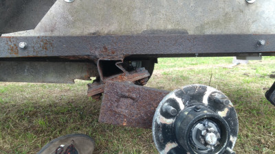

But the learning process went beyond "check the wheel nut torque and don't put so much dense stuff in it!"

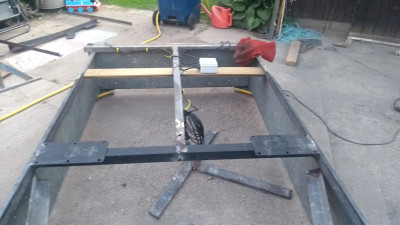

As this is what presented me on the missing wheel side of the trailer:
Box section not looking at all well
Worth noting also that the wheel studs were absolutely mangled beyond usability, so having decanted the soil to the smaller trailer in two loads (one to the tip and one back home again) I'd then to swap the hub complete (I had the well worn one I'd swapped at the farm, sloppy on the bearing but usable wheel studs) before I could limp the big trailer home.
30 minute trip to the tip turned into three hours saga! Fair to say my brother in law will likely think twice before offering to help me "just unload some soil at the tip" !!

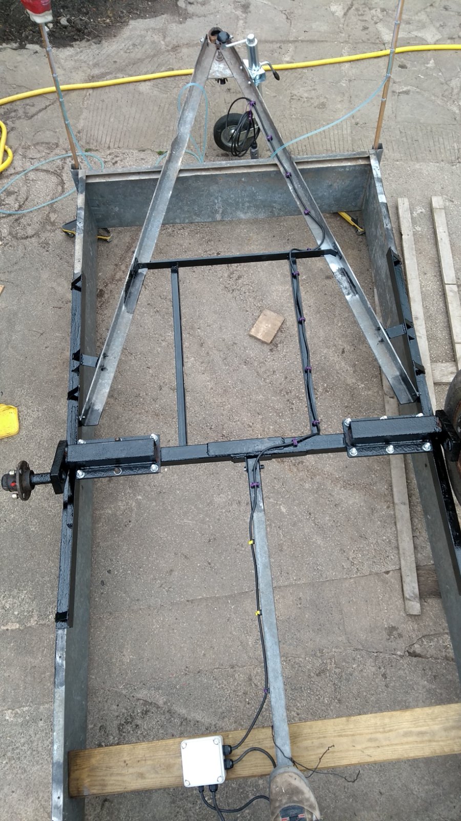

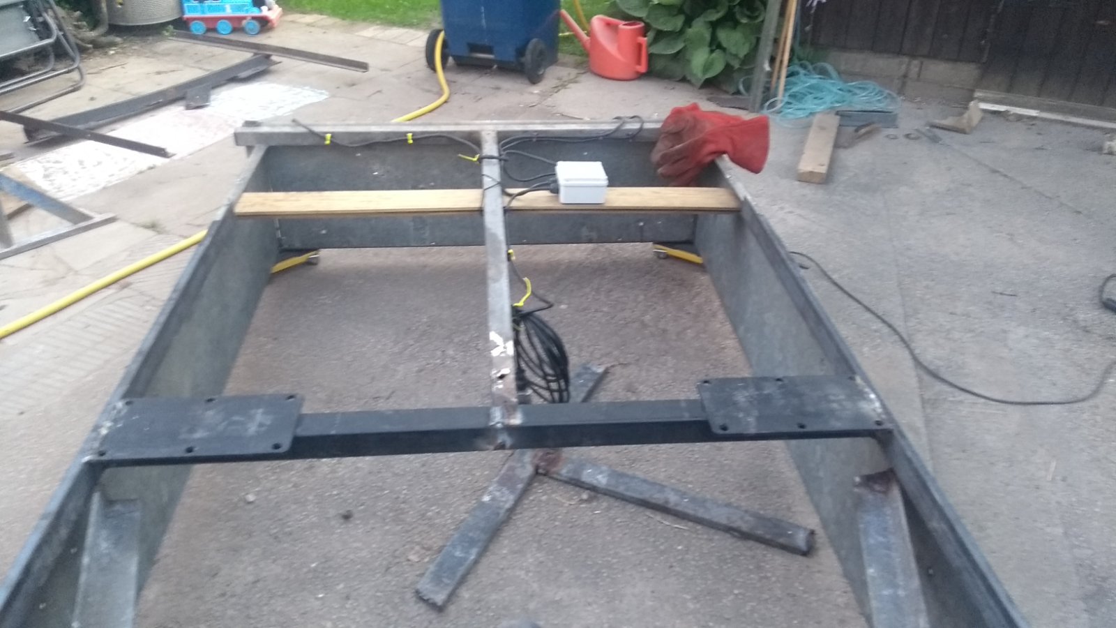

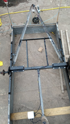

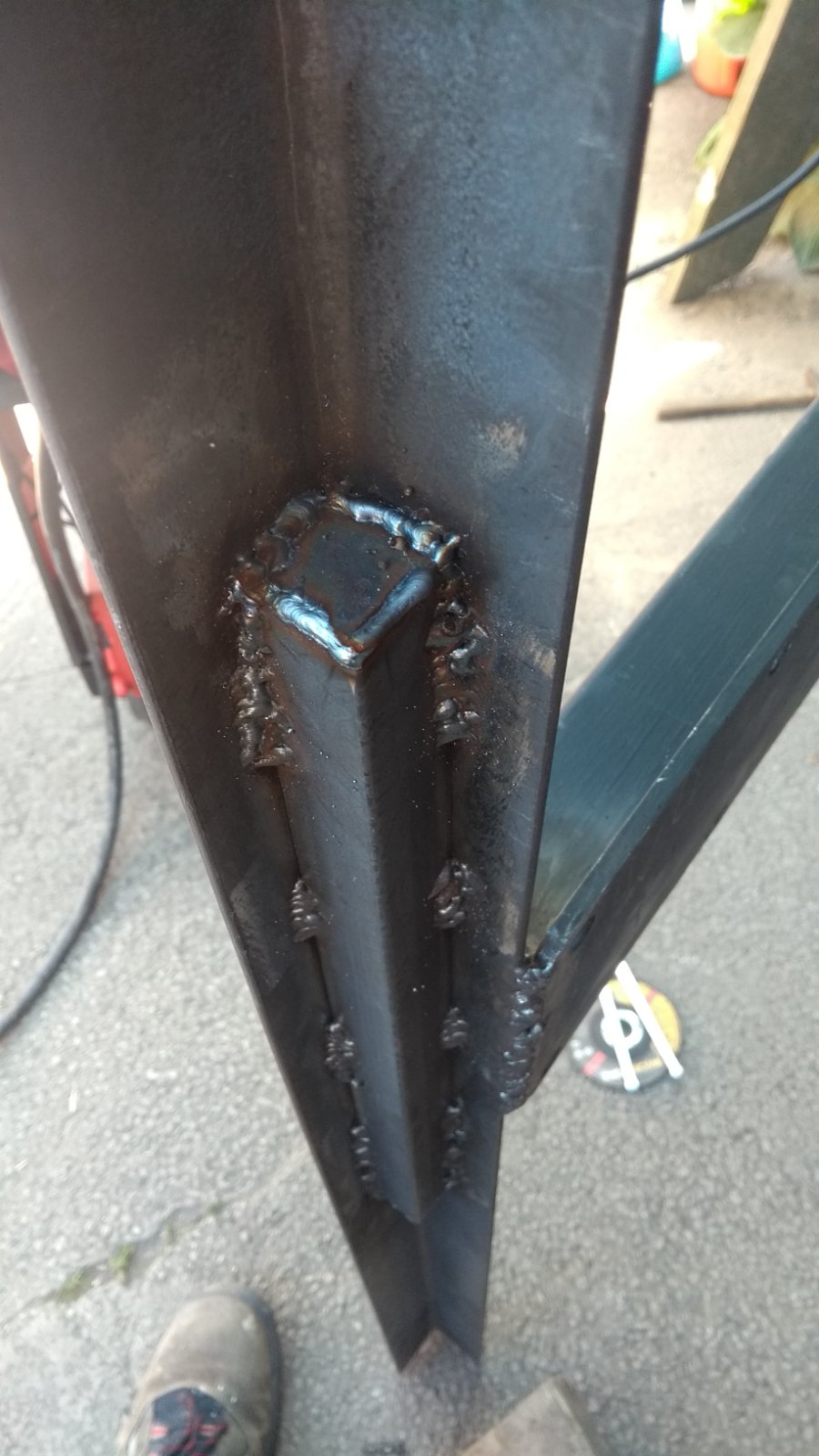

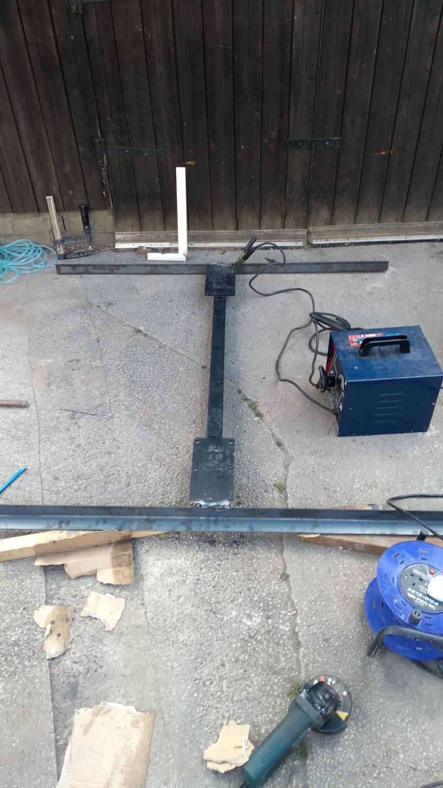

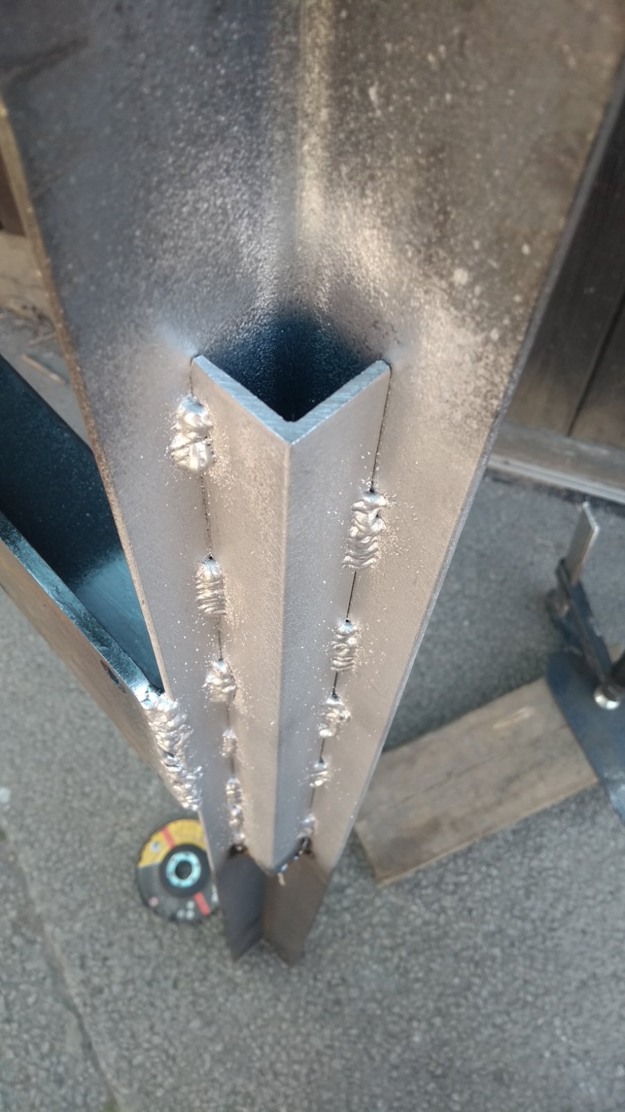

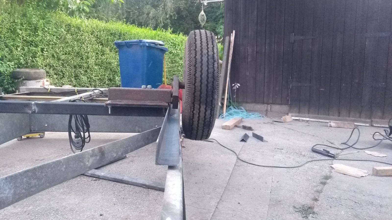

So a chassis rebuild was next task:
New beam axle from Towsure, various lengths of angle iron from an online supplier. Started with the stick welder but finished off with the MIG (patience exhausted with the stick welder!)
c16rkc
