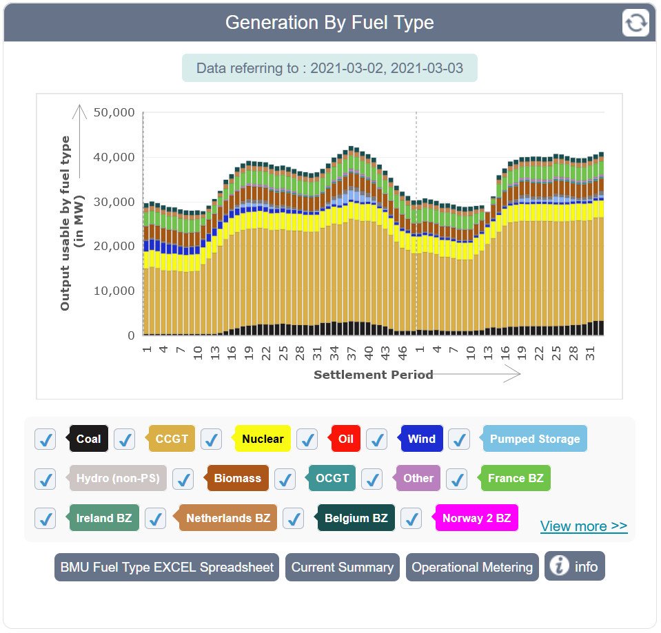

Reading round Thorter's post and the graph of todays national grid generation chart, I came across this.thorter wrote: 03 Mar 2021, 17:05
Here is the National Grid generation graph for today.

Here is the National Grid generation graph for today. How many electric cars might be charged from wind energy?
thorter wrote: 03 Mar 2021, 21:07 Unfortunately, there is much wishful thinking in official circles about renewable energy. Achieving so far about 30% renewable electricity is the easy bit. It is much more difficult to understand what happens next. Simply driving coal and gas generation out of business, as things are currently structured, appears very foolhardy, they are the means to keep the grid going. Storage is proposed for this, but how will it work?
For example, large battery storage for wind surpluses sounds simple. Our daily electricity use is about 600 or 700 gigawatt hours. Increase supplies for electric heating to replace gas, factor in electric vehicles (including commercials) and 2 terawatt hours daily generation looks about what we will need. If wind power becomes the dominant generation method, plan for 5 days storage (though 10 to 20 may be necessary), and thus plan for 10 terawatt hours (10 million megawatt hours).
Using the circa 100 megawatt hour Musk large scale battery units, that needs 100,000, and if they have a life of 10 years we need 10,000 per year in perpetuity. That is more than 25 a day to manufacture and install, just for the UK.
