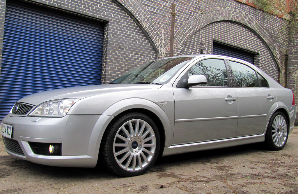

More Mon'Deo pictures alert!
I spent a bit of time today on the interior. It wasnt cleaned very well by the valeters, so out came the paint brush, interior cleaner, vinyl and rubber care and leather care, all Autoglym stuff. The plastics were properly cleaned, then vinyl and rubber care applied to all surfaces, allowed to dry, then buffed with a lint free cloth. Then all the nooks and crannies were dusted out with the vacuum, as was the rest of the car.
I applied Leather Care to the seats, again allowed to dry a bit, then buffed with a cloth.
Really pleased with the result, its come up like new.
The outside just got a wash. I've not yet had time to polish it. The front bumper corners have been repaired and repainted though.
The wheels need refurbishing, which will have to be done by someone else, as i cannot diamond cut the faces.
Note also the HID's which are very worthwhile.

Couldn`t take my eyes off that building too. I`m always interested in brick

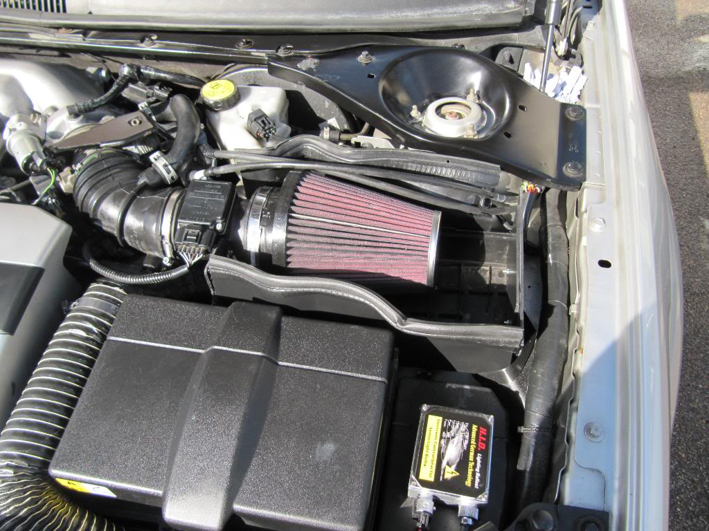

Small update!
Wheels refurbished now.
They were diamond cut, but looked so scruffy i had to do something, so they are bright silver with flake effect for now.
I've fitted a K&N 57i kit which has made a difference to torque, much better between the gears, and makes a rawsome noise too! Was 2nd hand off ebay and looked like new. £100 is expensive for just a filter and an adaptor pipe for the MAF so i paid half that.
I've fabricated a shroud from 3mm black plastic, cut and shaped to stop it sucking in hot air at low speeds. Beneath the filter is the original airbox lower half which has 2 cold air feeds, so once moving it gets plenty of cold air.
Even standard air boxes suffer from heat soak, but i went for this solution as i didnt want a filter in the bumper, which is a common mod done with a Pipercross VIS, because of the risk of sucking water up. The K&N has a nice bellmouth entry, helping smooth the airflow and making it less turbulent. It makes quite a difference over the original airbox.
It sounds and goes a bit like this -
1st and 2nd gear have a torque limiter, it really flies when in 3rd gear and pulls like a train from idle speed.
Overall i am very happy with it. I do miss the Activa, but made the right choice!

Wheels look spot on mate. It is a beast of a car ...very nice and perfect for your growing family too. Future classic?
