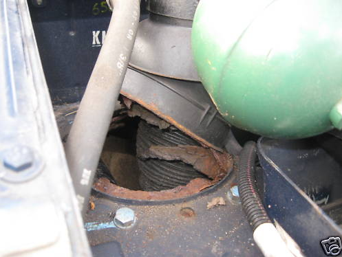

Mine need changing now too, just popped a screwdriver through.
So i'm bringing this thread back to life quickly just to get everyone else to check theirs!
I can't imagine what could happen if they pop through while on the motorway?!!?
I nearly ignored it since paul (citroenxm) mentioned it, but i did take a closer look and saw some rust peeling through the top, and I just couldn't ignore it!!
Check yours now before we have a possible fatality

Just discovered that I have this problem on the O/S of my Xantia 97 1.9 TD estate which has done 150K miles.
Spheres should've been done a while back but haven't got round to it.
A few weeks ago i hit a speed hump slightly too fast and I sudeenly started hearing this rubber sounding squeaking noise from the (what appeared to be) coming from behind the dash/bulkhead area drivers side area.
I noticed severe corrosion on the Strut top plate. It has started to force it's way through into the engine bay. The front half has completely corroded (can see the top of the gaiter below!), so essentially it is only the rear half that is preventing a 'spearing' moment occuring. The rubber is perished but still intact and attached to the plate.
I will not use the car now till this issue is sorted (luckily I have a motorcycle too!).

If you do goto aScrap yard, try and get some from a 1998 S reg onwards car, and it must be either an LX or SX spec car for the smaller feed pipes..
I say this as theres a 80 percent BETTER chance of getting VERY good tops from a later car.. the tops are longer lasting.
I put some 1998 T reg tops and struts onto my 1994 L reg SX TD, these tops had done 250k and had no sign of any serious rust what so ever!
You may well need the strut to go with them! So get the top and strut as a complete unit!
