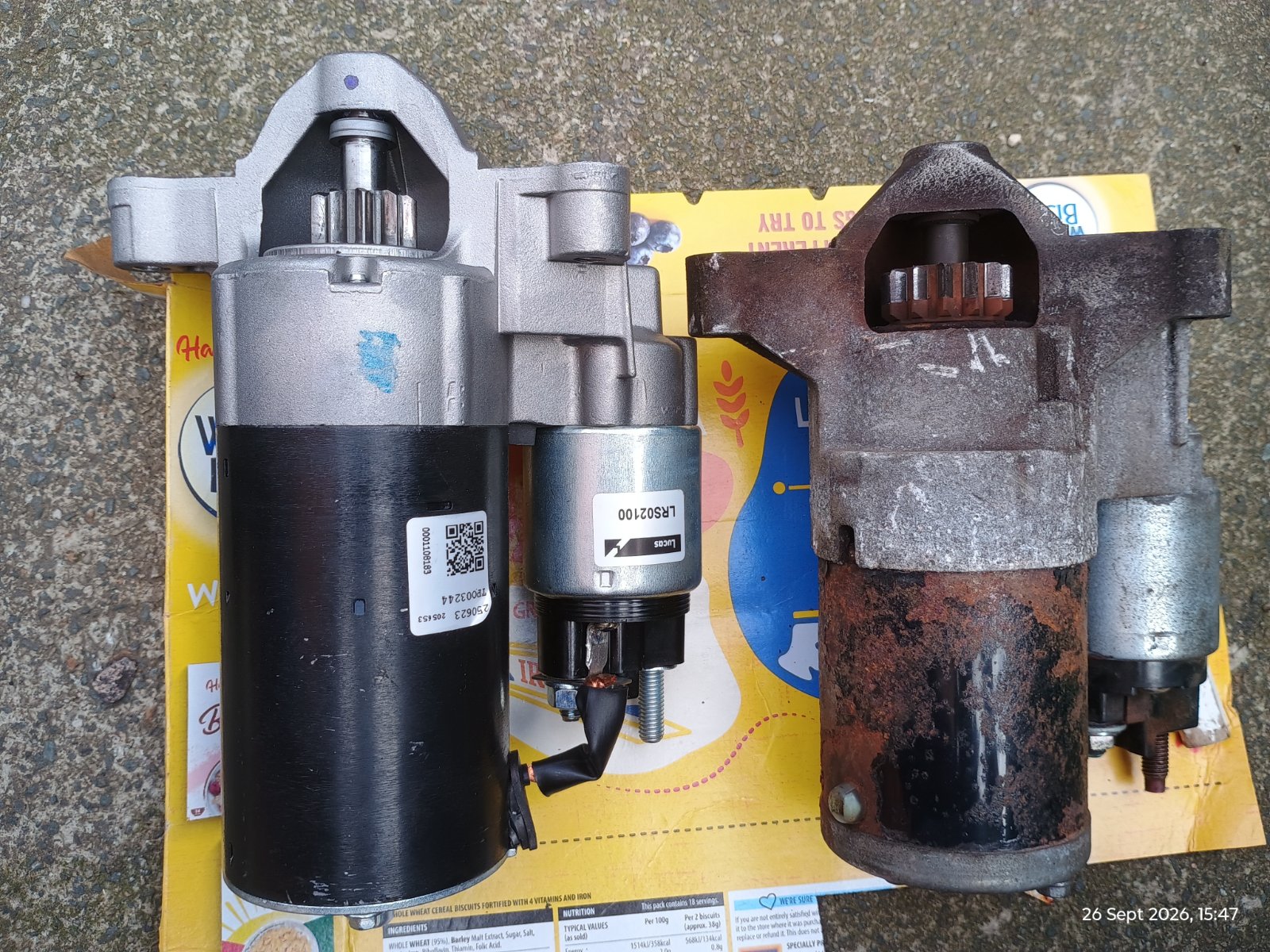

Starter swapped today, replacement from Euro Car Parts is compatible, thankfully!
New unit just fractionally less corroded

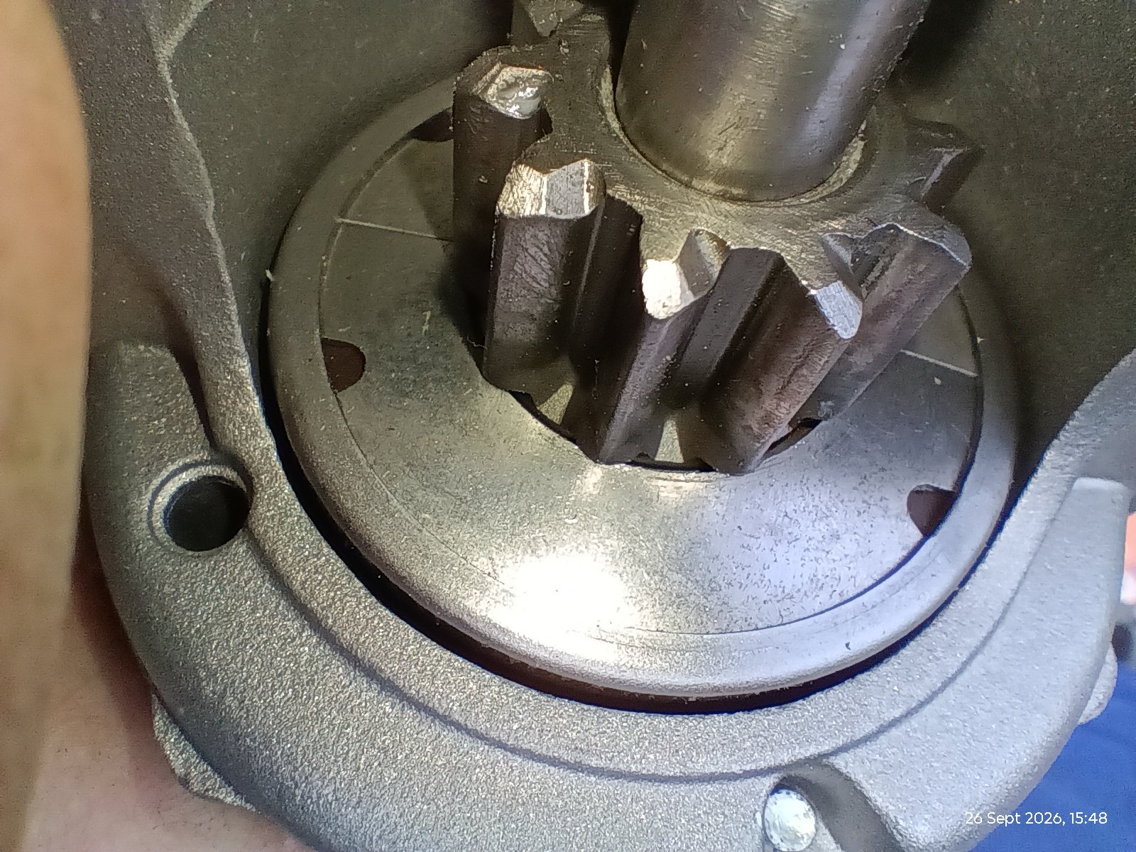

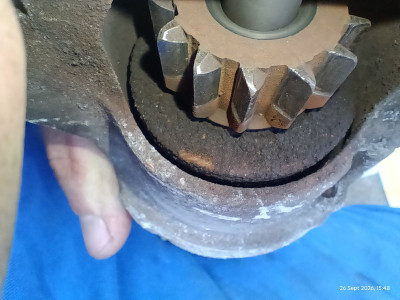

Looking closely at the old unit, I was surprised quite how obviously worn it's teeth were! Tip of each a sharp edge:
Worn
Worn
In contrast to the nice radiused teeth of its replacement:
New
New
New unit it 10 teeth, old unit 13 teeth. A quick cardboard template confirming the shaft centre line must be in a different position as the teeth tips are in the same position (measured relative to the two mounting bolt positions either side).

Now you can see how the start up sounds lazy and fairly slow when I changed the one in my old zx estate years ago the difference was noticeable

Huskyxantia wrote: 26 Sep 2026, 20:46 Now you can see how the start up sounds lazy and fairly slow when I changed the one in my old zx estate years ago the difference was noticeable
Speed wise it seems pretty similar, but its loads quieter!
Am guessing those worn teeth may be behind the previous noise.

Yes, those teeth will make it Matt!
Surprised at the amount of wear on them...
