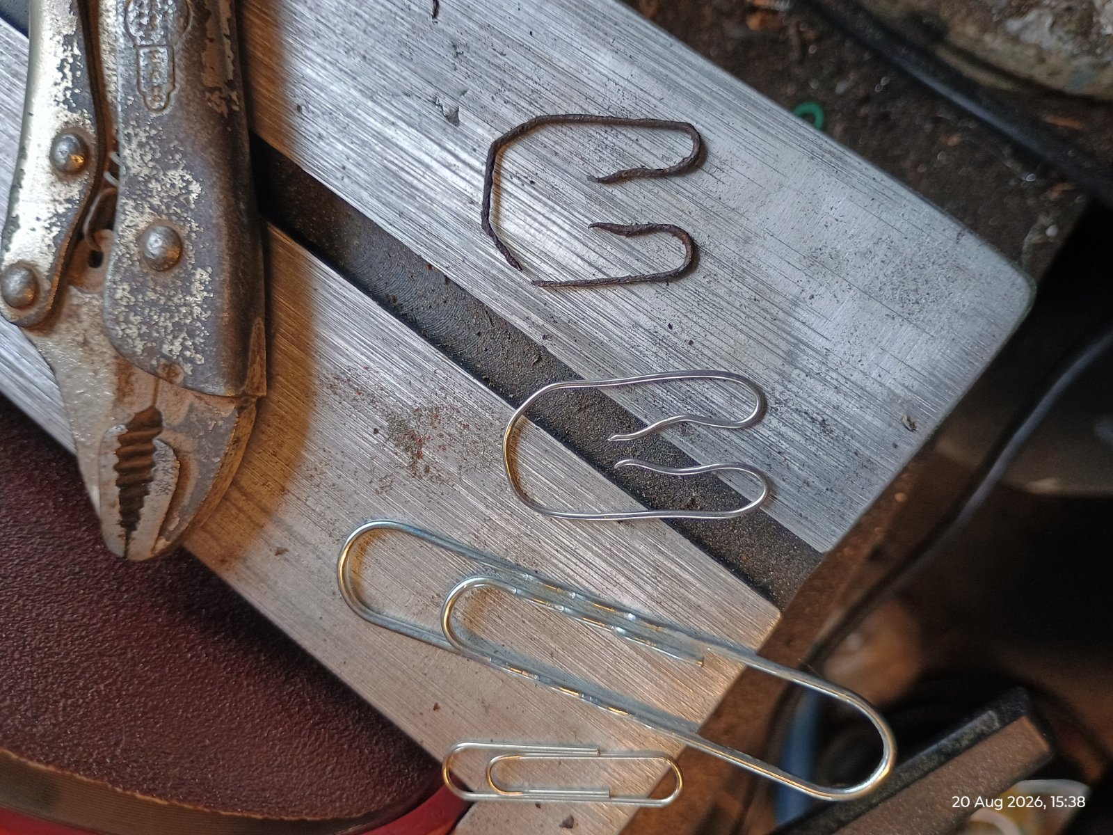

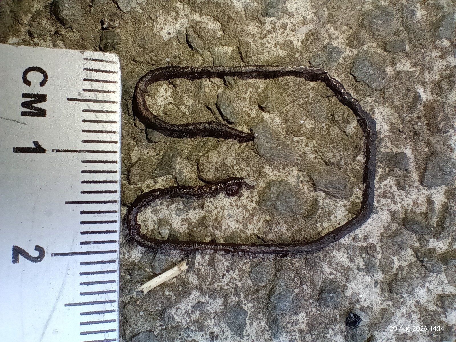

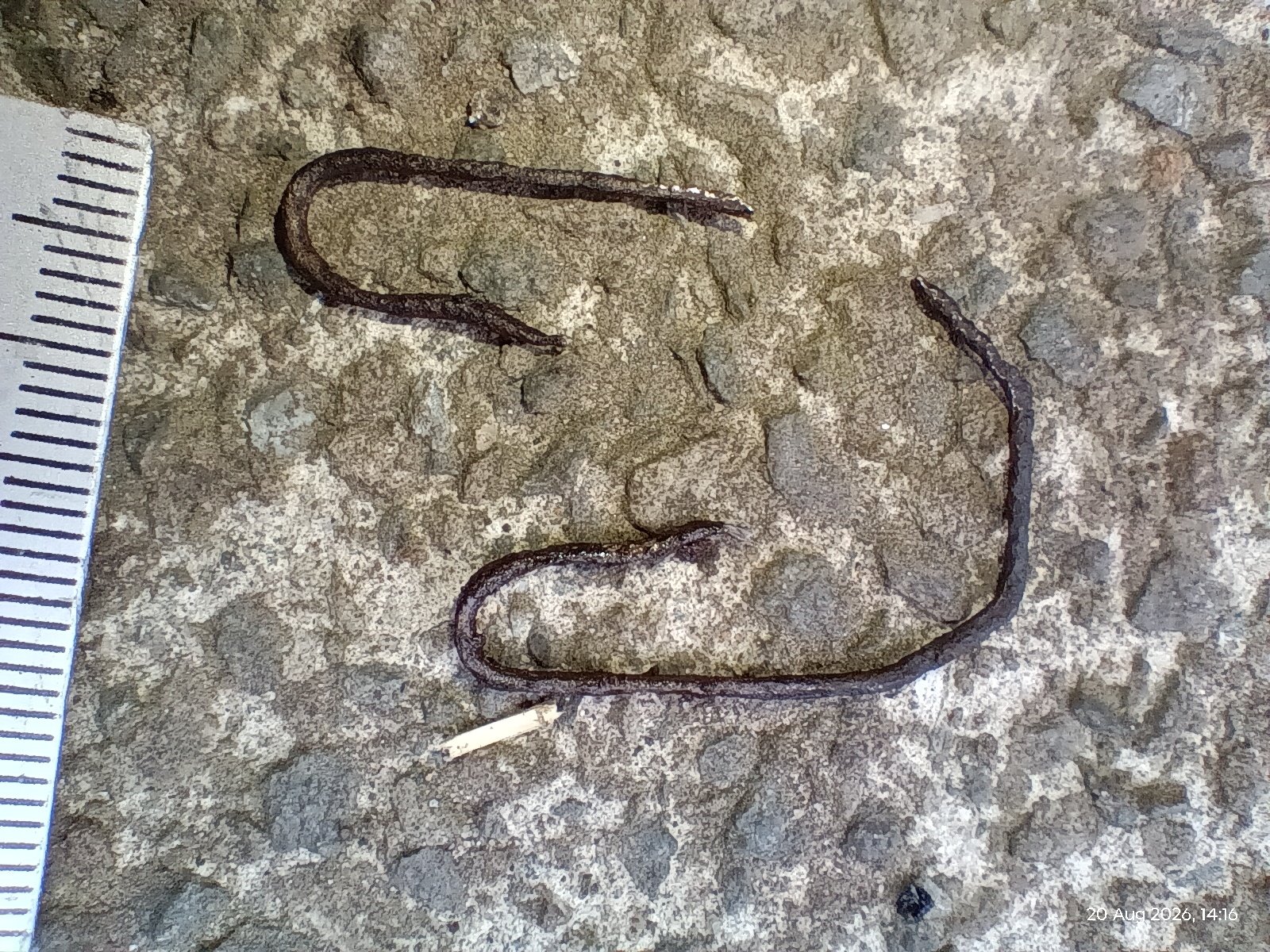

Short suming up:
The fabricated clips do work, most successful is that made from the big paper clip. That wire is 1.5mm diameter, compared to 1.2mm measured on the rusty remnant. I thought this was near enough but it popped off initially when out under pedal pressure. Slimmed down slightly with belt sander, the popping off stopped.
However, watching closely as the pedal is depressed, you can see the assembly shifting somewhat. (It did even more so with the MK1 DIY clip made of thinner gauge wire!)
This puts me below 100% faith in my DIY clips. I've tried to find them to buy but have been defeated thus far. The type as per Mick linked earlier - which appears very similar to other wire clips elsewhere in the clutch system - will not engage effectively with the pipe on both sides at once (it will just about grab one side if positioned "just right". I tried the old slave cylinder's clip of this type - no good, sadly.

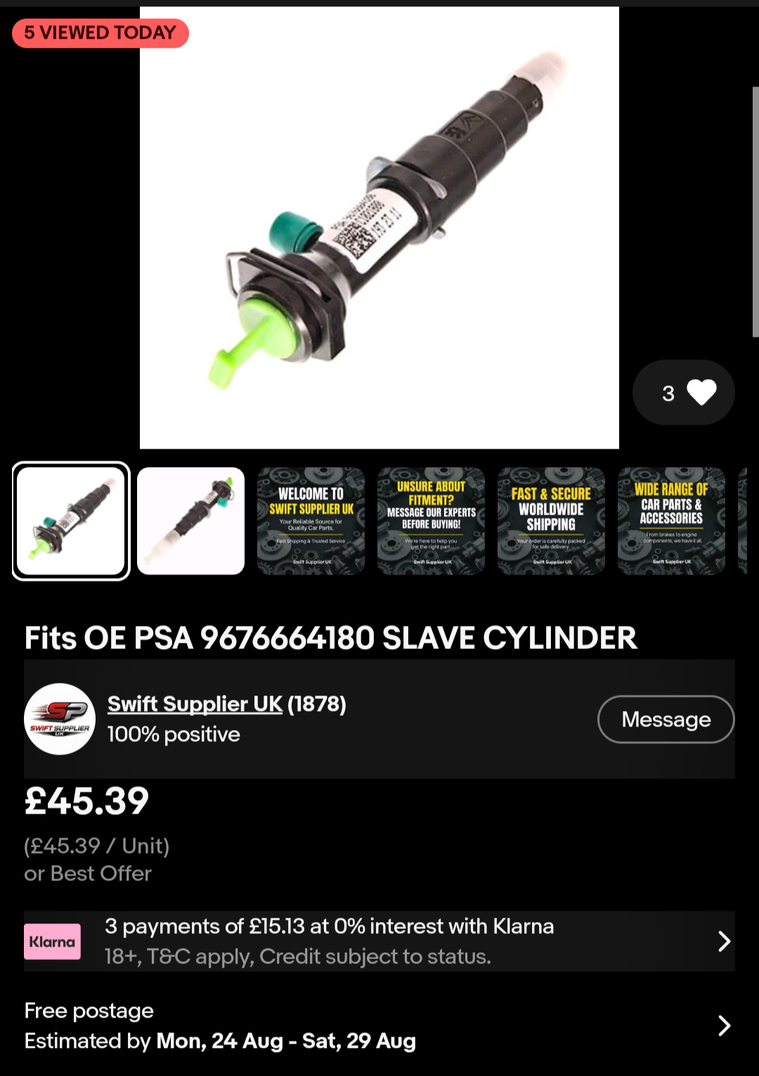

This is what I need:
"CILINDRO RICEVENTE RACCORDO SPURGO FRIZIONE CITROEN C4 PEUGEOT 308 9676664180"
Or
"PSA 9676664180 Kupplungsnehmerzylinder NOS NEU genuine xn32656"
Or
https://ebay.io/m/bzhYv2
Autodoc lists it,
https://m.autodoc.co.uk/citroen-peugeot/27029793
But doesn't think it'll fit the 308!?

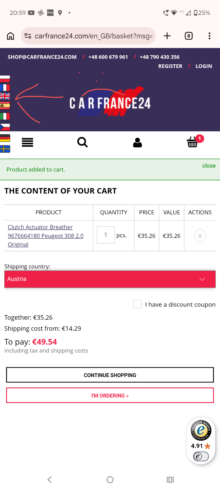

Car France 24??
https://carfrance24.com/en_GB/p/Clutch- ... inal/16941
New site to me
Ah forget them, a union jack symbol means "site in English" not "we deliver to the UK"
New site to me

Thanks both, think I'm going to bite the bullet and stump up £45 on the assembly it sits in. I realise the clip I'm basing a new one off maybe less than the full picture (i.e. there's more to it than what's in front of me) that'd mean the "flex" I'm seeing us a result of an incomplete (new DIY made) clip rather than my attempt being a poor imitation.
If I could find a decent picture of the damn thing (in as new condition) I'd certainly have another go at making one, but I've tried and failed to find a decent image.

Bought
