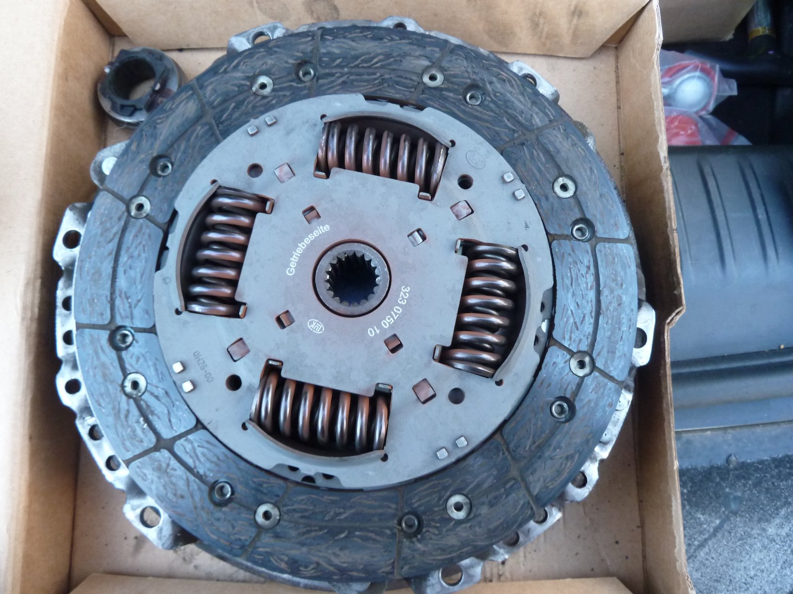

Still waiting for the picasso hoping my pal hasnt been called out to do any recoverys fingers crossed this evening picasso should be back.
Its had as follows
Flywheel single mass ( solid type ) 90 version 91&92 are solid. OEM psa part
New 3 piece clutch kit , sachs brand
Fork oem part
Plus wishbones , drop links, tierods inner n outter, lower ball joints .
Im just pleased the car is inside & the weather wont hinder the works.
Roll on when its back home.
Its had as follows
Fork oem part

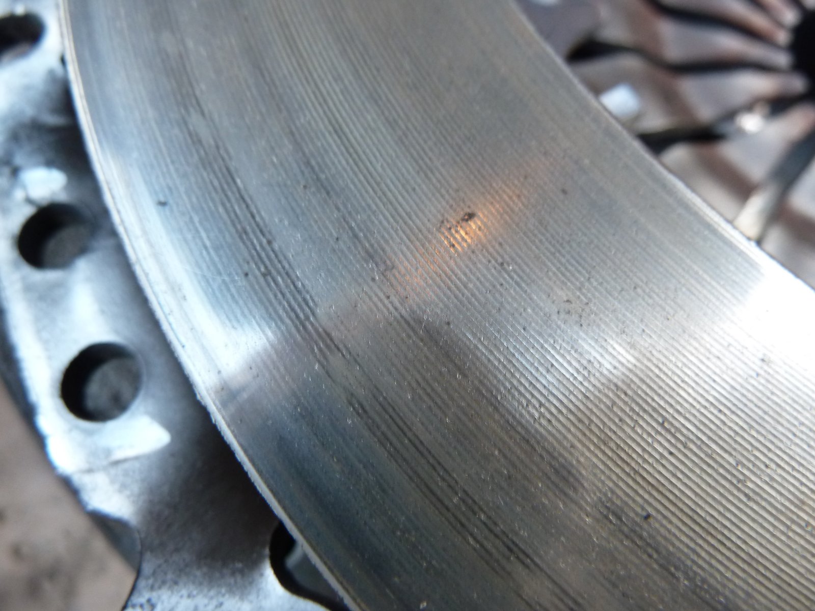

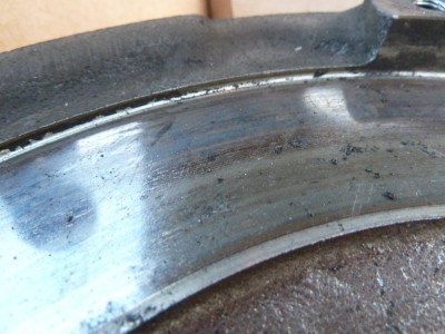

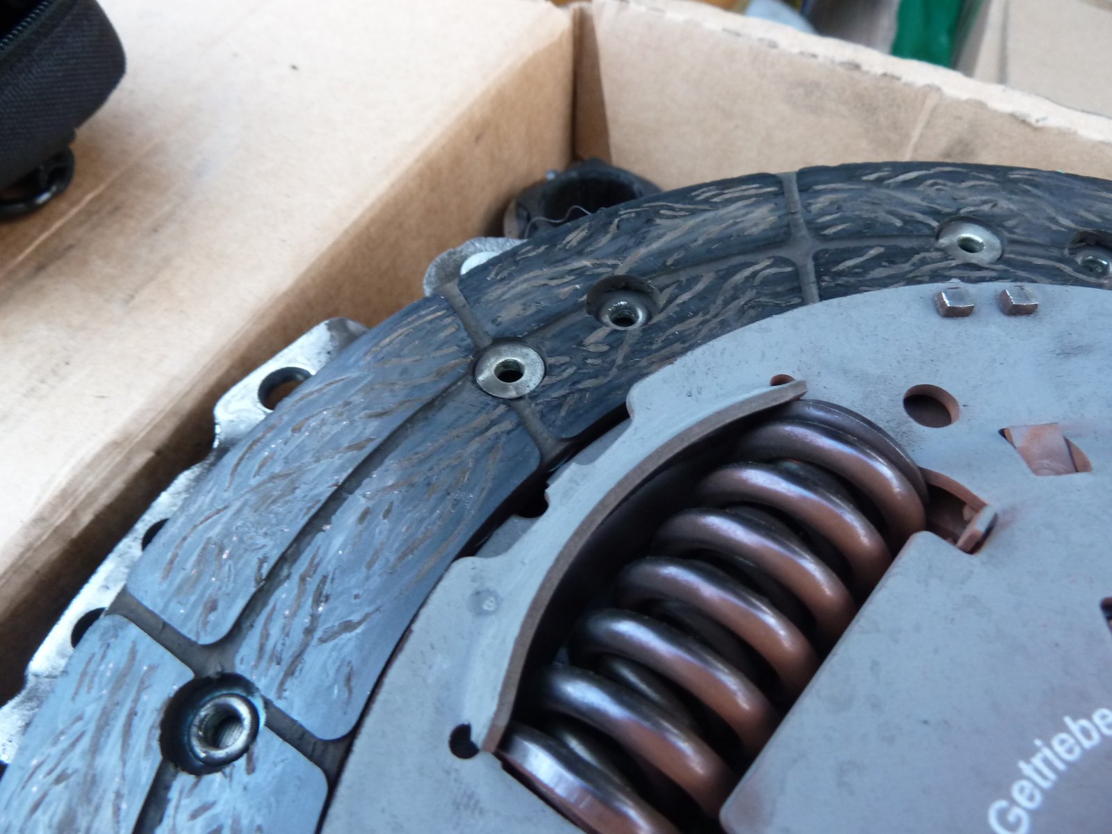

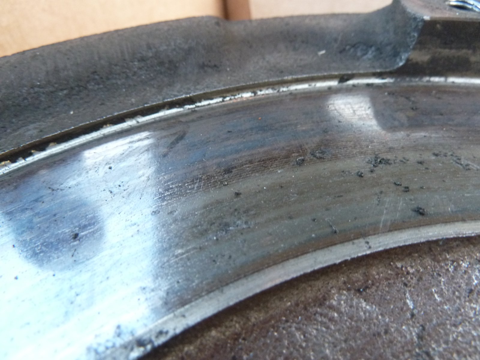

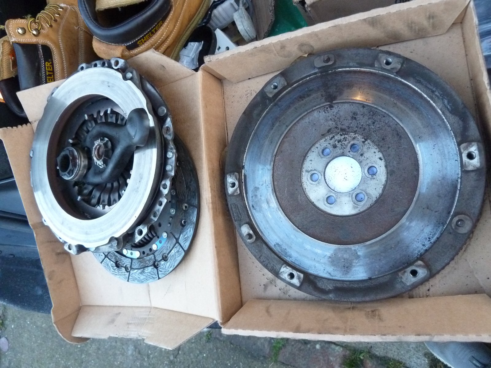

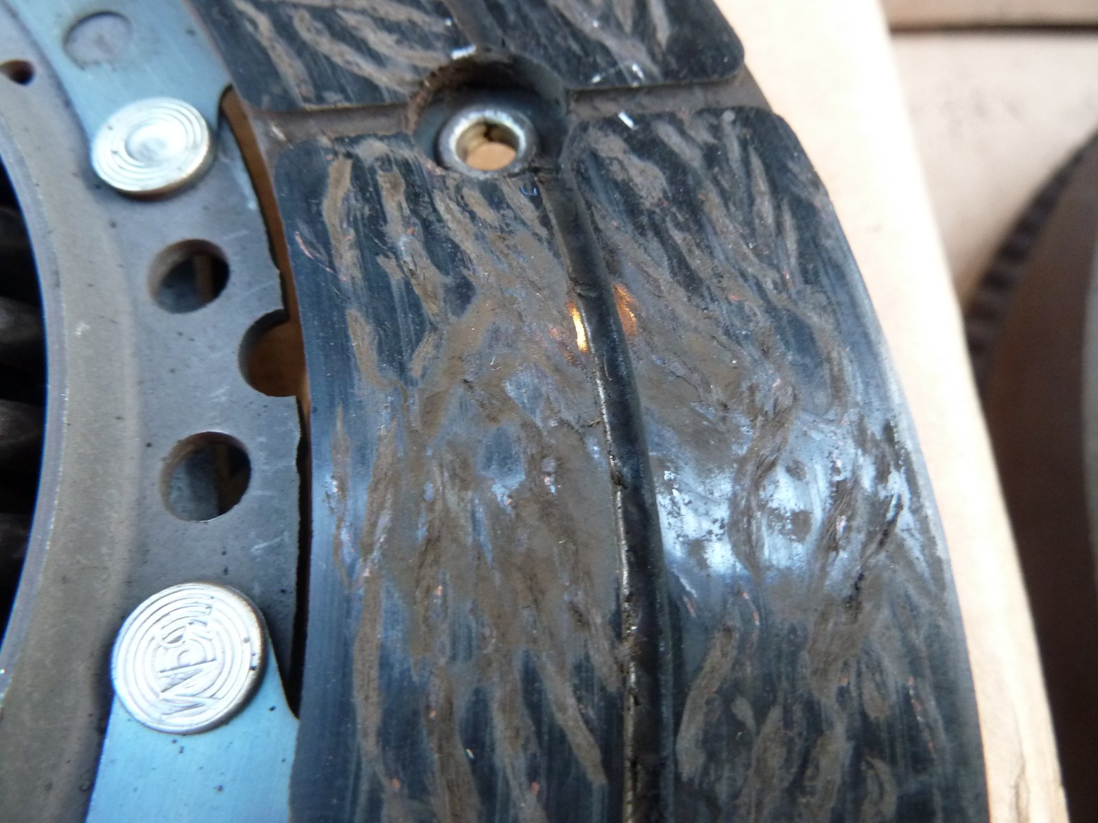

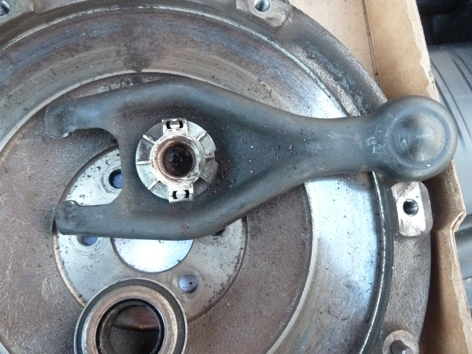

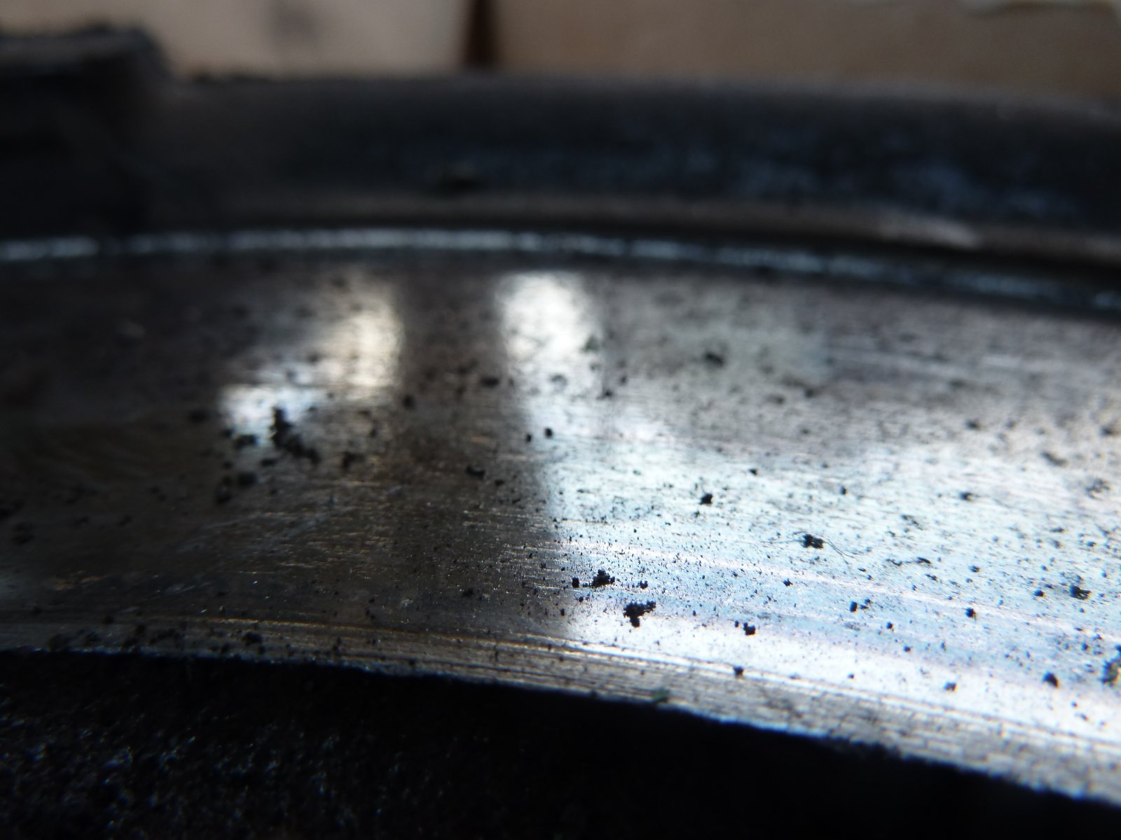

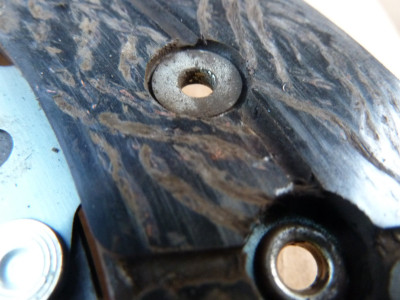

Meet my old flywheel.
Former keeper must of rode the clutch . The last picture is the clutch plate cover which thank god looks still like new.

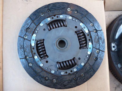

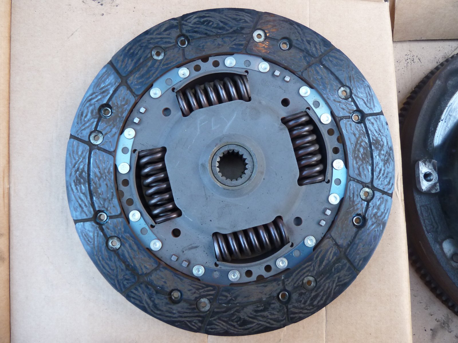

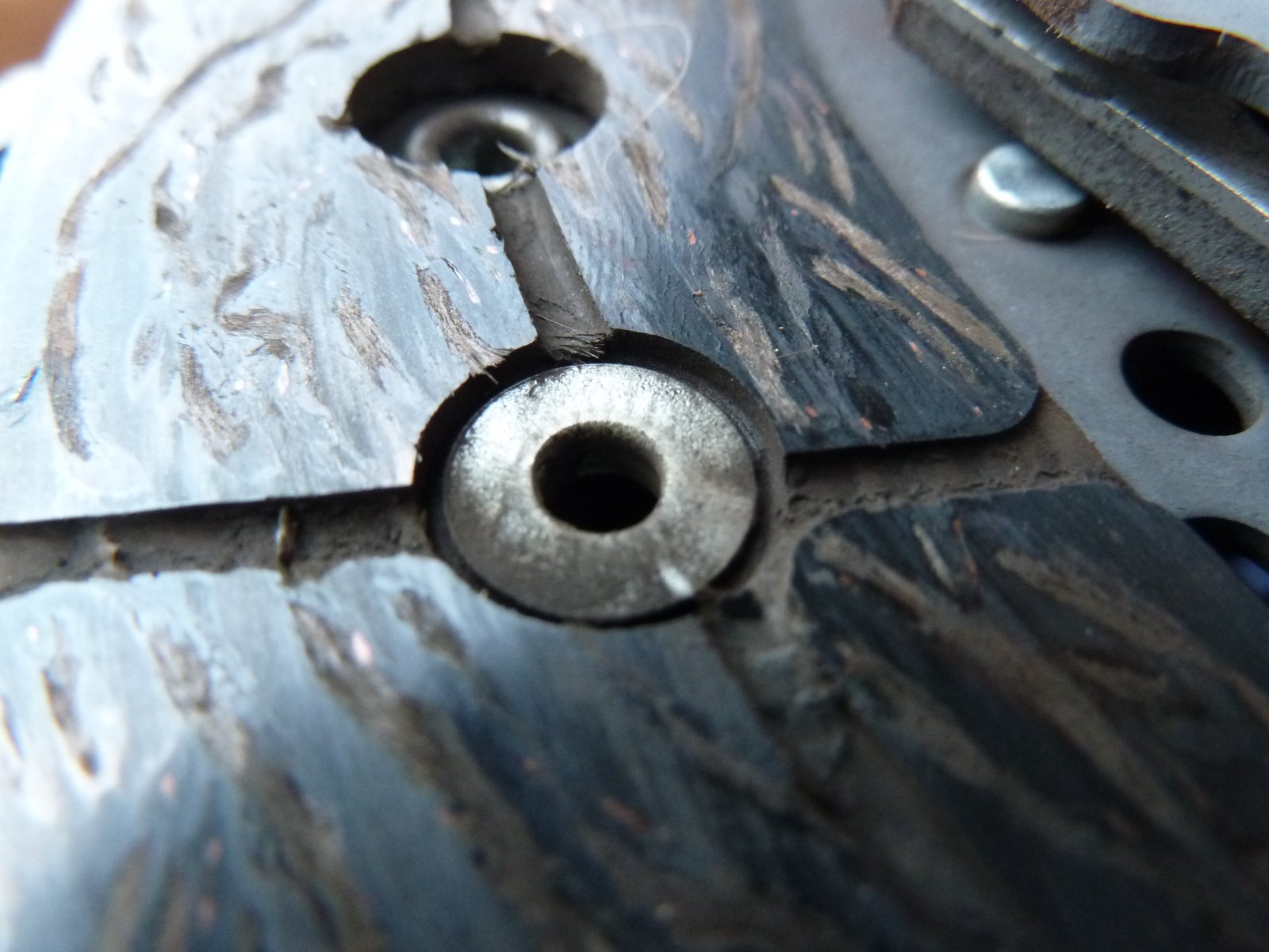

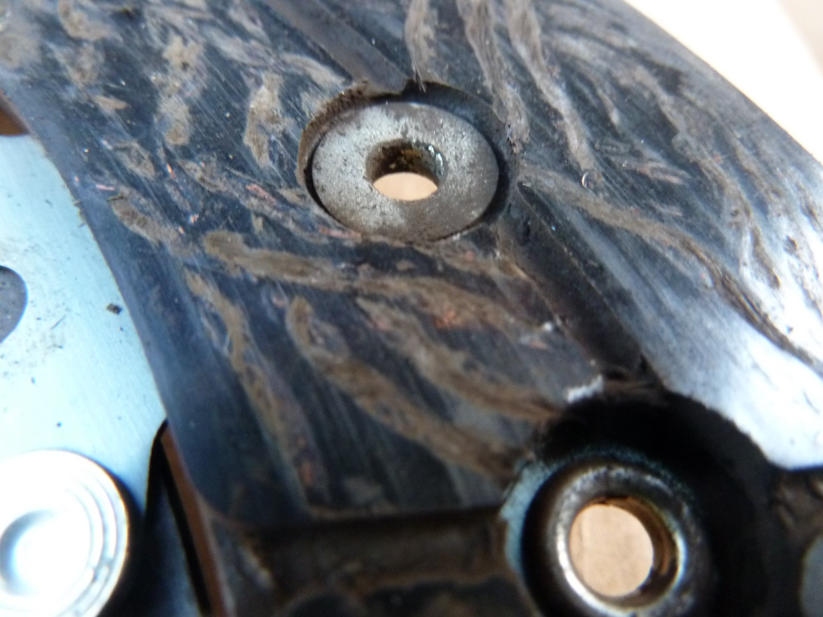

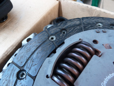

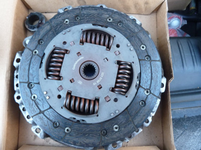

Heres the clutch plate which was fitted March this yr 2024. Can see some impact marks on it , but should be ok for a spare
Husky.

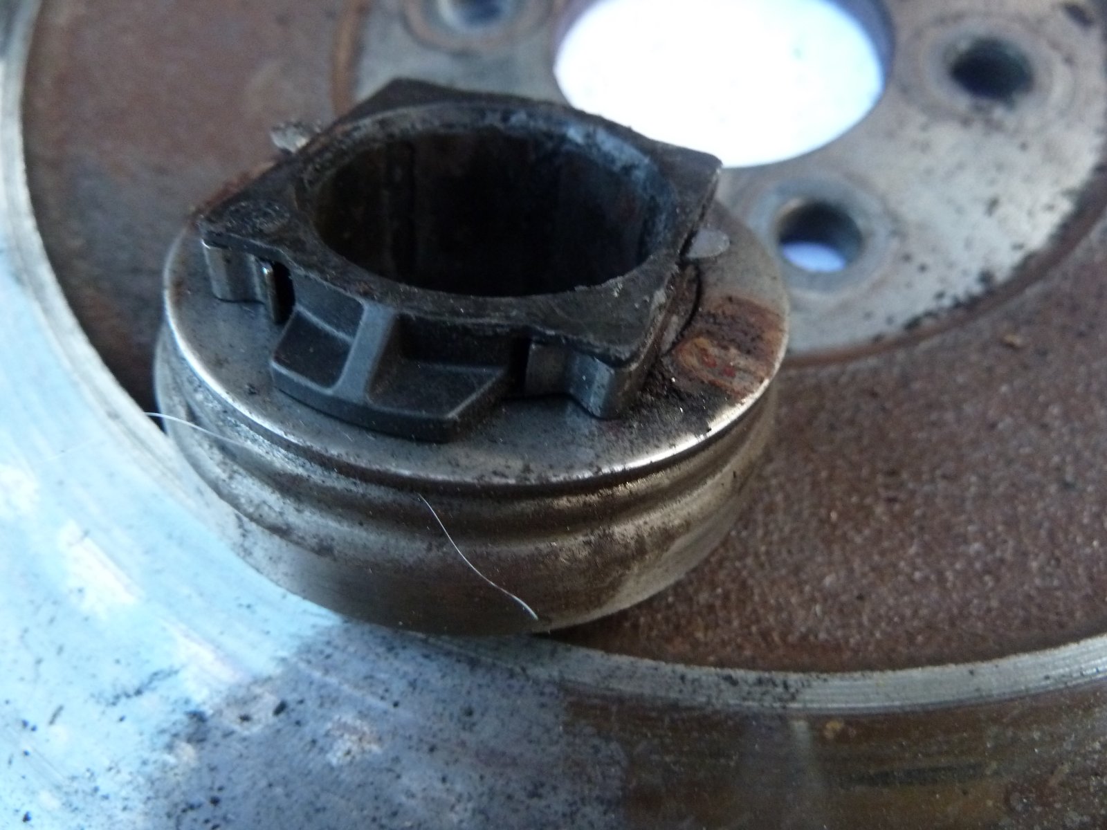

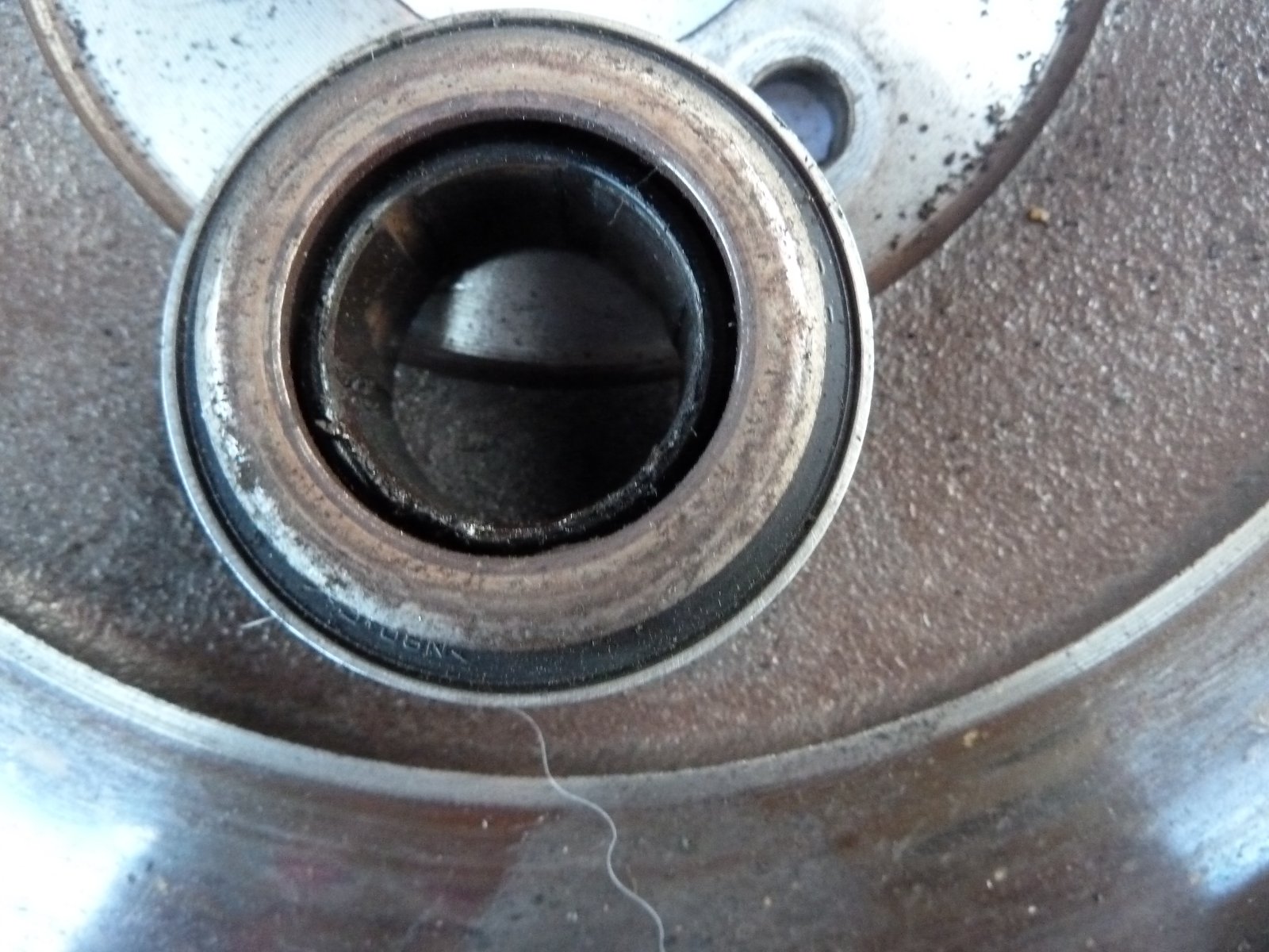

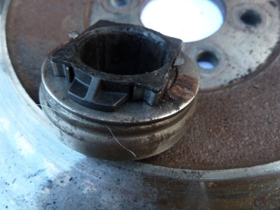

Thrust bearing still ok .
So back in March this year the clutch was slipping , and a judder so it got replaced i didnt want to do the flywheel but had no luck getting one.
2 local factors told me at least 8weeks , so i didnt have the time to wait as this car was needed so bit the bullet & got the job done still hoping the flywheel on the car was good , well it lasted it 15th november so maybe i was lucky but the wallet wasnt.
My pal called me to his workshop 7.30 last night to help bleed the system as the master cylinder went , this took 30 mins , then that was it .
It drives good , no bad judder no noise all ok. So im left now with the old parts as a keep sake lol.
