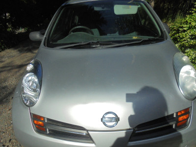

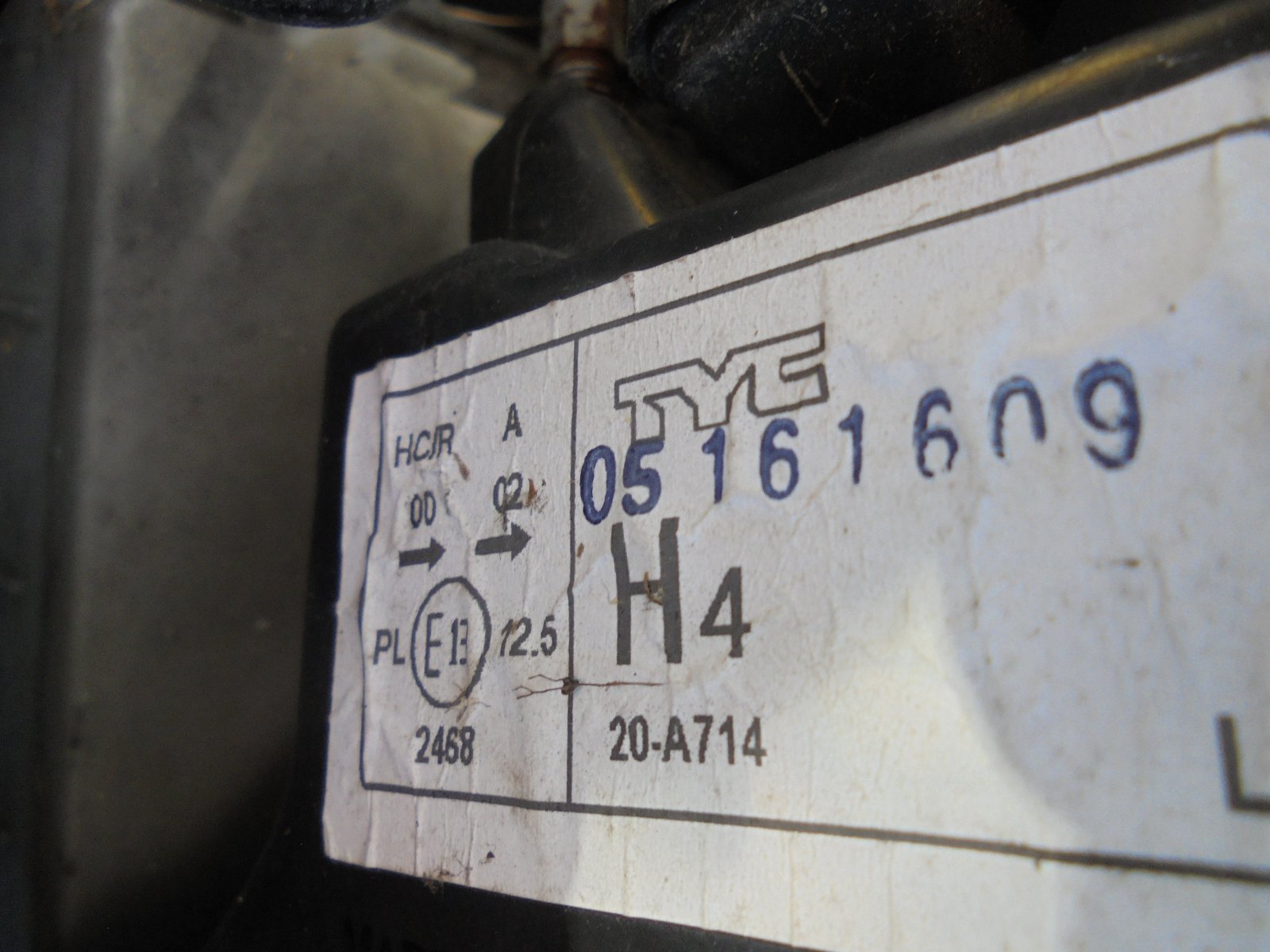

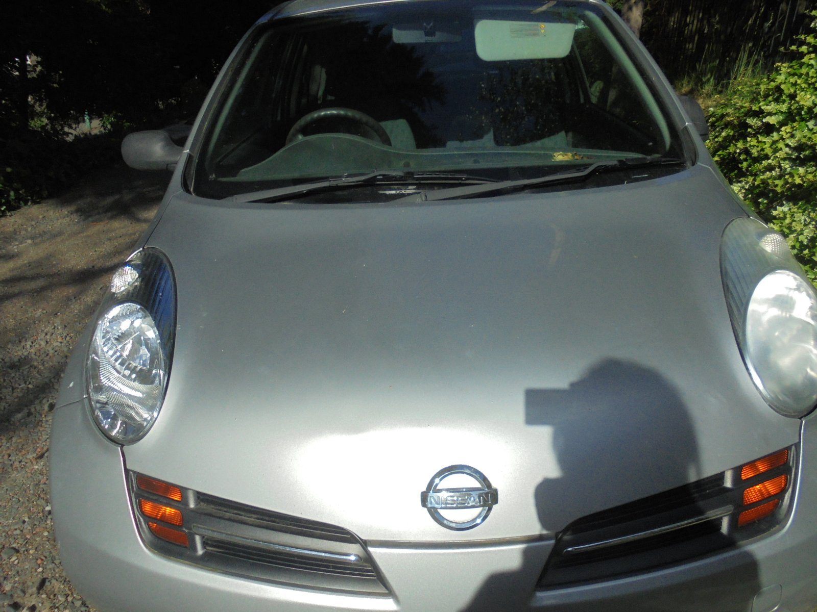

I have edited in a bit to my previous post after surveying the scene this morning in the sunlight...
Headlights for the Micra are pricier than they were for the Clio, and the usual sources of cheap "they'll do" parts fail to have what they describe as a Left Hand one in stock. Depends which way you are looking at it of course, I like Nearside and Offside, but then again those terms would be different for LH drive cars as opposed to RH drive cars.
The duffer one of the 2 headlights currently on the car is branded as TYC....same brand offered by ECP/Carparts4less. The offside one looks as good as new.

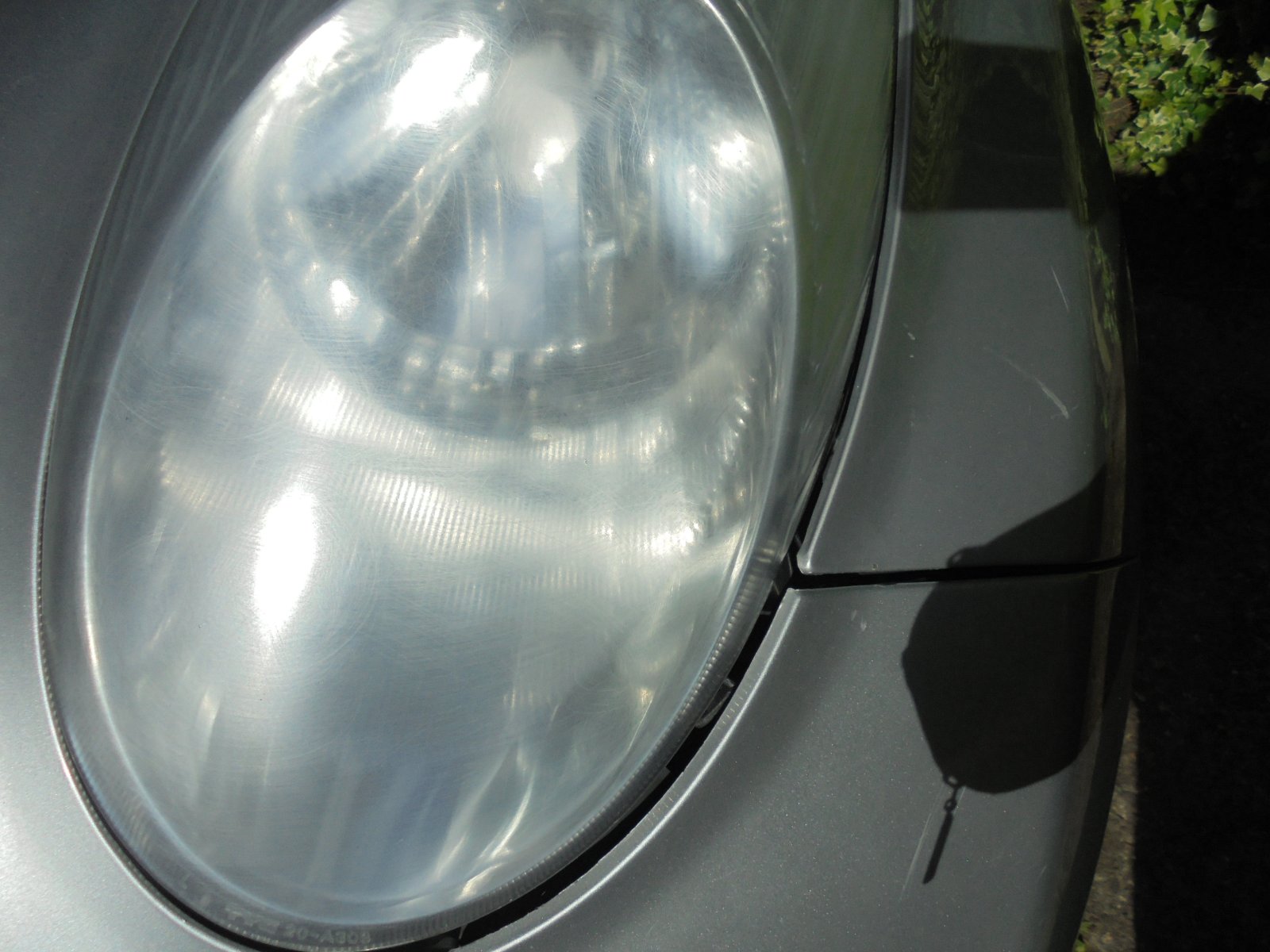

Bit of a schoolboy error. Brillo pads totally not recommended!NewcastleFalcon wrote: 08 Jul 2022, 17:20
I do have, one very clear headlight on the offside and a clear but a distinctly worse shade of clear on the nearside. Gave that a bit of a brillopadding, clear enough (edit yes it was when it was recently rinsed and wet, in the clear light of day the brillopadding was probably the worst thing I could have done, too much bargain basement thinking there, lenses now worse than they were before as may well have been predicted with some serious polishing off of the too deep scratches left by the too abrasive pad. , but it still shown up by the other one.

I tried for ages with toothpaste, autosol, Jif and anything else I could find around the house, none of it effective and on closer examination found that there was a sort of algal growth on the inside of the lenses (C5).
Bought new/second hand from eBay at twenty five quid a throw and all was good.
800 grit wetordry used wet seems to be the answer though.

Thanks Steve, when I had the lights debate for the Clio earlier in the thread you posted up a series of vids which I have revisited (link). They go clear when the deeper scratches are polished out, I think there is a decent chance of revival and the finer grade wet and dry might help. I would fail them just looking at the difference one brand new and one not yellowed but dull and opaqued with the brillo pad scratches.myglaren wrote: 09 Jul 2022, 11:23 I tried for ages with toothpaste, autosol, Jif and anything else I could find around the house, none of it effective and on closer examination found that there was a sort of algal growth on the inside of the lenses (C5).
- Posts: 21191
- x 8126
Re: Bargain Basement Motoring
I've had success every time starting with 120/240 W&D then going through 400, 800, 1200, 1500, 2000, 3000 to leave a final polish with windolene and microfibre cloth to finish the job. The secret is don't rush it, use plenty of water and work each grade until you have the same finish right across the lens. Works for me!!

Thanks Mick, good to know first hand of a method that worksmickthemaverick wrote: 09 Jul 2022, 11:57 I've had success every time starting with 120/240 W&D then going through 400, 800, 1200, 1500, 2000, 3000 to leave a final polish with windolene and microfibre cloth to finish the job. The secret is don't rush it, use plenty of water and work each grade until you have the same finish right across the lens. Works for me!!![]()
Looks like you are well stocked on the wet and dry front Mick! By the time I've bought all of those grades from Halfords, I would be nearly up to the price of a new headlight
Never really been shopping for W&D before, I imagine the shops selling "loose" single sheets are few and far between, so you are into multi packs packs of 4 or more with some assortment 4's offering 240/400/800/1200 a la Halfords.
