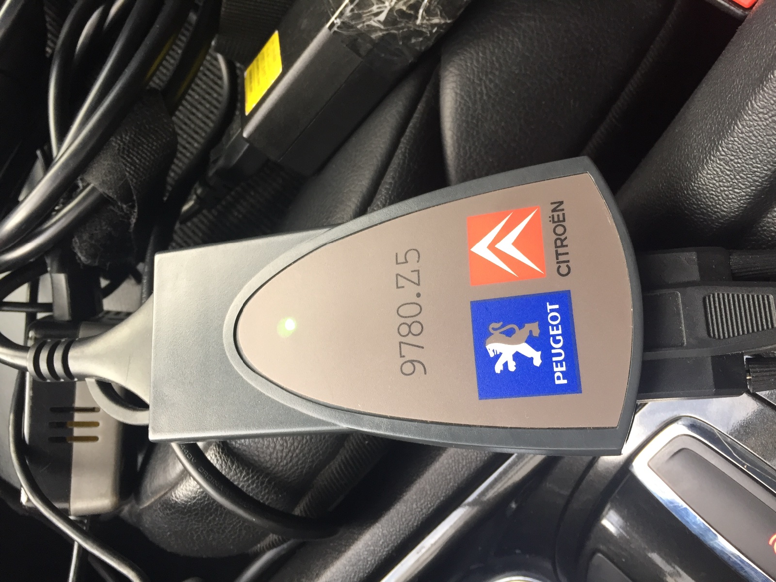

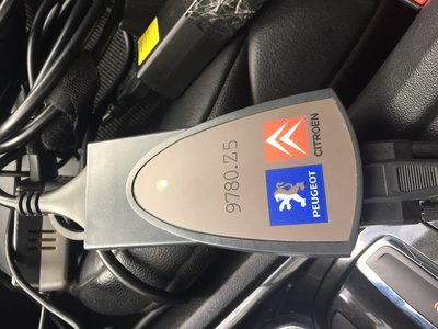

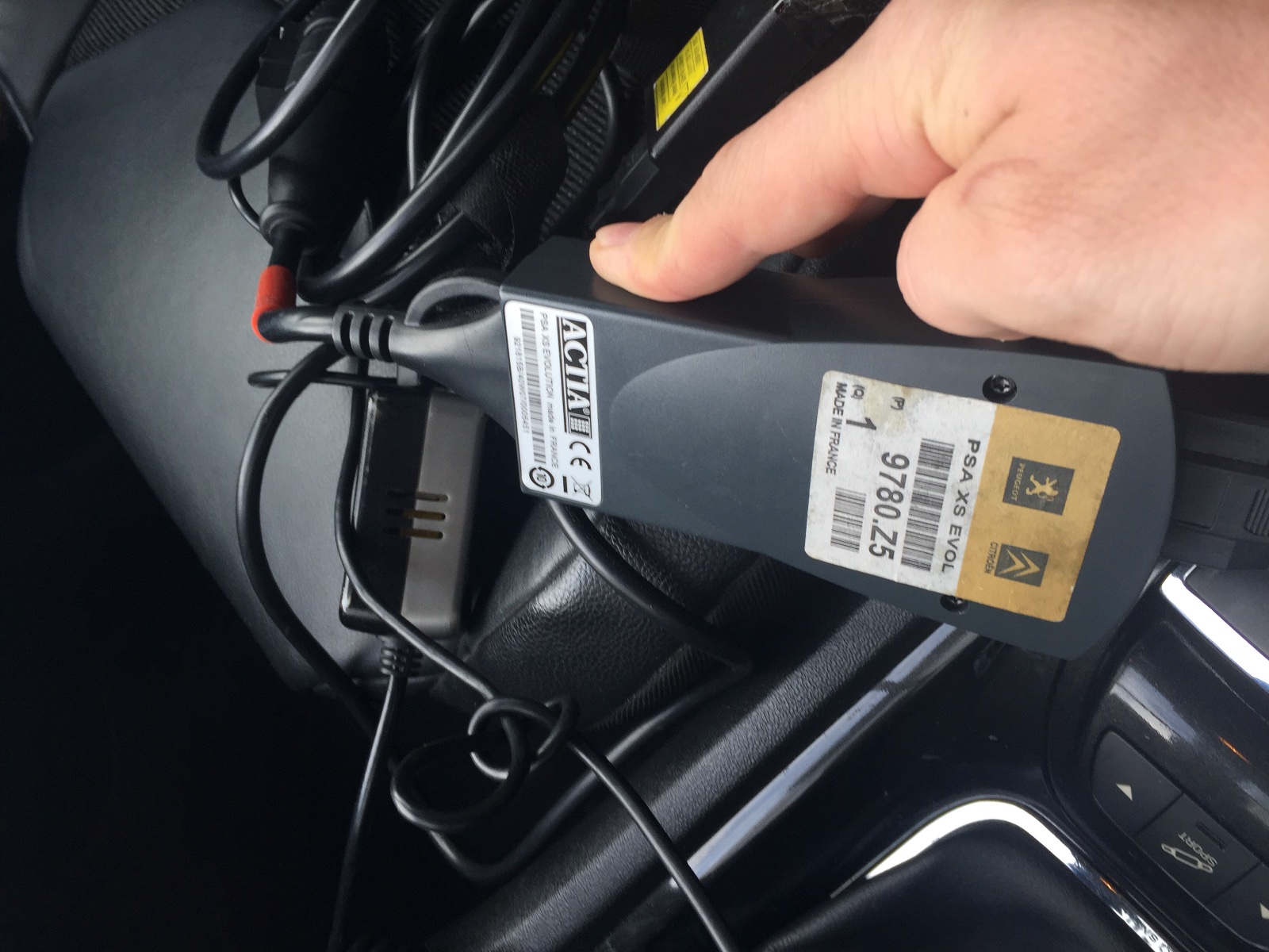

I assume my cable is too old. For example when I was using Lexia, and clicking on the vehicle type, I always heard a click like a relay on the cable housing. But this is not happening with Diagbox. What do you think?
This is my cable.
This is my cable.

That does look like an older VCI to me Vlad.
Do you have a friend with a newer unit?

There is a bit of software available to check the revision, but I think from the design it looks older to me. Maybe time to update it if you will be uaing any other PSA cars as the newer models will need newer Diagbox versions to work.
