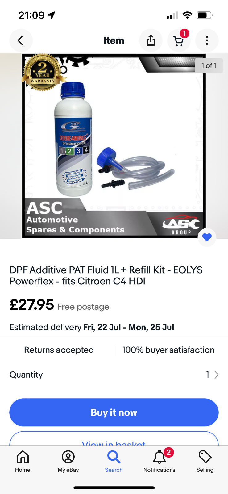

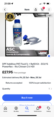

Diagbox is in the post to me. I always used to use my Delphi DS150E on all my other cars.
It reads the additive ecu on the C4 but not sure if it can write to it.
So I can Google powerflex top up kit and. I should be good to go. ?

Hi. Thanks for confirming the right fluid. How much will I need to fill it? And could I use the stuff mentioned a bit further up on this page? (viewtopic.php?p=723770#p723770). Finally, I think the code has already been cleared and the counter reset as the light isn't coming up anymore and the Launch device that was connected after clearing didn't have a code related to the Additive Reservoir; will this make it harder to prime the pump? Thanks so much for all your help.

1) Yes that is the correct type, as long as it says Powerflex. As to how much you will need I can't sat, but it is probably better to purchase 1lt bottles as once opened this stuff does no keep as it reacts in the air.
