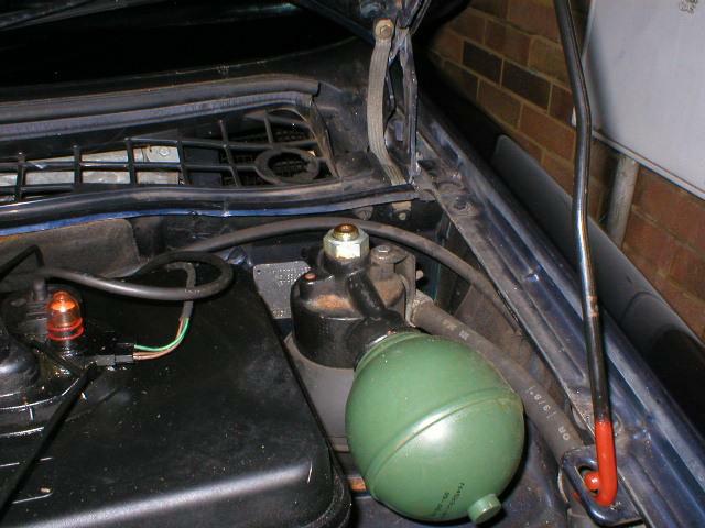

Good work Mike :D Alweays a good idea to replace those little 3.5mm seals with new ones in any case. They're available from GSF and cost pennies.
Not seen the nut size difference although I could hve swaorn all the ones I've done were 24mm. I say that as I was scratching around for a 25mm socket the other day for a different job and it's one size I don't have..
FatherJack noticed a difference in handling on his after replacement but one of his strut tops was really bad; on the verge of letting go..
Did either of yours look anything like this?

ACTIVE8
Posts: 2317
Joined: 16 Nov 2004, 16:49
x 6
Unread post by ACTIVE8 »
CitroJim wrote:Good work Mike :D Alweays a good idea to replace those little 3.5mm seals with new ones in any case. They're available from GSF and cost pennies.
Looking at the edge these strut tops are not exactly thin!
So, are they the same thickness up to the point where they corrode?
If they are as thick, then why are they so prone to issues with corrosion?
Is lack of protection from Citroen I.E. decent quality paint, more responsible for the problem, than exposure to damp which occurs in that area?
ACTIVA
Posts: 54730
x 8166
They start off pretty thick but those in the picture had gone so thin they'd gone through in holes..
I reckon the problem is that moisture gets between the rubber covering on the lower side of the plate and the steel and corrosion sets in. The seem to corrode from the bottom up and not top-down as I've never seen water lying on the top despite there being a lip.
A good coat of underbody wax (say something like Dynax S-50) realliped as needed should keep any water out and the corrosion at bay.
