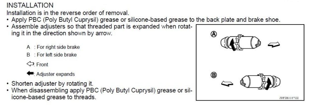

One bit of the Parking Brake info from the service manual is this. The adjuster is oriented differently for LH and RH sides. There may be a "wrong way" to fit it.

Hi Neil,NewcastleFalcon wrote: 09 Sep 2024, 13:40 One bit of the Parking Brake info from the service manual is this. The adjuster is oriented differently for LH and RH sides. There may be a "wrong way" to fit it.
click to enlarge
I double checked the fitting of the adjusters against both how they were originally installed and the youtube disassembly video. One side has a left hand thread to ensure that rotating the adjust DOWN loosens the handbrake on both sides of the car...

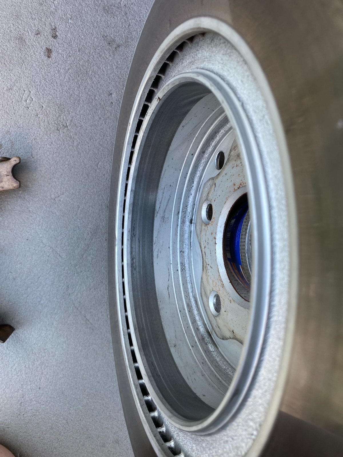

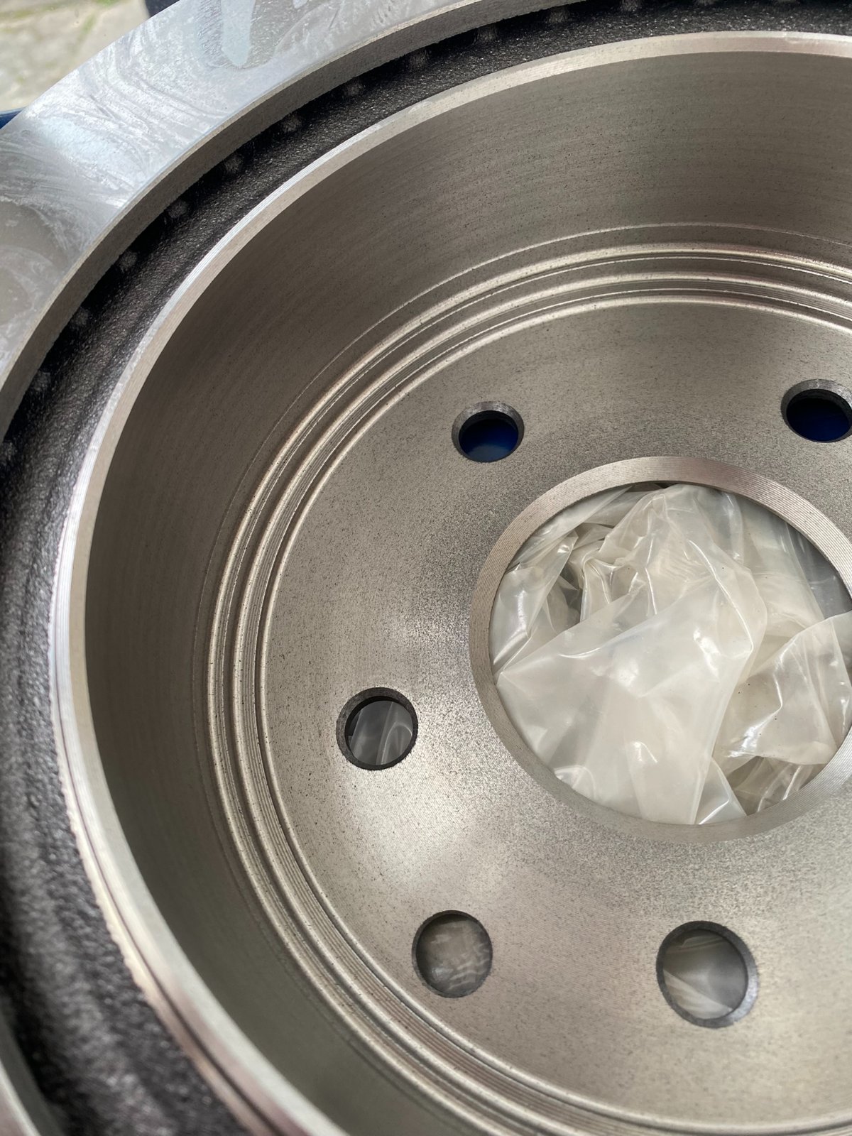

I received the Bosch brake disc/drums a few days ago but have had to wait for an opportunity to install them.
I actually took today off work to do the job as it was supposed to be fine and the weekend is rain, however it's just started raining on me so I've come inside to fume for a bit while the weather clears...
The new Bosch discs look considerably better quality than the Triscan ones - in particular on the Bosch disc the entire inside drum where the shoes go right up past the shoe area to the front is very accurately machined and has a very smooth shiny finish:
Whereas on the Triscan disc you can see the very rough finish on the part of the disc that hasn't been worn in by the shoes which has a kind of powered grey appearance and quite a rough texture, leading me to wonder if it has even been machined at all ? Or perhaps has had some kind of powder coating applied ? In any case it was a very rough surface that would take considerable bedding in.
Thoughts on the difference between these disc finishes anyone ?
By the way I had to wind the adjuster on the left hand wheel right back to loose as possible earlier this week as the left brake kept binding enough to get very hot when driving despite seeming to turn freely when tested and it still gets warm with it wound right in. (The right hand side is cold after driving)
The left side is also the side that seems to bind more as the disc is pulled up into place on the studs so there is definitely some kind of alignment issue there. Hopefully the shoe linings have not been burnt.
