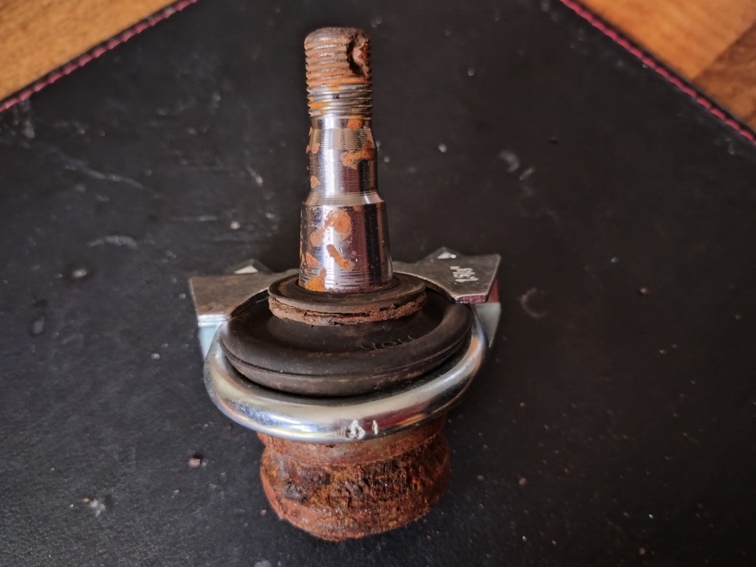

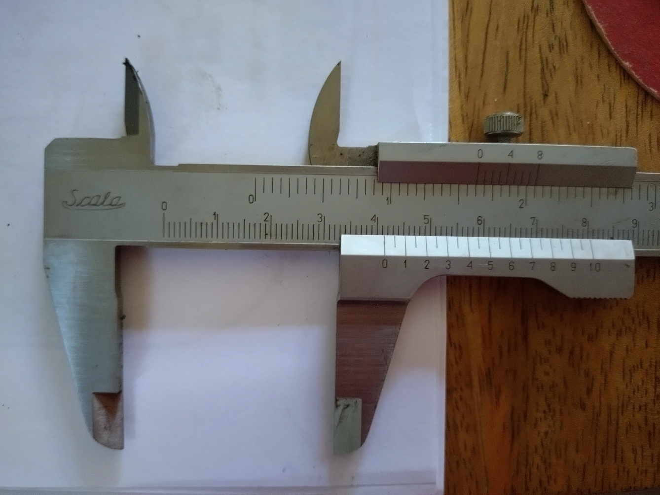

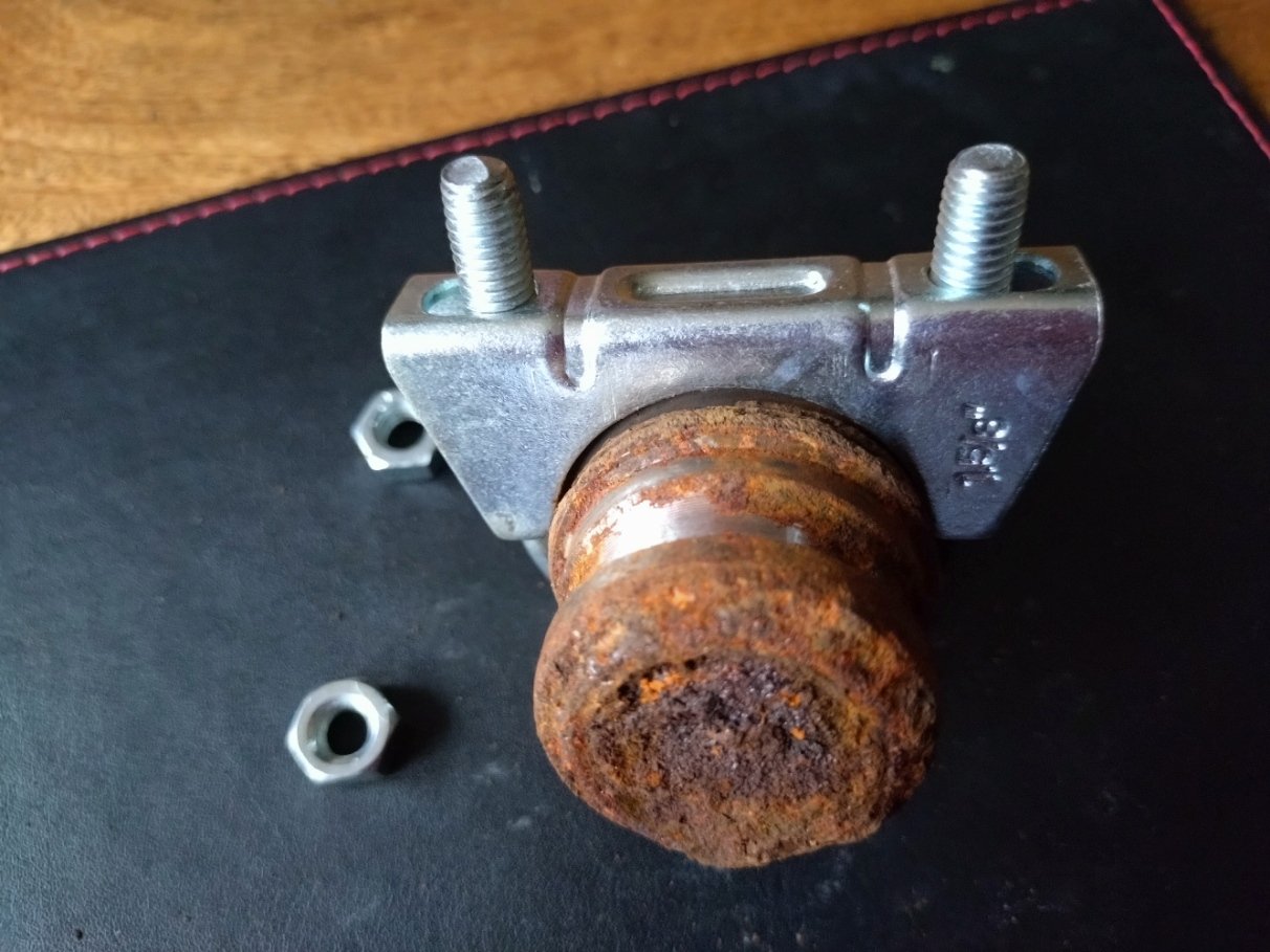

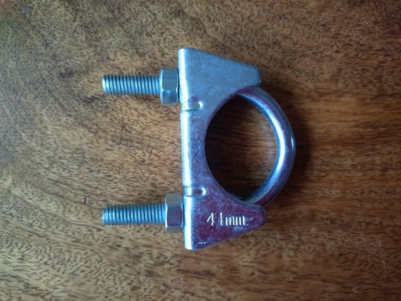

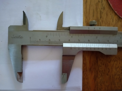

A short addendum to the ball joint story. In the middle of the task you may remember I measured the diameter of the joint with a view to getting a clamp around it to give me more purchase for pulling/bashing it out.
The ball joint diameter
I found what I wanted from a classic car parts chap in Borehamwood so I popped down to collect it yesterday morning but he had gone out, so I made use of the journey by collecting the DeWalt hammer and some other things from my man in Elstree.

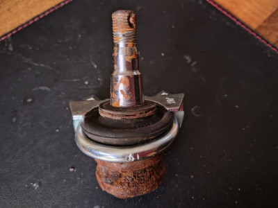

This morning, having got the car back on the road, I set off to take back the DeWalt and collect the clamp which I will now put away for next time:
Designed for the clasp edge to fit around the lip in the joint!

Purely from curiosity I decided to see if the clamp idea might have worked. The clamp fits perfectly round the ball joint:
Snuugles into the joint moulding
And the flat side is flush with where the bottom of the knuckle would be so it could be fitted in situ.
Sits flush with the knuckle face
That would have been clamped up as tight as possible and then used to give an adjacent purchase for hammering with much better effect than on the arm where the rubber of the joint must absorb some of the impact effect. Next time!! :-D

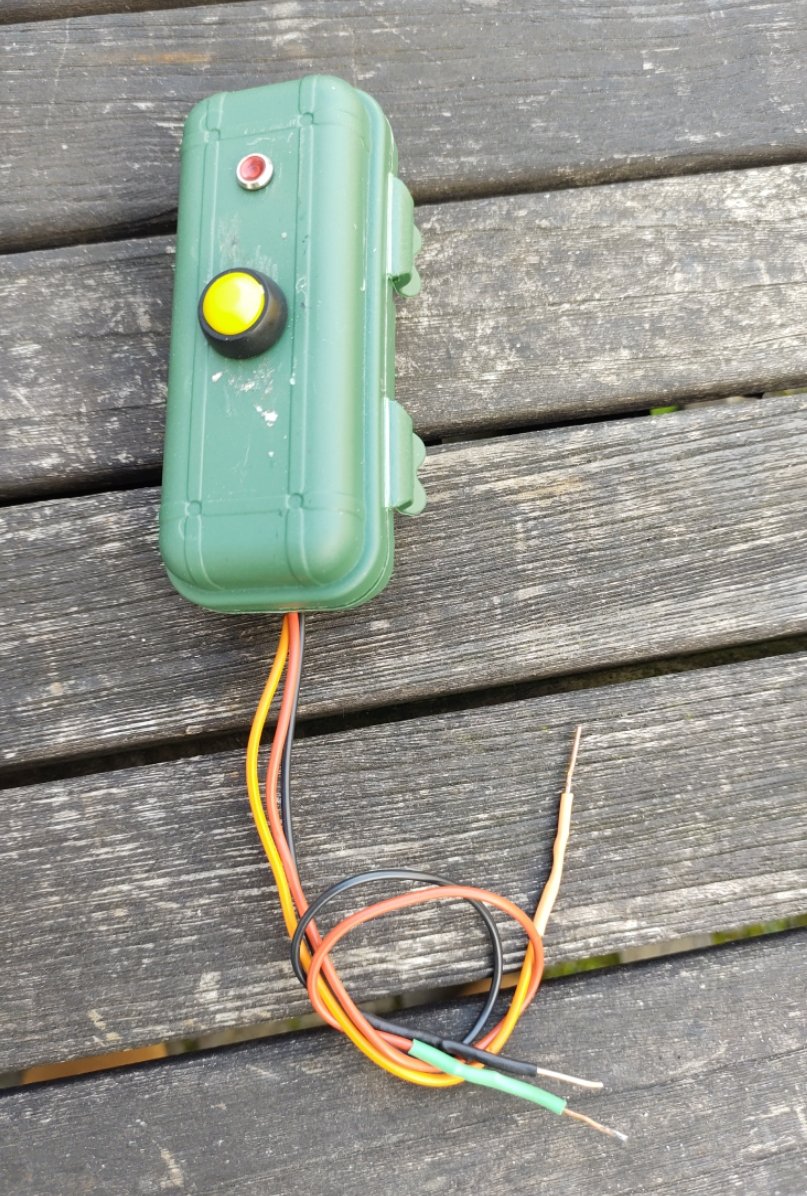

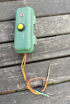

Behold ! The Mk II new and improved made with space-age components every expense spared Mercedes diagnostics machine 8-) :lol:
The box it's fitted in was what a small torch came in :-D You'll notice the colour co-ordinated wires to match the German national flag :-D
A fully functioning Mercedes diagnostics machine - own work

Looks like you were on the money with exhaust clamp sizing. As you say, actually being able the channel some of the hammer's kinetic energy in the right direction can be half the battle so think that would be a good help.
Only problem is likely have is an inability to lay my hands on that specific exhaust clamp if the need arrises again several years down the line!
Though I have part of a toolbox in which any "special tools" congregate so perhaps it would live in there and so be easily found one day.

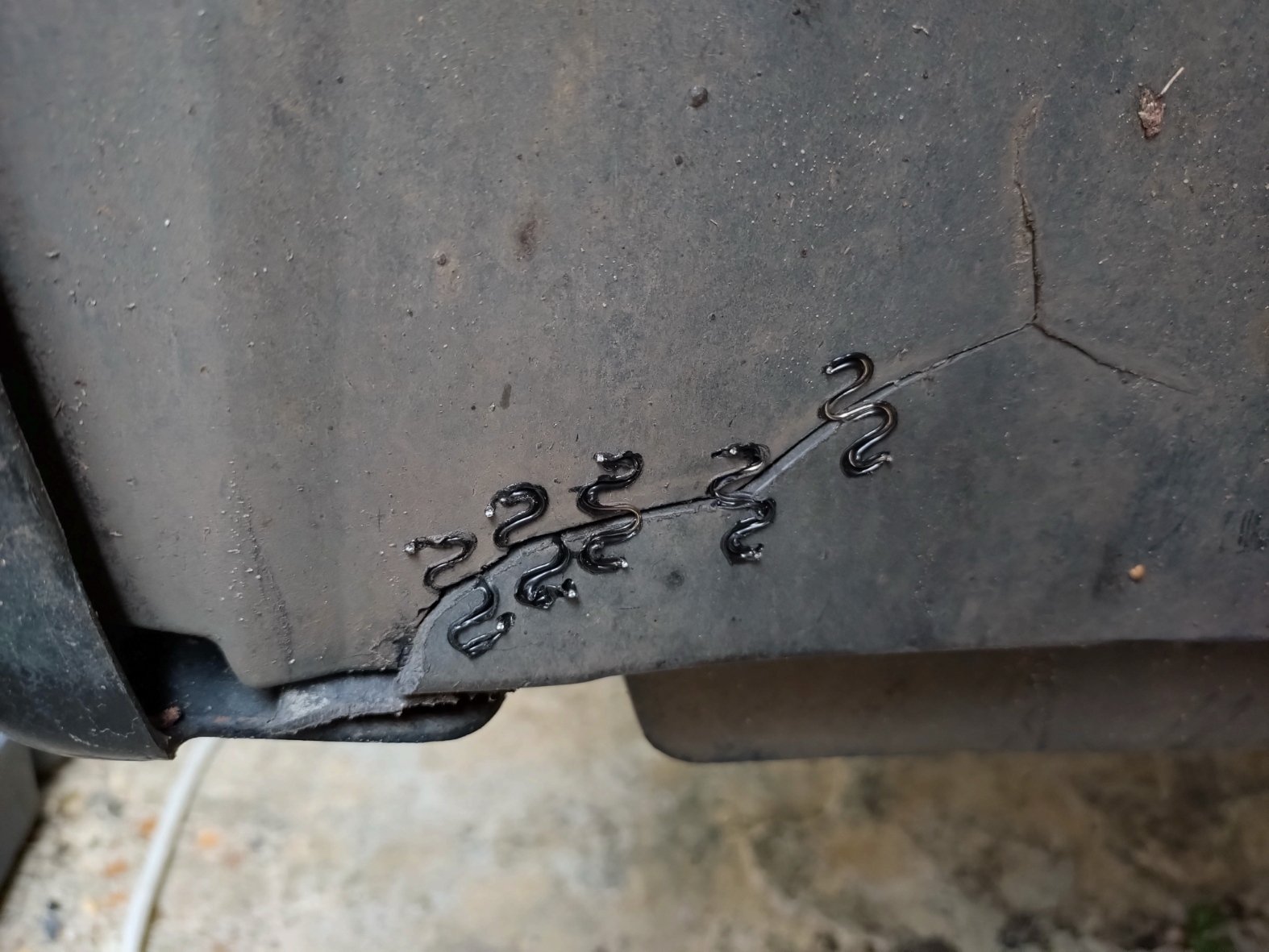

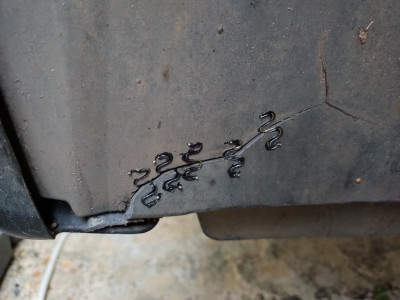

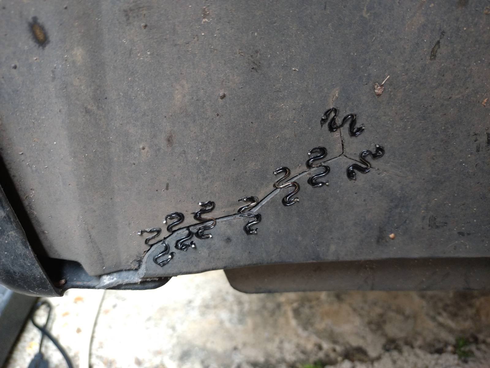

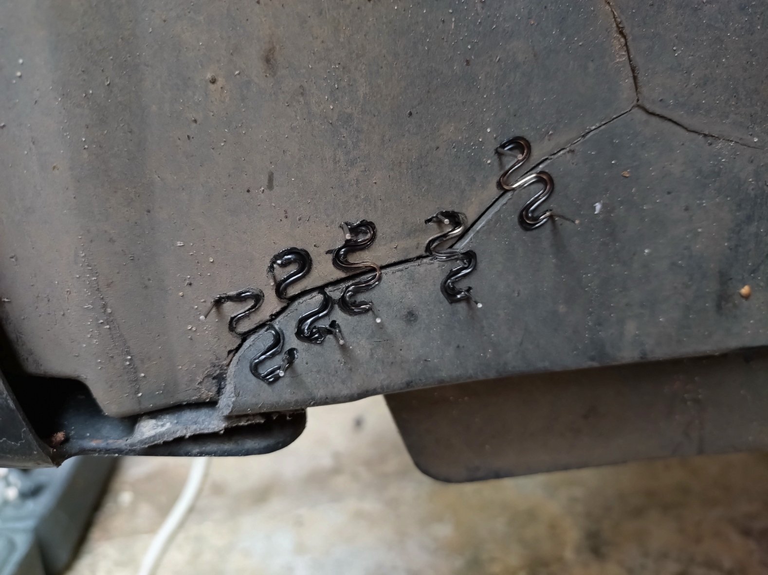

I put the new plastic staple gun to a proper job this morning. The inner wheel arch lost an argument with the chisel during the ball joint saga so it gave me the chance to use the gun in earnest:
MTMO
MTMO
MTMO
MTMO
MTMO
MTMO
I have some plastic bumper filler ready for the repair I still need to do on the bumper so I'll finish this off when I have mixed some for that!! :-D

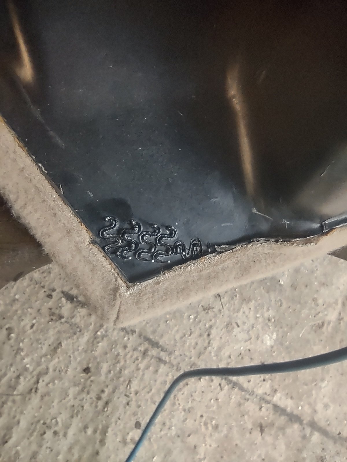

x 3567
Re: DIY Car Maintenance with function over finesse!!

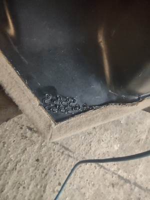

Like you, Mick - I had a go at hot stapling the back of the battery cover trim piece in 'Helga' during the week. I think the hot stapler's already paid for itself for me as I've used it several times now :)
Hot stapled plastic repair - own work

I think we'll have to start classifying these hot staple repairs in order to convey some idea of what was involved. I'd say mine was class 8S while bobins' was a 5S. I'll let you detect how the classes are defined!! :-D
