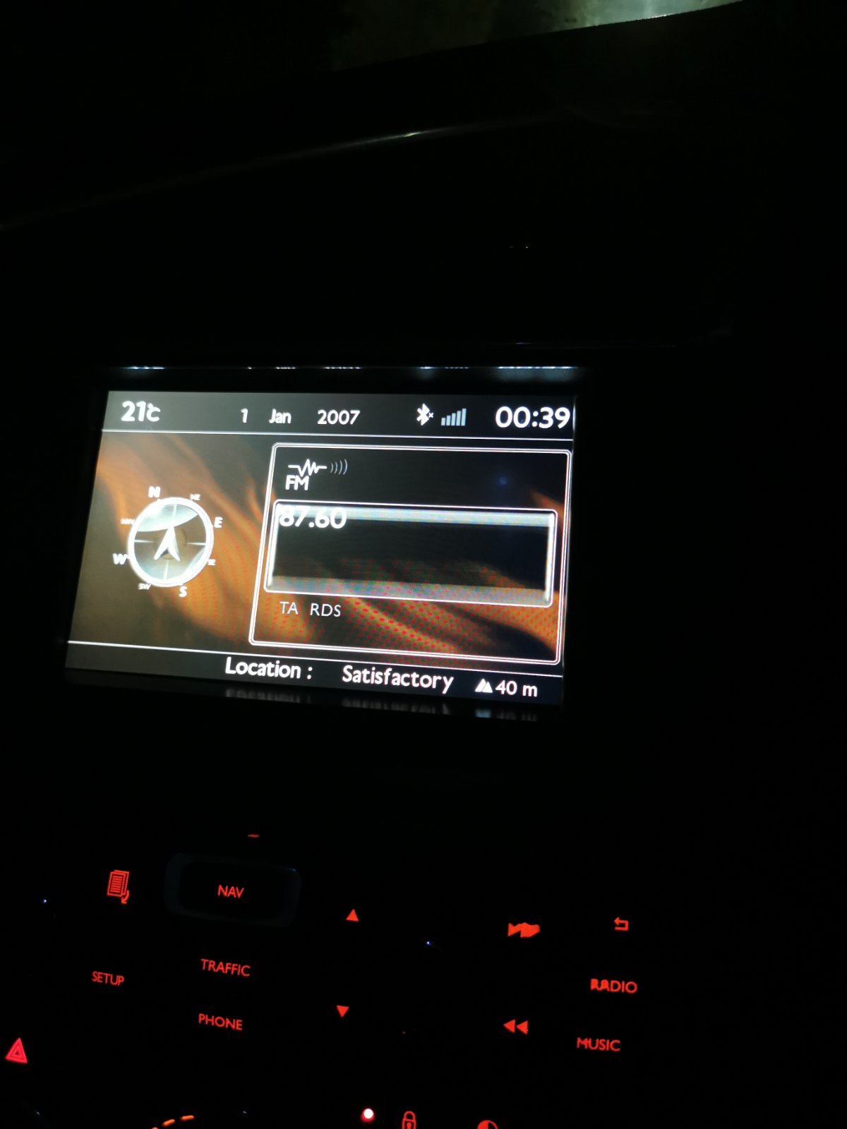

Thanks Marc, I've flashed new firmware on new sd card.
Couldn't get Mirascript to work as the unit kept restarting after 5 seconds.
Now i have a beeping sound which is probably to fix the date and time? The setup button doesnt work...

Re: How to Replace the Internal MicroSD Card - RT6
Unfortunately the beeping sound means the unit has lost all its configuration settings in that case and the beeping means it needs amongst other things, VIN coding. This can be a possible consequence of the 2.86 update. As you haven't been able to get mirascripts to extract the user data, then it was probably too far gone.
As a consequence it means you'll likely need the dealer to configure the Head Unit for you as when this happens the RT6 goes into secure mode, which means Diagbox won't be able to configure it without access to a PSA servers.
At least whilst at it, they can check that all your vehicle options are working and correctly configures like parking assistance etc. Still, it's a lot cheaper than a new Head Unit.

Next morning cold start, beeping is gone. I think it is just to remind you to change date and time. I figured out how to connect to bluetooth by playing with all the buttons on dash and steering wheel. Still can't get in to setup but that's ok, all i wanted was to listen to radio and connect to my phone for music.
I will try to take it to the dealer to get it configured, as its my daily running car im just hesitant to do so. Also, i used samsung Evo plus 64 GB card, as that was the smallest available in stores and it worked.
Thank you very much marc
