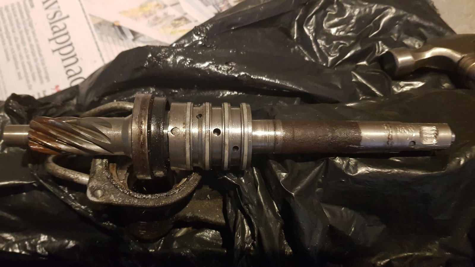

Ok, thanks. The video is helpful. I watched it and trying to remove the pinion in the same way, but it won't come of. Maybe it is just a matter of trying, I will do a later attempt.
Backround to the whole operation is I one morning noticed that the steering was suddenly hard. And the steering wheel did not go back to center. I examined every parts of the steering, including the electric pump, and it eventually came down do beeing related to the rack (no leaks however). So, bought a referbished rack locally from a guy who had refurbished a leaking rack, replacing the pinion and all seals in the rack. Only that he had mounted the pinion rotated 90 degrees to the left, which I noticed only when I had the rack mounted on the car. Wheel alignment is impossible with this offset, so now I am considering trying to undo the pinion from inside the car, lift it and rotate it in the correct position. But I want to be sure how it is done, so I am now "practicing" removing the pinion from the old rack. Will also try to inspect to see what caused the hard steering in the first place. So there is my story.... Thanks for your help!

I have managed to get the pinion out of the old shaft to inspect it. There are 8 teeth on it so one is 45 degrees. Which means that mine, currently mounted on the car, is two teeth offset. Also, if I inspect the holes in the pinion where the oil is supposed to circulate through, these seem to have a very thought-out position, meaning that offset of these holes would probably have impact on the steering itself, possibly hindering it to center. I need to verify this though. After fitting the refurbished rack I noticed that the steering wheel started spinning by itself, without me touching it at all. It continued to do this for a while, I think till the steering wheel angle sensor disconnected itself. To conclude, the hypothesis is that the pinion needs to be inserted correctly if the steering should work. Maybe that was the fault you had Stu (and not the seals)?
The plan is no to try to lift is and rotate the pinion into the correct position to see if that solves the problem.
Also noticed from the old pinion that is was not very rusty and the seals seemed intact. So the original problem was probably due to something else than rusty pinion.

So managed to do some work today on the car. Rotated the pinion in it's correct position, so became aligned correctly with the steering wheel. Now all problems dissaperad. Steering is now self-centering, the angle sensor works as it should and ESP fault does not show anymore. Did not have to do a calibration of the sensor either. So, all good! I would strongly advise you did the same on yours, Stu.

To me it is still rather unclear what causes the leak. The seal where the rusty pinion is seem to be more of a dust seal. If you look at the image above it is clear where the oil is supposed to circle. It has seals between every section of holes. So to me, there should not be oil at all in the area between these holes and the "dust seal". Comments?
