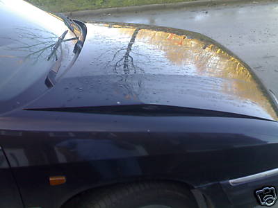

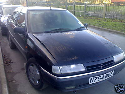

This all looks painfully familiar to me... :roll: :shock:
http://cgi.ebay.co.uk/ws/eBayISAPI.dll? ... 0278936656
