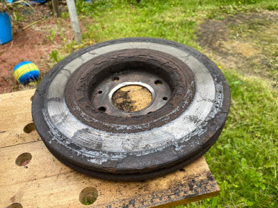

So, I was a bit annoyed at my stupidity with the top caliper slide bolt so I thought I would do a good deed and change the discs and pads over today, however I've run into a problem I've never seen before!
I can't get the piston to wind back in...
I can turn it clockwise forever and it never goes in far enough to make enough room for the pads. I tried turning it slightly anti-clockwise to make sure it was the right way this just caused it to rapidly move out another few millimetres and made the situation worse because now it's sticking out even further and just goes round and round clockwise without going back in even to where I started.
I managed to find a socket that pushes on tight over the bump in the middle so I can rotate it quite quickly with a ratchet and also apply some pressure in case the threaded part had wound out off the thread and needed a push to re-engage but nothing happens, just round and round!
I've also squeezed the piston and it seems to be back as far as it can go.
Help ? Suggestions ? I've changed loads of Xantia front discs and pads on multiple cars and never had this before.

Figured it out! Onwards.Mandrake wrote: 15 Jul 2024, 14:35 So, I was a bit annoyed at my stupidity with the top caliper slide bolt so I thought I would do a good deed and change the discs and pads over today, however I've run into a problem I've never seen before!
I can't get the piston to wind back in...![]()

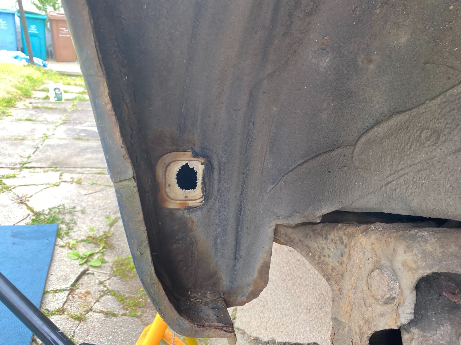

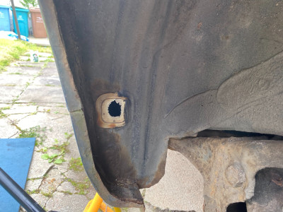

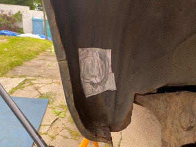

Look in the wheel arch at the back.... There is an open oval hole in the arch liner, Citroen never closed it....this is most likely the source of the build up in there.
In the boot, on the side wall behind the carpet covering the inner wing, just below the light level, there is a vent panel, remove it and you can see inside. Looking here will allow you to see the condition of the main C frame that comes down from the roof/forms the main rear/side structure.

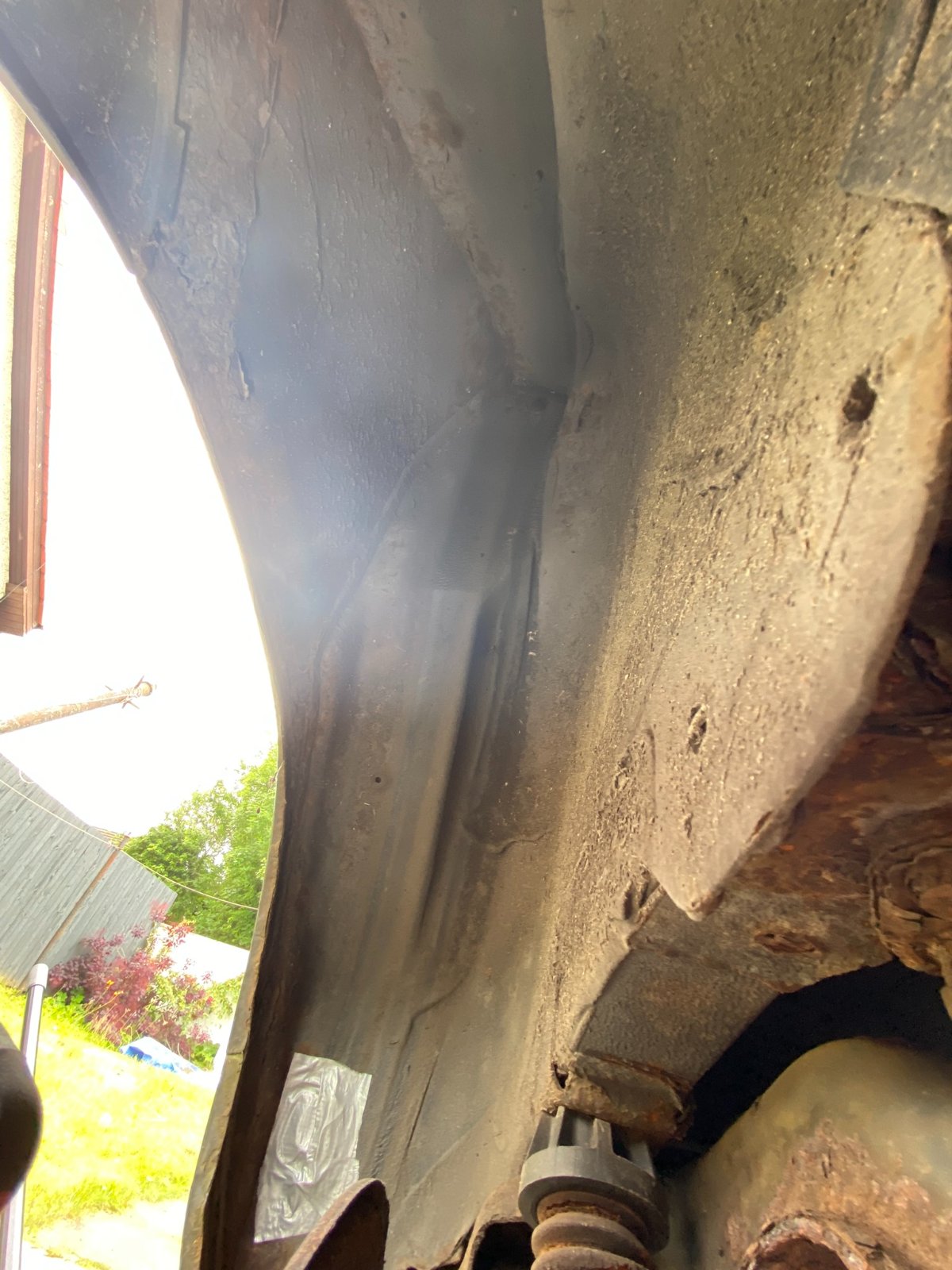

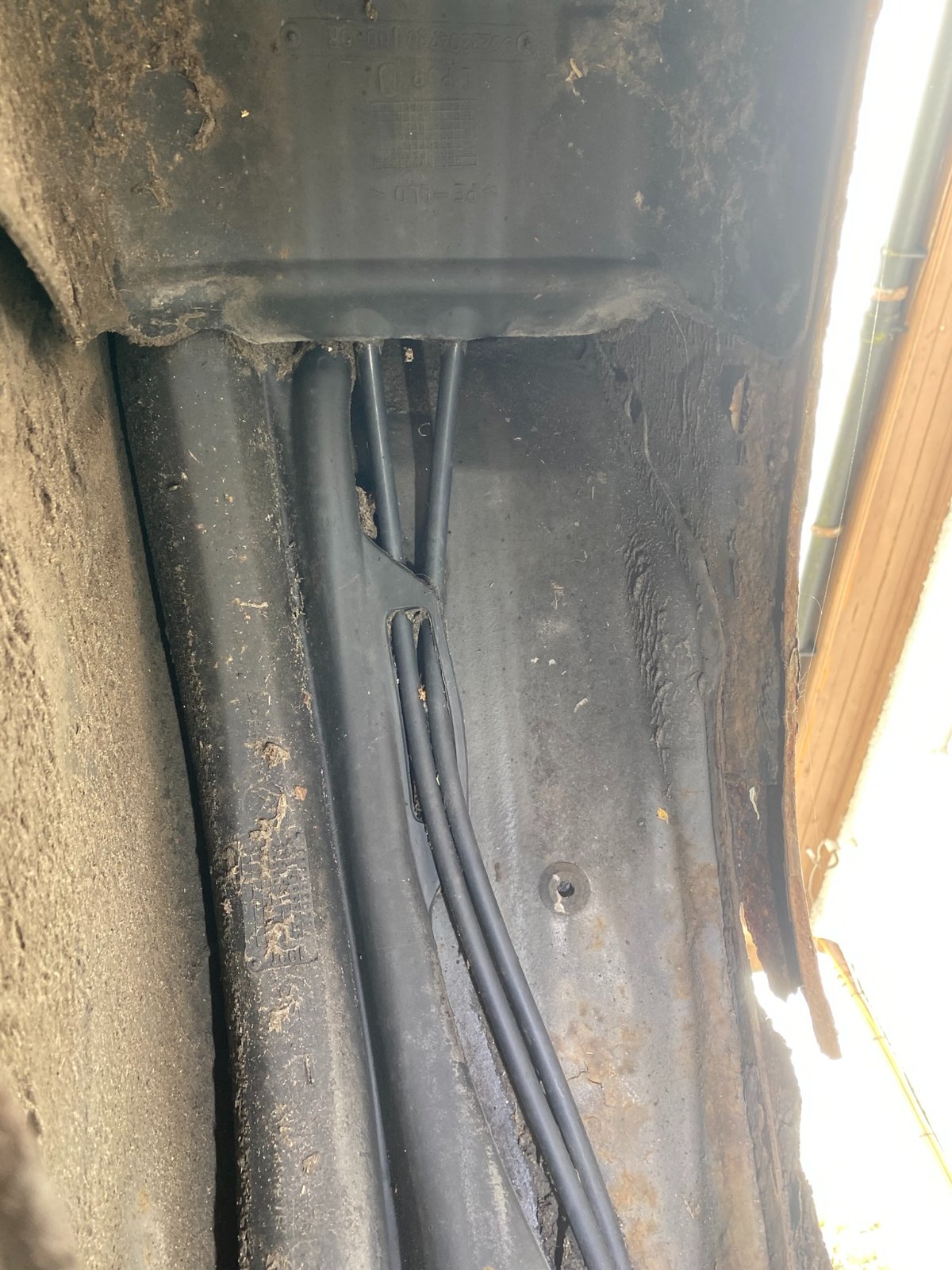

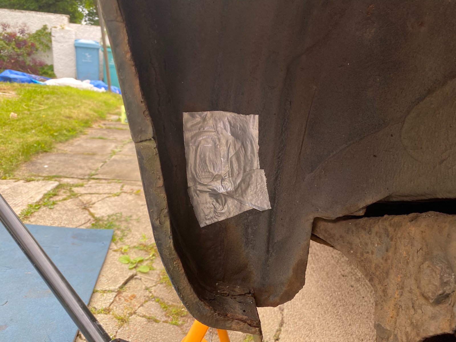

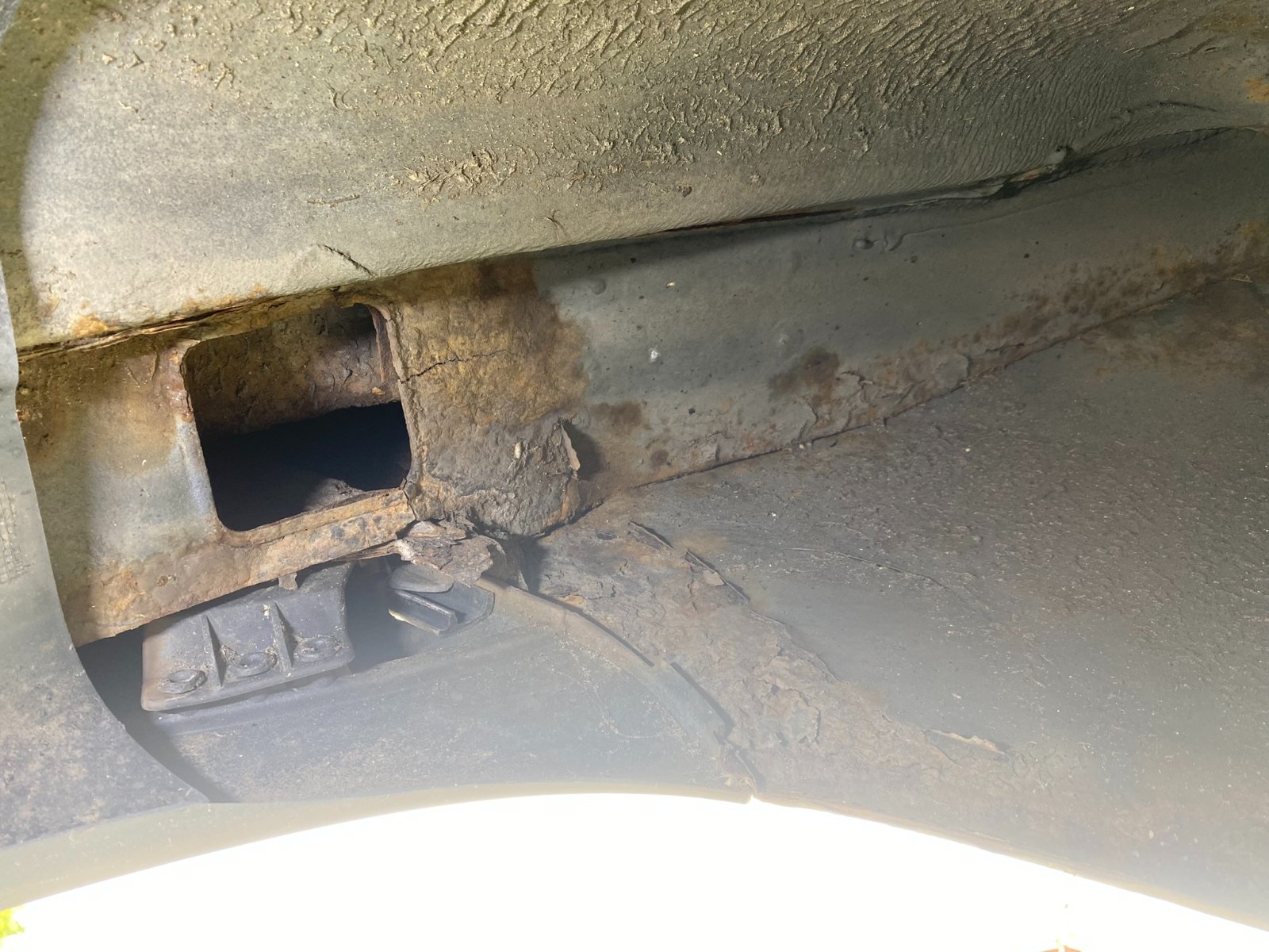

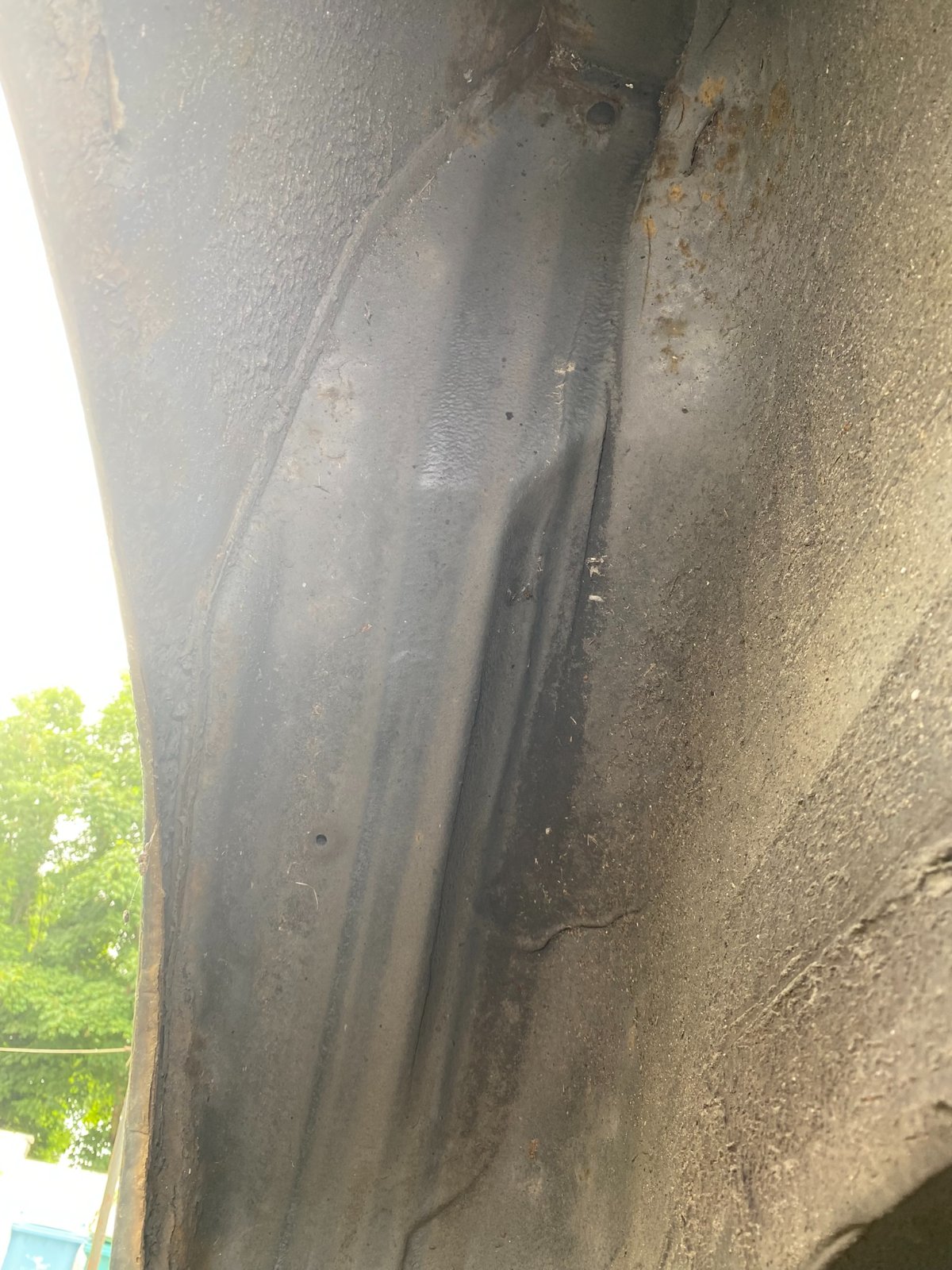

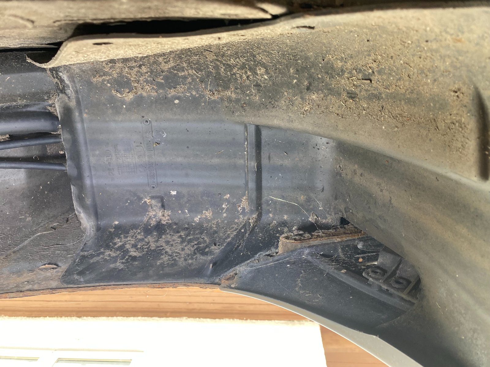

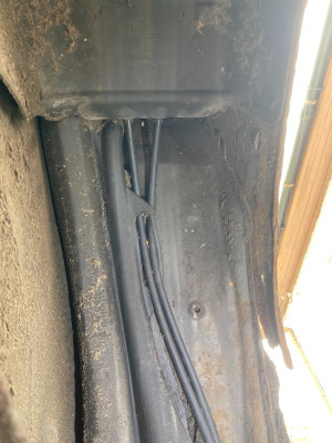

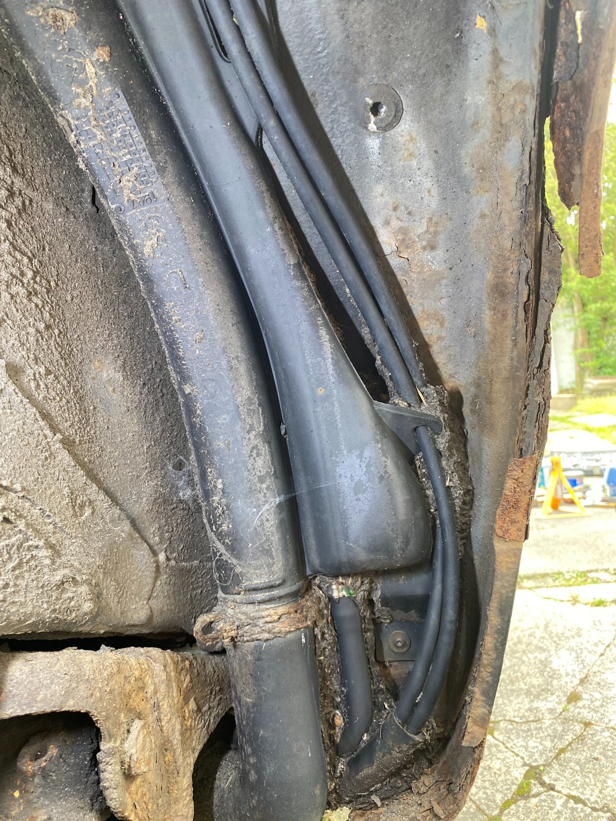

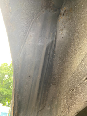

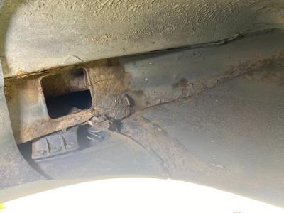

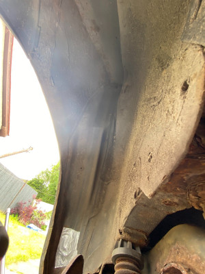

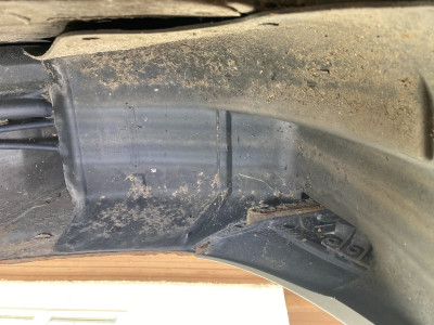

I was bleeding the rear brakes today so tried to get some pictures from within the rear wheel arch's looking out. On the left hand side there is a plastic bung plug that seems to have gone brittle and shattered:
Wasn't like that a year ago as I did some clean up on the rear brakes last year and would have noticed it. For now I've gaffer taped over it to stop any more water potentially getting in:
The rest of the left hand side:
Right hand side:
Hopefully that helps.
I guess I should state the obvious here that you're not going to find a 27 year old car that sits outside and was being used on the road that is rust free, so expectations have to be set accordingly and a little bit of work may need to be done here to patch up the rear arches sufficiently for the MOT.
If it was rust free I probably wouldn't be selling it until next year, when I do really need to move it on due to a change in circumstances with drivers and a possible replacement of the Leaf as well. (or at least the Leaf would become the second car making the Xantia a 3rd wheel that I wouldn't have room to keep)
It's not a concours car, never was as it already had scrapes from the previous 93 year old owner when I bought it. (And I nearly didn't buy the car because of those scrapes on the doors and bumpers that it already had) So if I was the new owner I would not be doing any expensive body work to it to try to restore it to original, rather just doing the minimum to pass the MOT and look passable at a glance and enjoy driving the car as it's a car that runs well and is great fun to drive and one of the few left in the UK.
I just checked on howmanyleft and there are only 13 Xantia V6's still licensed in the UK and 60 on SORN. When I bought it in 2014 there were 80 licensed and 40 on SORN. So it's a very rare car now and possibly the last chance to get a Xantia V6 and get a few years fun from it if you haven't had one before, before they are all gone or in the hands of collectors that won't part with them.

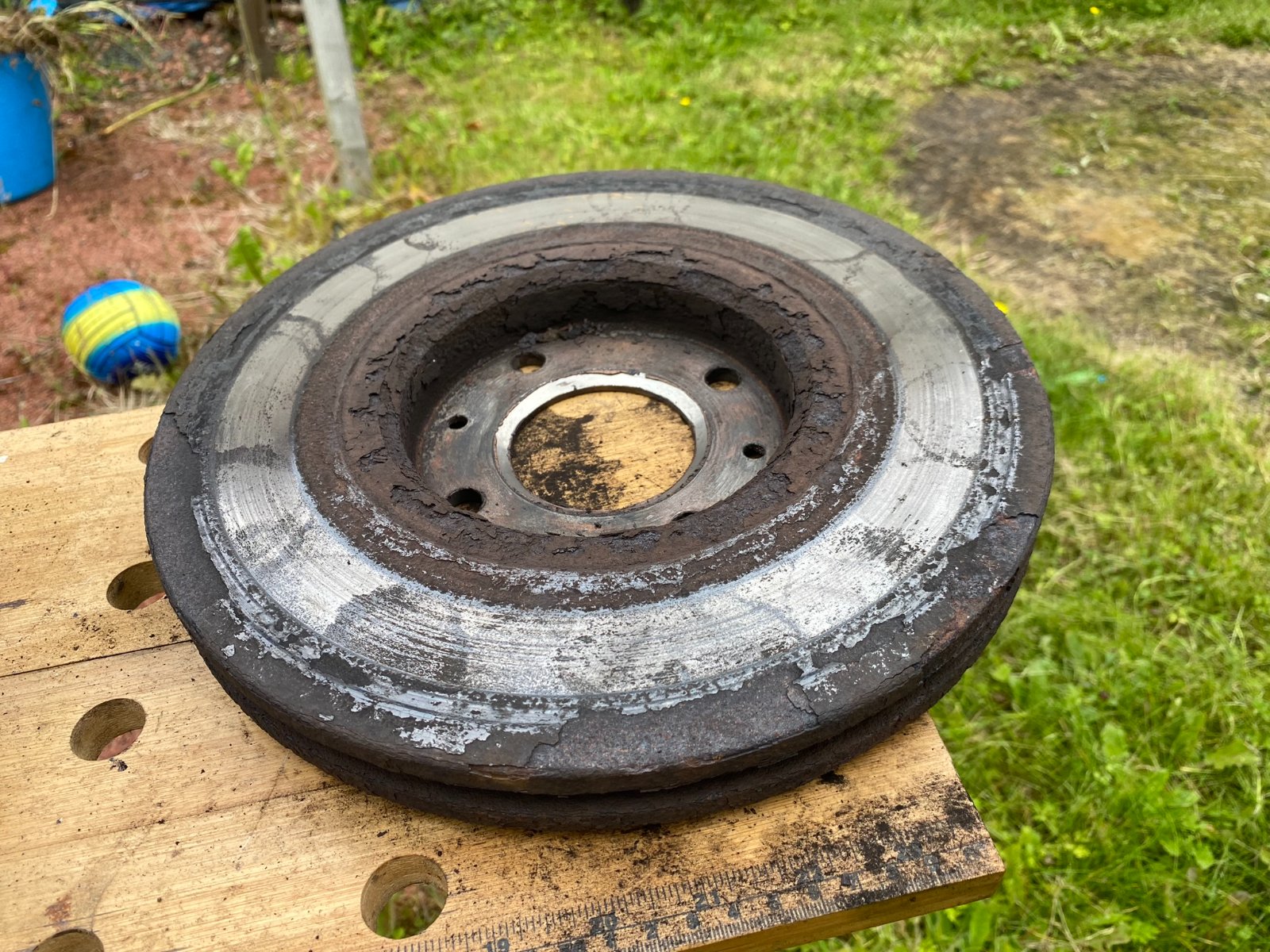

I've finished changing the front disc brakes/pads and bled all the brakes today but haven't had a chance to take it for a drive to bed the discs/pads in. It's no wonder there was vibration when braking at speed, check out the delaminated edges of the discs:
This is what only 6000 miles over 6 years looks like.
As far as I can see that leaves the sump pan leak repair and rear wheel arch rust as the only blockers to getting an MOT, possibly tyres are near the limit on the shoulder.
