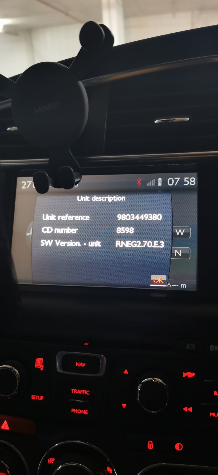

About 4 1/2 years ago with nowhere near the current help available I fixed the sat nav problem on my daughters 2012 Peugeot 308 by replacing the sd card and reinstalling the latest software that was available at that time.
It now appears that the sd card has gone again.Blank screen , no radio etc. Ive removed it and my laptop cannot read it so I'm unsure what software version was loaded.
I do know that the latest map edition I loaded at the time was 2017-2. I'm not 100% sure but I think I had to go through several software updates to get to the latest one.
I have now read through this link that its possible I would need a dealer configuration if I update it to 2.86.
My question is in your opinion as to wether the firmware that was available in 2017 would be upgradable to 2.86 without the need for configuration.
If not I would rather install the older firmware, was that 2.77 ? and not take the risk as that worked perfectly before. .I hope you get my drift. Thanks Nigel
I have read through the 21 pages but I still could do with some advice . .

Thankyou for your detail reply. What I am saying is that due to a blank screen I don't know what firmware I updated it to. As my sd card cannot be read as its had it I cannot recover those details.
I pretty sure that I updated to the latest firmware available at that time circa 2017 which I believe was 2.77.
If I put that firmware on my new card ( instead of the 2.86) then from what I have read iI won't run the risk of buggering up the system and needing a dealer configuration.
Thats my thinking, and I will leave running on the old firmware.

Many thanks. I was preparing an old usb stick to put 2.77 on when I discovered a 2.85 download on that computer so I must have updated to that in the past. So I should be fine with the latest 2.86 which I have just purchased . But many thanks anyway.

Hi just an update re my replacement sd card.
I discovered old software on my computer for version 2.85 so I am assuming that this was what I updated my old, (but now unreadable) sd card with. I therefore felt it was safe to upgrade it to 2.86b which my map supplier offered me for free. It all went well an updated. However whilst everything was now working the language is Slovakian and the miles in km. Everything else is fine. I cannot find which data to change these using mirascript, so Im stuck with it. At least the radio etc works and I have maps.
Just one question. If I repeated the process, new sd card , but used 2.80 this time would it sort the language and km out. Has anyone tried again after installing 2.86. ?
Thanks in anticipation. Nigel

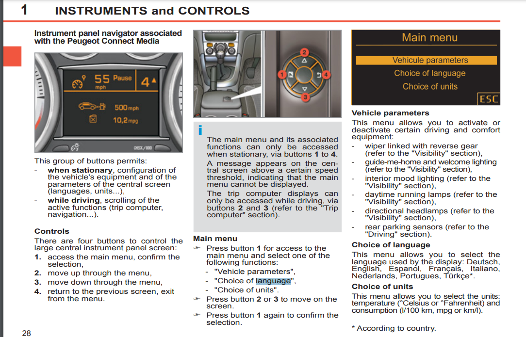

Re: How to Replace the Internal MicroSD Card - RT6
This is the problem I warned about, but you'll need to see of you can change the language from the system menu. You'll need to use a translator as you go through the menu items.
But first see if you can use the instrument panel to change language and units. Refer to your owner's handbook, but you need to find this section:
