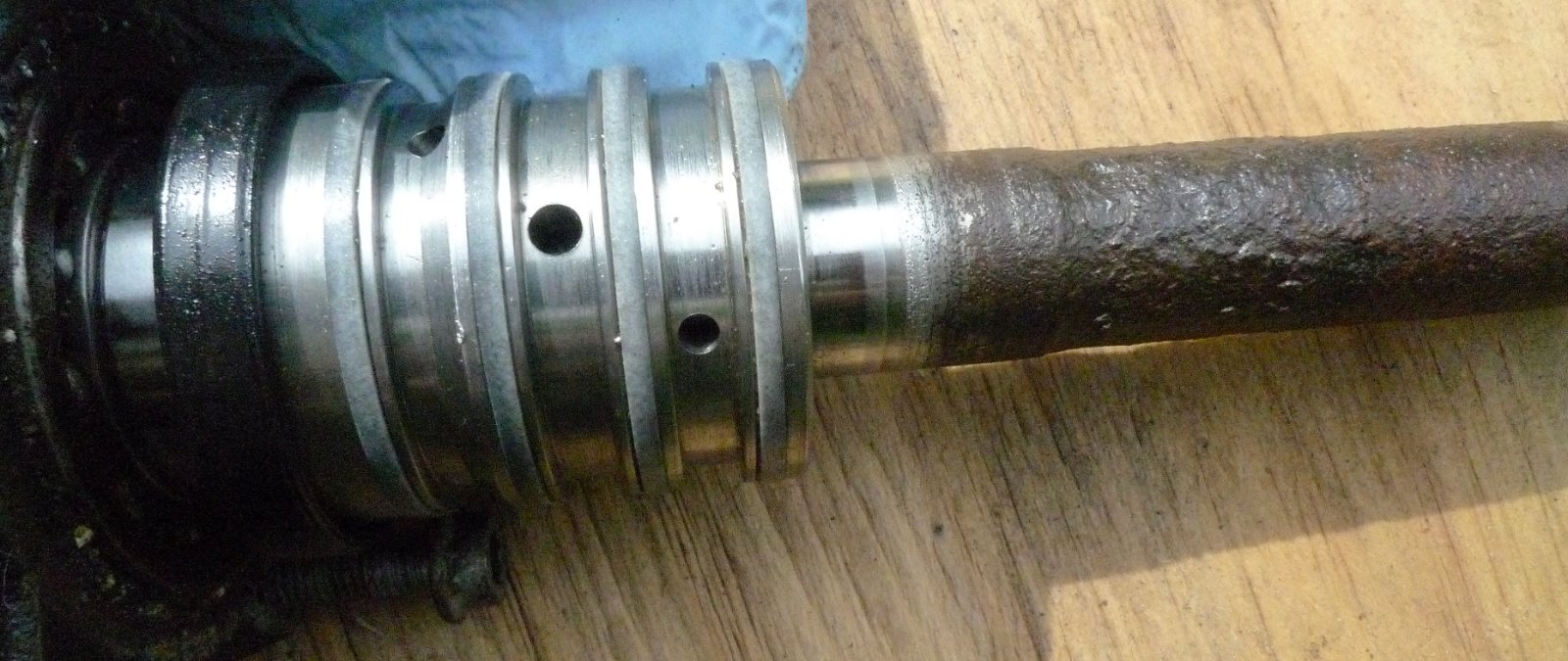

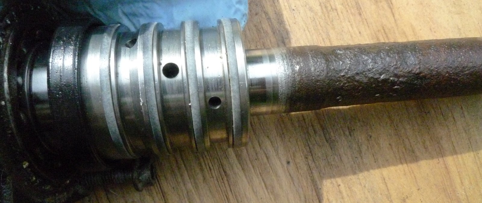

So what exactly did they do Alasdair in that time? A quick rub down of the pinion shaft rust and replace seal? What sort of cost as a comparison to getting a remanufactured or a completely refurbished rack? Did they apply any additional future protection measures at all?
- Posts: 11838
- Joined: 28 Mar 2013, 21:05
- x 1996
Re: C5 X7 Steering Rack - Again!
They have a refurb-business on site, they completely strip it, new seals etc. They turn the p-shaft down & use a larger seal size.
They paint the shaft up to the seal and use a dollop of copper grease.
I will be modifying a boot (adhesive/boot-2-rack) to fit and fill with marine/propeller shaft grease.

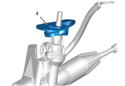

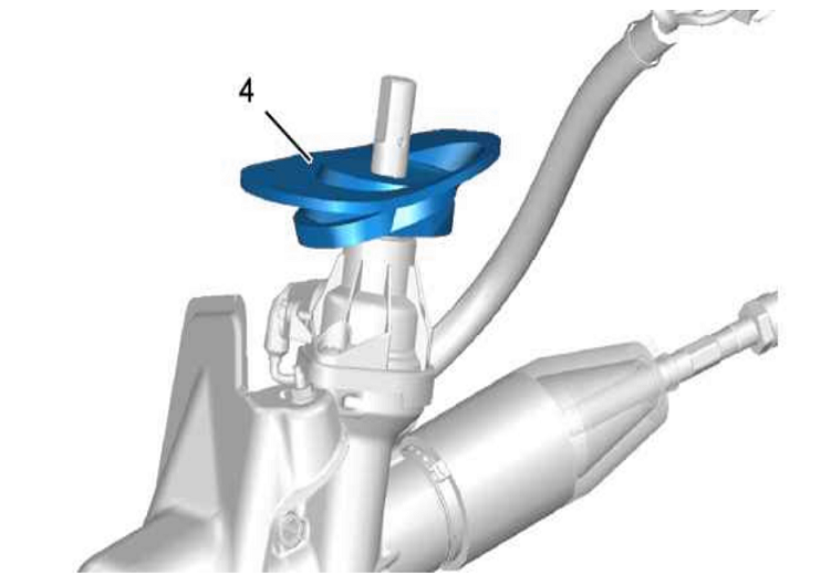

Well well, I was helping out another member today with a 308 (T9) who has some steering issues and whilst looking up some technical info I happened to see this little nugget:
A completely different rack to the X7 - on this 308 the power steering is integrated onto the rack and not sourced separately - but the interesting thing was the design of a seal over the pinion....
Now I cannot seem to find this little beauty anywhere separately so I bet it's another 'supplied with rack only' stitch up! It would also appear to be completely different to the floor plug seal in the cabin. But thought it worth a mention as it would certainly seem to be a reasonable design to help prevent water penetration.

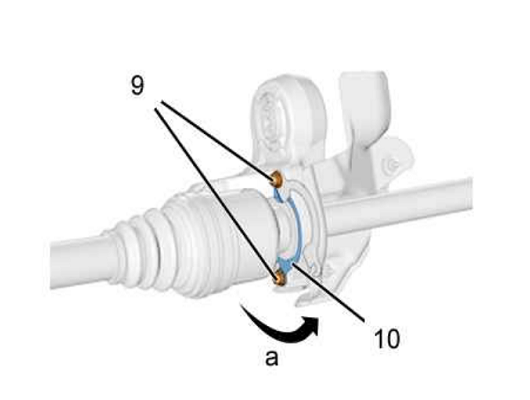

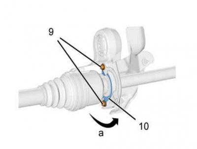

Have a question: How do I get the shaft off the rack? Is it only the two screws that holds it in the rack or does something else need to be loosened? Apart from the pipes of course.
Jonas
- x 6945
I take it you're referring to the right hand driveshaft:
Undo the 2 screws (9) of the RH driveshaft bearing.
Move aside the circlip (10) in the direction of the arrow "a".
Release the RH driveshaft by pivoting the front half-axle upwards.
Remove the right-hand drive shaft.
