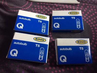

Here is a clue to my weekend task if rain prevents any outside work...
Thanks for the guide on this one Jim

Re: Tales from beyond the grave AKA Dan & Emma's Black Xantia D-auto... & a 206
Oh yes, that's a good job to do... Having any lights out on the dash irritates me immensely
It was one of the very early jobs did on Gabriel... She was definitely dark in the dash department!
As yours is a S1 you'll need to additionally remove the steering wheel which is bloody annoying... Just be careful to carefully align the rotary coupling for the radio controls... They are like hen's teeth now...
Yes, I've already had the 'wheel off earlier in the week to attend to the loose stalks & column cases. not a huge pain to remove again but as you rightly say, those ribbon cables & clockspring will be treated again with kid gloves... Shame the only Xant I know of in a scrappy is an S2 or I'd grab spares!
Currently the only light in the dash I'm aware of that's actually blown is the sidelamp telltale, but the fag lighter and gear selector need doing if only to have them working (I don't need them but, like you, it irks me to know they should light up and don't) I'm sure there'll be others I've not noticed as yet with the light nights. Plus there's peace of mind knowing they're all new. And the Perspex screen of the instrument binnacle is slightly cracked so may attempt to replace that if the S2 has the same part. (I know the instrument cluster is different but hoping the screen part will fit). Oh, and any leftover bulbs may go in the Escort heater panel if they turn out to be the same
Also, if the S2 "glass" does do the job I may look into adding an actual oil gauge seeing as all the sensors are present on the engine. Would it be as simple as fitting the gauge to the existing cluster seeing as the sender & wiring all appear to be present?
The S2 glass will be the same but not the instruments themselves - they are totally different even though they look similar
You'll need the instruments from a high-spec. S1 for the oil gauge and then it should just drop in and work...
You may too be able to swap the tacho and then have an outside temperature display if you fit the sensor to the nearside mirror and the wiring for it all is present...
Is T5 the bulb type? I thought they were 232s.
I'd hate for you to get the dash out and find they didn't fit.
Why's that one dying Dommo? rust?
Shame if it's not saveable but yes the oil gauge and the airbag/wheel/clockspring unit would be of interest if you do decide to strip it.
Jim, all the other spheres have arrived boxed & with a plastic thread protector fitted and were in perfect condition, but this one was just in an air bubble envelope loose. whether it did start off with a cap or seal I suppose is debatable as the package was ripped too, but I think the damage was as a result of it missing that end cap mainly. The thread did clean up nicely in the end and screwed in properly but will just keep a close eye on it having been forced to reuse the seal (which looked perfect, but...)
Typical Parcelforce in my experience, not as bad as DHL on strange "delivery" techniques but one of the worst for damaging stuff...
Anyway, last night was our first experience driving the Xantia in the dark and I have to say the headlights are on a par with the ZX when it comes to "glow worm in a jar"-inosity!!!
not so good then, but liveable until the winter months so there's some relays going to be added and new bulbs too when I get a chance. Nightbreakers maybe?
Less dull on the night was the instrument illumination, which appears to be all OK apart from one bulb! maybe the cracked glass and loose stalks are evidence of the bulbs being replaced by the specialist that did the gearbox oil etc.
I do think the bulbs are right though, T5 286 capless are what I've read. In any case they'll do for the gear selector which is dark and is 100% 286. Sadly I doubt they'd do much for the heater panel which has zero illumination but I may just swap all the panel bulbs anyway since I have no idea if a decent brand was used by whoever may have replaced them.
One good way to improve the lights is to carry out the 'relay mod' where the lights are fed straight from the battery via relays and the headlight earths are beefed up...
You'd be shocked at how much voltage is dropped betwixt battery and bulb when it has gone via the light and dip switches!
Do the mod and they're then tolerable, especially if bulbs like Osram Nightbreakers are used...
Bulbs are 286 capless wedge types for the dash and gear selector but not for the heater panel. They look similar but are much stubbier... 286 bulbs are too long and catch on the internal mechanism...
I can advise the correct ones if needed...
286 that's it, I was thrown off by the T5 bit.
