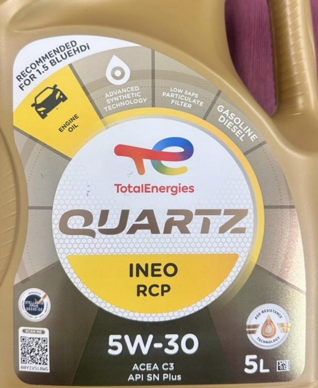

This oli is now recommended:
Total Quartz Into RCP 5W30

Chiko002 wrote: 28 Oct 2025, 23:08 This oli is now recommended:
Yes, Total RCP is also STELLANTIS FPW9.55535/03.
