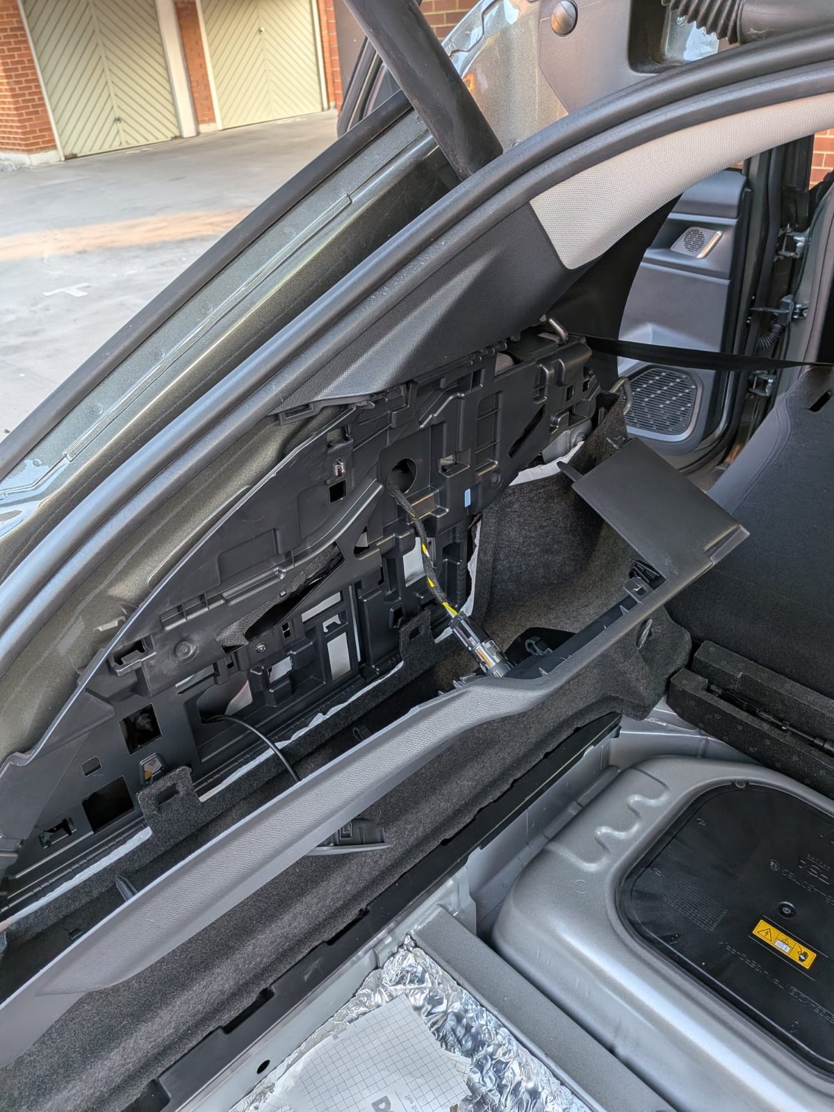

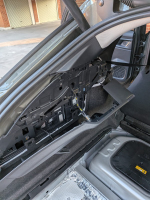

My Dodomat arrived late last week and we we're off away so I was limited for time. Just put 2 layers down in the rear of the boot floor (not around the battery) and also went into the rear boot sidewall on the passenger side. Was quite easy to get off. I was surprised when I felt around there is something around the rear wheelarches, decent white fluffy stuff maybe around 1cm thick and denser than what I've found elsewhere. I did put more in though where I could fit some in and on the back of the plastic. Didn't have time to do the other side but the difference is noticeable tapping the plastic once reaffixed. Tried to post a short mp4 clip under 20mb but the site wouldnt let me.
The 2 areas I now think are a problem are.
1) The doors. Sound like big drums to the tap test. Then there is the plastic sills at the bottom which still fail the tap test from underneath even when closed and touching the seal. Looking from the inside of the door there is 2 round stick over covers at each end of the door at the bottom, I havent looked behind yet but these are probably screw/ bolt points. It could do with a bit of a "sandwich" making there to improve that. Then there's the doors in general, not sure I'll go that far, and depends on what luck I have with the plastic sills.
2) The plastic "underbelly" trays I suspect throw up a fair bit of noise. These run from maybe a foot behind the front wheel to a foot in front of the rear wheels so on a 2.8m wheelbase are circa 2m long. The tap test sounds hollow. I think they'd benefit from dodomat with closed cell foam on top. I did these on the DS9 and while I didn't test before and after it probably helped. They should be easy to get to.

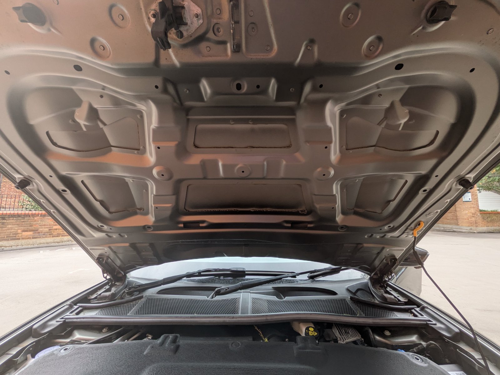

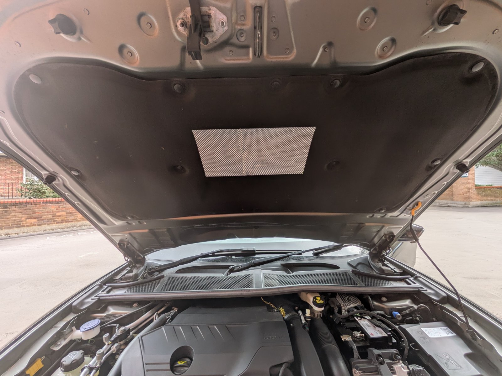

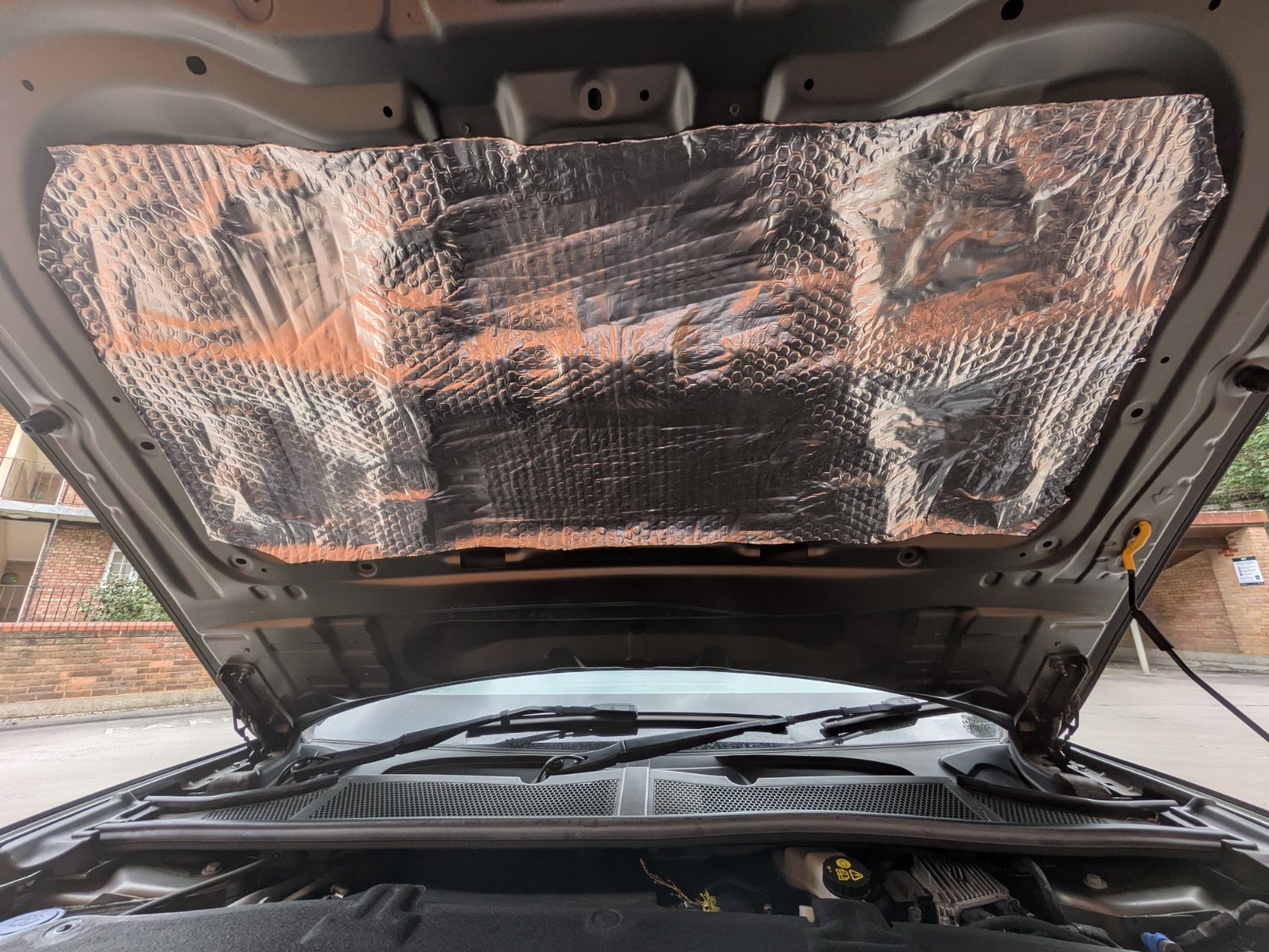

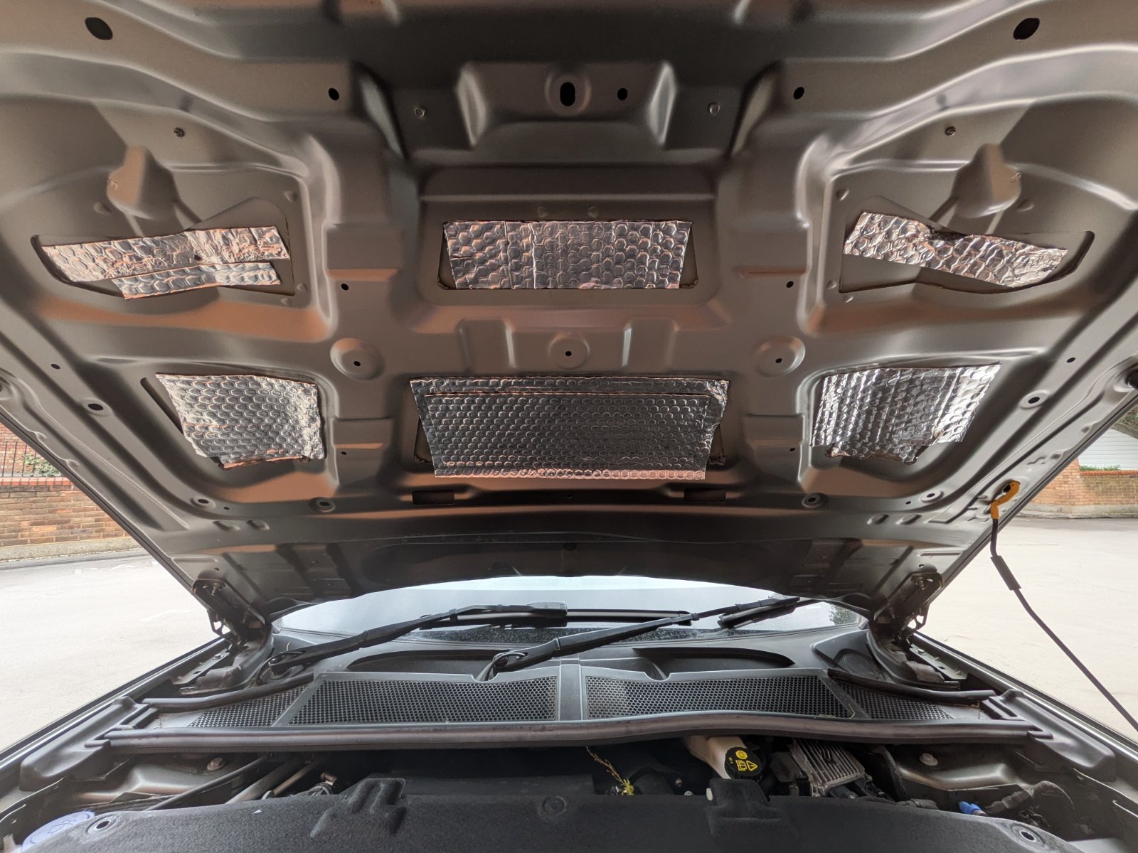

This is an easy job. The bonnet. Took under an hour.
When I put the oem cover back on you can't notice any difference.
Edit: by the way the sandy highlights in pic3 is not dirt just reflection of a wall in front of the car.

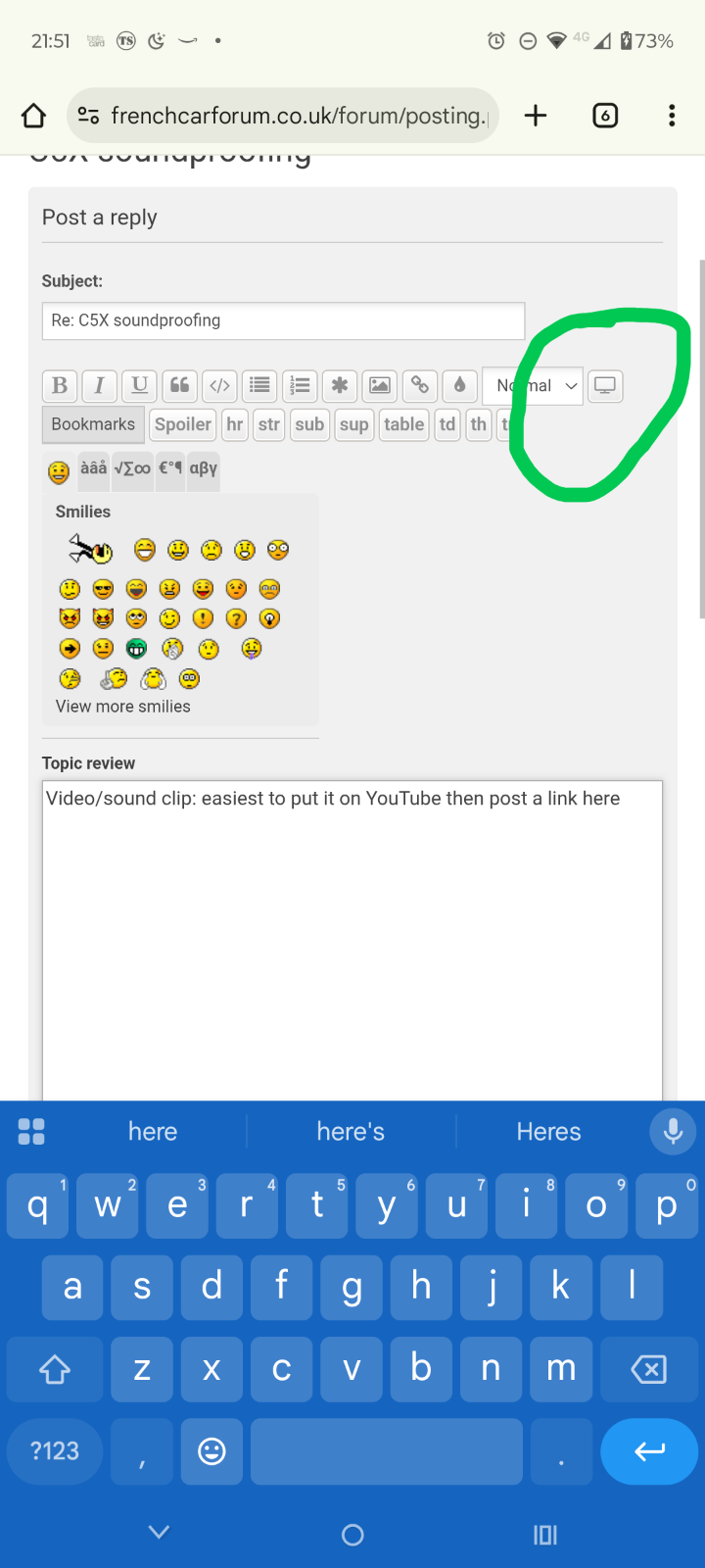

Video/sound clip: easiest to put it on YouTube then post a link here
With this button:
xf1ref

Regarding the bonnet, my previous DS9 had the same size engine, albeit 225hp rather than 180hp and when I fitted one of these to it https://www.dodomat.com/products/dodo-bonnet-liner the engine was almost inaudible after that minute or 2 when the higher revs subside. You really had to listen for the engine at tickover. The mat covered it all and is 10mm thick.
With the less comprehensive alternative in the C5X, pics above a few posts ago, I think it had some effect, but perhaps not as much as I'd like. I think I'm inclined to put another layer on first rather than go for the thicker mat. I'll think about it. It could be the bulkhead isn't as soundproofed as the last car? Obviously the difference I'm after isnt a comparison at tickover but say at motorway speed when the difference will be more stark.

One thing where I might have gone wrong on this car vs my previous DS9 is under the hood. Here I've put 2 layers of butyl stickon under the bonnet felt pad, but on the DS9 I put a liner across the whole bonnet and that seemed quieter. Both the C5x and DS9 have the same engine except one circa 180hp and the other 225hp. It's £40 for the popular "extinct bird" version measuring 1m*1.5m and then cut to size.
That said I get a feeling the DS9 had a bit more in terms of sound deadening from new so maybe the bulkhead isolated the engine more.
