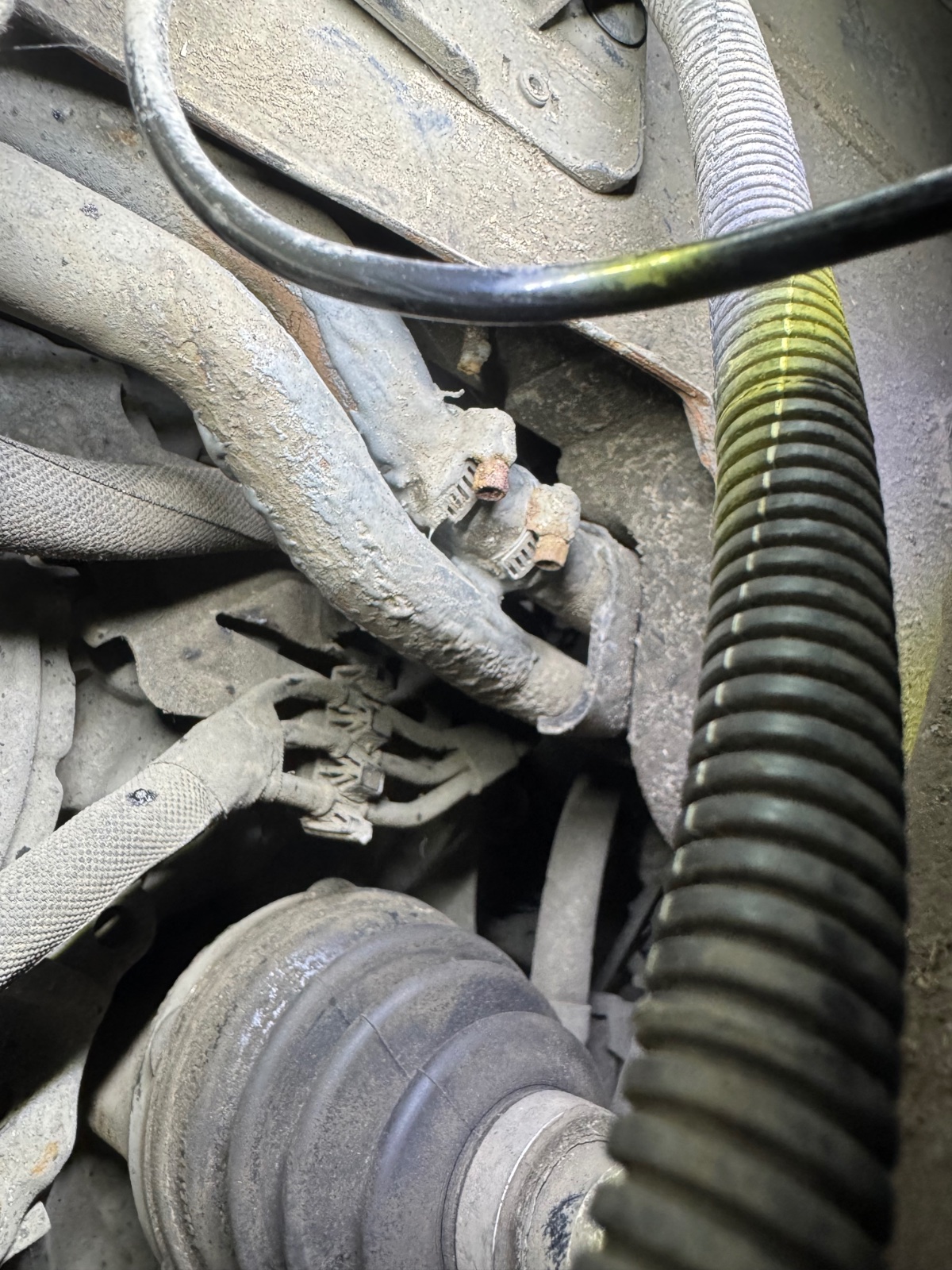

Ref the cooling pipework - someone has been here before. Looks like a top quality rubber sleeve and chemical metal repair
However, it’s holding, so I’ll probably clean it up, silver hammerite over the metal parts and then Dinitrol underseal over the top of that, to try and keep it from deteriorating.

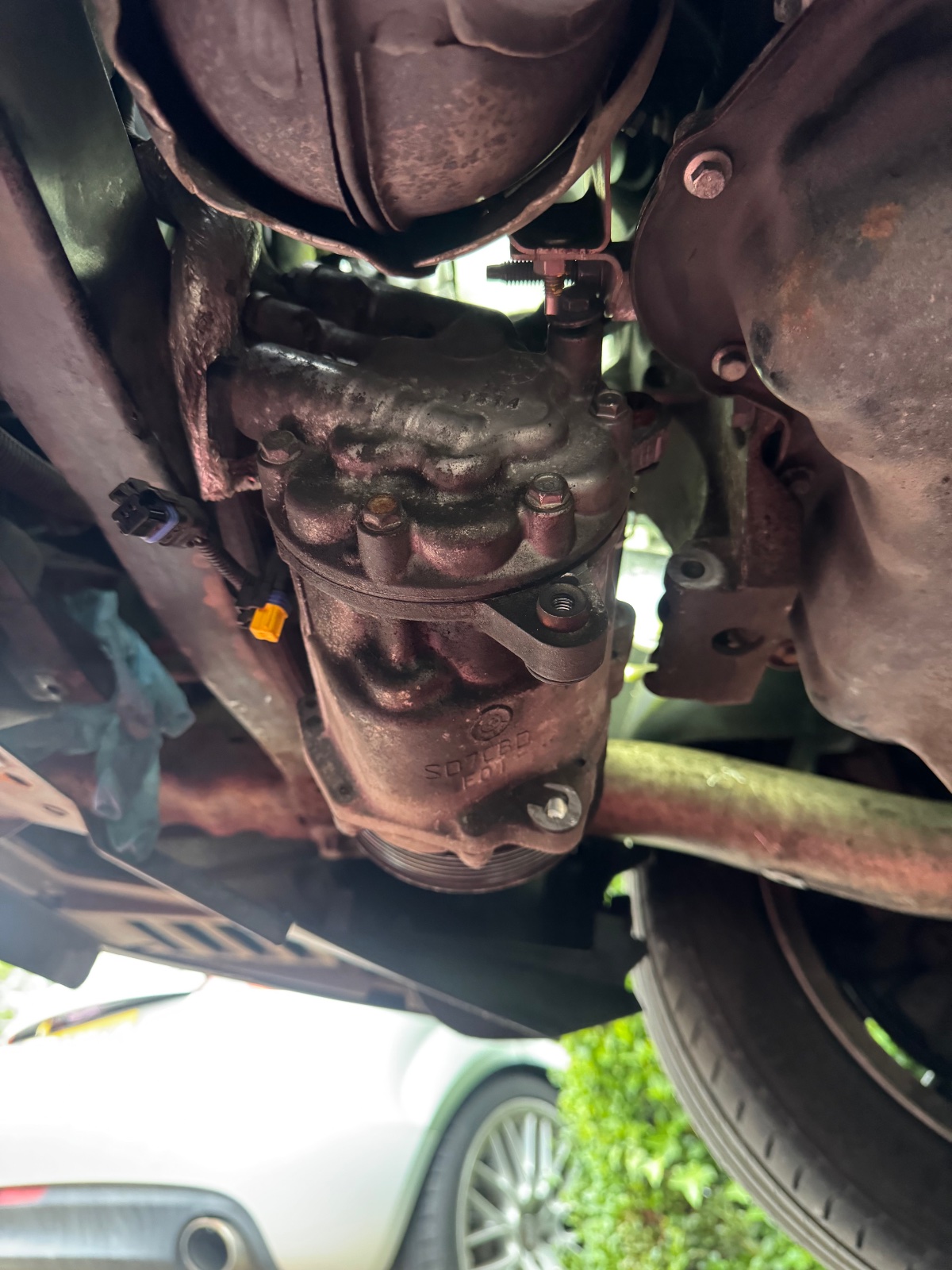

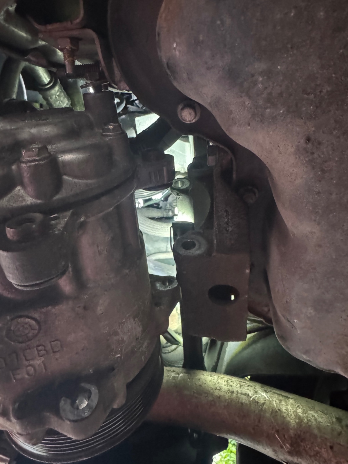

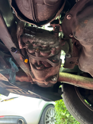

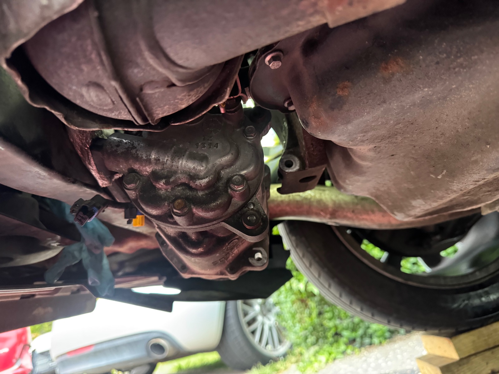

All completed late this afternoon and running smoothly - none of the chatter noise it used to do and no visible jumping or vibration in the belt
For reference, pics below showing how far the a/c compressor can be made to drop without disconnecting the pipework. Generally follow the instructions, but everything I said earlier about which things you don’t need to remove/disconnect and which you do, holds true.
I disconnected (and reconnected) the plug and loom fir-tree clip from the alternator while it was up bolted in position. It’s not possible to get at the main terminal in that position though - leave it connected.
With the drivers side of the front undertray undone (clip from the arch liner and the three screws removed) and pulled down on that side, plus the air inlet duct disconnected and swung clear and by pulling down further on the pulley of the a/c compressor (will temporarily swing it down a little further) and by twisting the alternator the right way, there is just enough room to sneak the old alternator out between the a/c compressor, chassis leg/front crossmember and lower sub-frame arm.
You can pull the alternator into a space between all those, hang it there and undo/disconnect the main alternator charge terminal like that, then pull it out.
It’s also possible to reach an arm up through a hole in the front undertray, through where the air inlet duct connects, to get decent access to the front of the engine. I found this helpful for positioning the alternator back etc and for replacing the loom fir-tree clips (the fir-tree parts get damaged when you remove them and don’t go back tightly otherwise). PSA part number 6980A3.
It’s a good days work imo, simply because everything is so damn awkward to access and so fiddly (and therefore time consuming) to undo.
