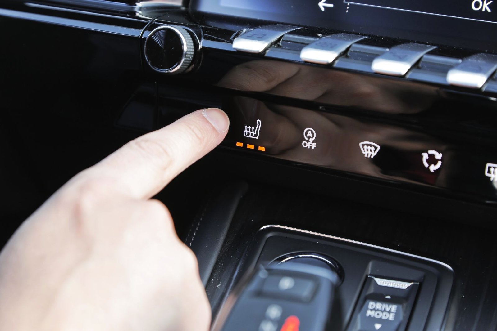

LedZep
Posts: 121
Joined: 25 Aug 2023, 18:25
x 30
Re: peugeot 508 no heating
Unread post by LedZep »
BrayanLDZ wrote: 01 Mar 2025, 09:20 switch? which switch?
This one.It is a kind of rheostat.Check contacts and wiring.But almost sure the problem must be in wiring on seat element.
https://encrypted-tbn1.gstatic.com/shop ... HaZTvduetQ
BrayanLDZ
Posts: 60
Joined: 20 May 2023, 22:34
x 3
Unread post by BrayanLDZ »
I have such a seat heating switch.
LedZep
Posts: 121
x 30
So it is different type from mine.Somehow you must check right operation, contacts and continuity of switch.Maybe it's broken having current issues and not enough current pass through.The other guess is that the electrical circuit, wiring from there to heat element and it's contacts itself in seat, is faulty. Not an easy task. A tester multimeter is needed.
