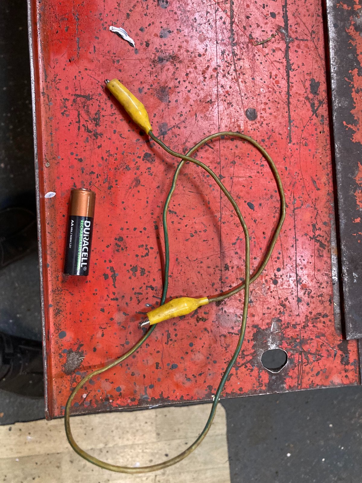

This is what I use for a job like that, The battery is a AA for scale. You can use a long length of wire from battery positive.
MAKE SURE THE GEARBOX IS IN NEUTRAL BEFORE TRYING THIS

I get it now, thanks for your patience Steve. I was about to use a cable like the one you've shown above but then I wondered if it'd melt with so many amps going through it? I just don't see any other way to secure a live cable to that post unless I can loosen the bolt and trap a piece of wire in there.Steve Walsh wrote: 30 Jan 2025, 20:03 That's the one, that energises the solenoid / starter. The one with blue on becomes live when the small one receives 12v. the one on the right is 12v from battery
I put in neutral as soon as I got it secured on axle stands.

I get a nice spark as I touch the leads together but nothing else. I have given the starter a whack, although not a very big one because there is no room to do so. Looks like I'll need to remove it, test it on the bench and replace if necessary. Total bäll ache but it's going to have to be done.
