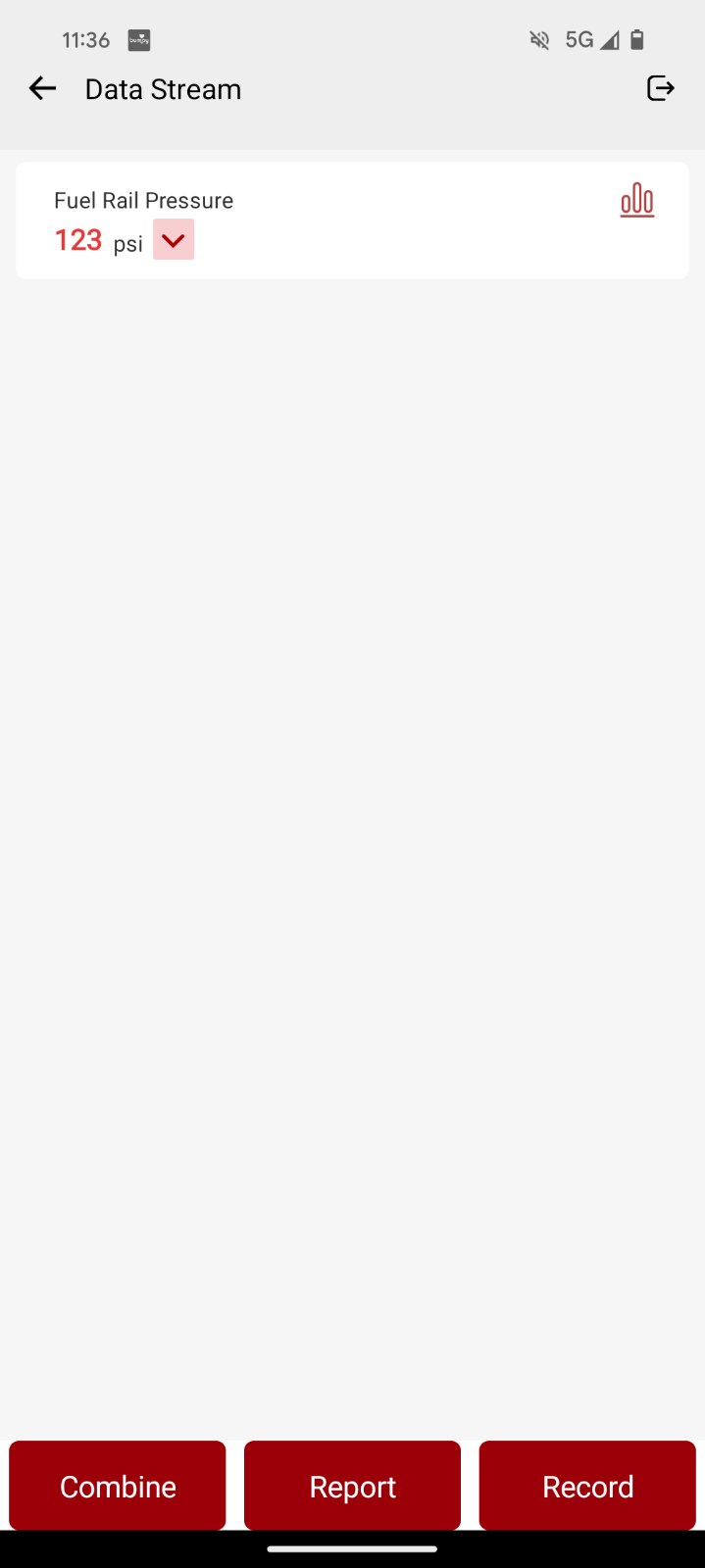

This is the fuel pressure from cold start

Forgot to say, when I started driving the fuel pressure wasn't going up, stayed around the same even when accelerating then EML came on, cleared the usual misfire code, started up again and the pressure was higher and increased while I was putting foot down

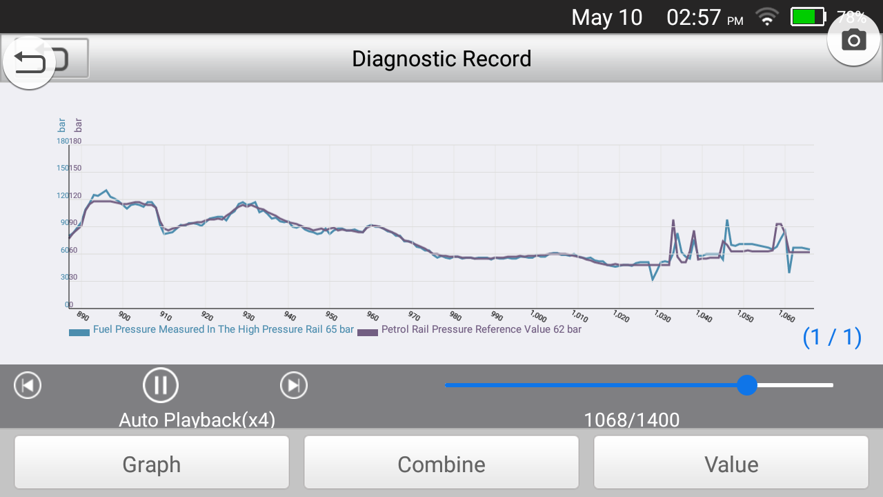

I can't see in those live data screenshots - is there a misfire counter function anywhere? Ideally separate by cylinder?

Not separate no, today was cylinder 3 but it does change. I pulled over when EML came on and plugged in while engine still running and fuel rail pressure was bouncing between 100-200 psi, the misfires only ever happen when I first set off driving, at the moment I'd say about 8 times out 10. This morning it was in economy mode when I went to start it , not sure the right battery is in it either, only 52ah. I've no rattling noises or anything, no coolant leaks etc. on live data it says camshaft and crankshaft are in coherence

I think I saw 8 bar of fuel pressure with the engine idling in one of your screenshots. It should be closer to 40. Before you start the engine the pressure from the pump in the fuel tank should be 4-5 bar. You need to plot fuel pressure against ref pressure. I think your HPFP is faulty

Yea it seems that when I start the car, at idle the fuel pressure is low and when I set off it doesn't increase then I get the misfires and checking the pressure when I have the codes it is the same, when I clear the codes and fuel pressure goes up it seems to be fine after a while but initial starts it can be really low and I think that's when I get the codes. I had a look where the fuel pump is, seems easy enough to change? Was only the plug I could get at properly, maybe need to take battery out and move ECU?

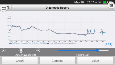

It is very puzzling, and disappointing, that your code reader did not give a low fuel pressure code. Can it do live reading of fuel pressure? You should be able to plot fuel pressure against ref pressure at the very least.
