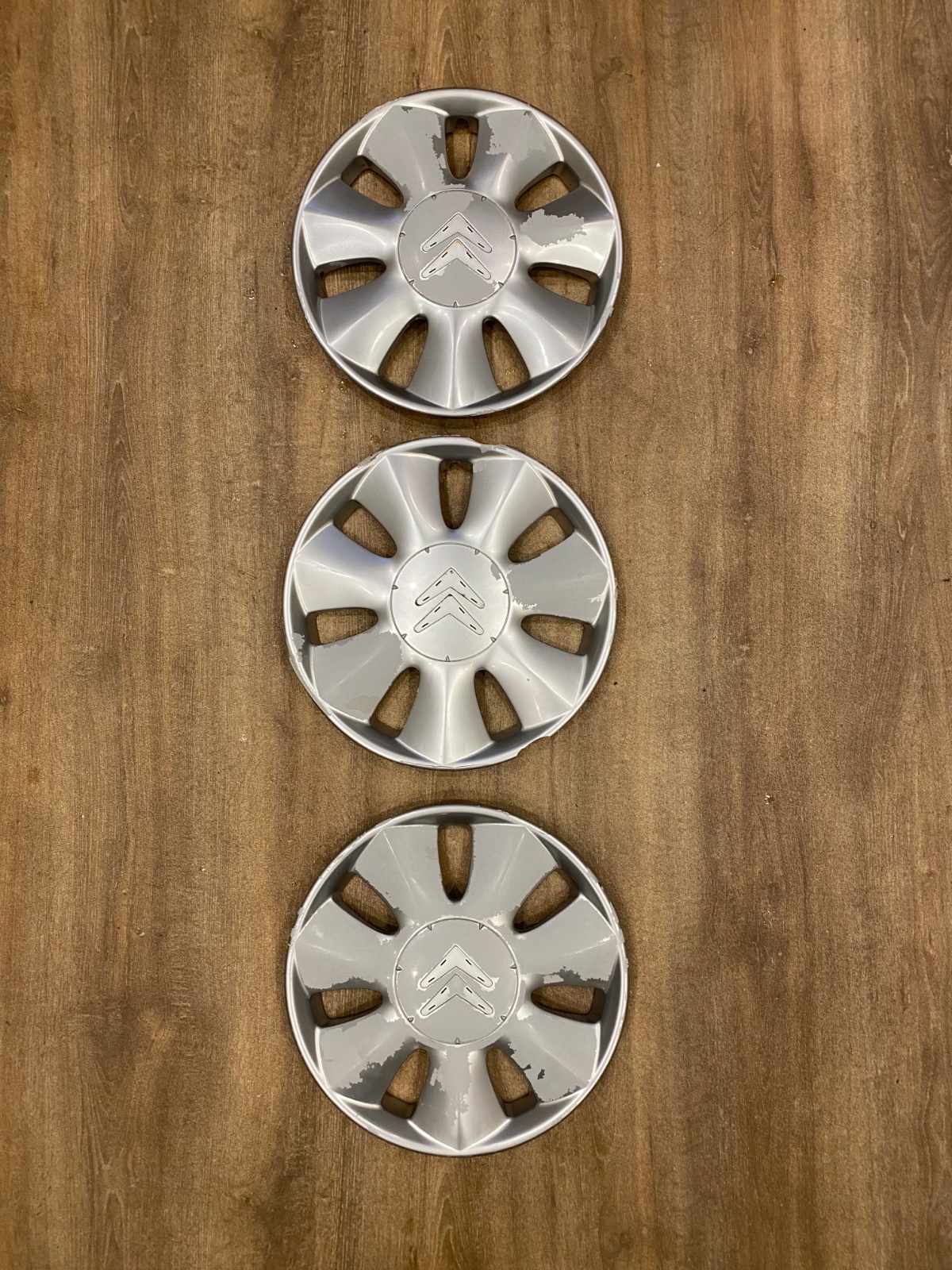

I managed to pick up a brand new Edelweiss wheel trim for it last week too so that will be used to colour match the wheel trim colour.
Refurbishment of one of the other three in particular will be interesting. Errr! Shoukd that read challenging? Removing one to take the wheel off for the sill welding did not got well and it occasioned a fair amount of cracks and damage. It is the middle one in the photo.
So this afternoon, I jetwashed them, treated them to a snow foam and then scrubbed them with Autoglym Magma to remove all the rust marks and fallout. What a GREAT JOB that stuff does.
Unfortunately the jetwashing removed a good amount of original trim paint but if it wasn't that well adhered it surely deserved to come off.
I'll scotchbrite them and use a plastic filler for the scuffs and grazes. I plan to rebuild the edges that are missing by probably cutting bits out of a redundant wheel trim and welding them in thougb i think the spare S1 trims I have are only 14" so I may well have to find another donor for some PA66-MD15 material.
I may well try and jetwash off the remaining paint as I am not sure the paint edges that NOW exist will feather on easily and a DA is too big.
I am not entirely sure how I am going to handle the missing Chevrons. I have put an advert in the Free, For Sale and Wanted section.
