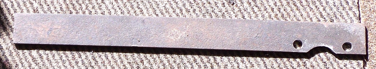

x 2938
Re: Help - I've messed up...
This is my anti rotation tool, knocked it up years ago and it's done a lot of work but now redundant.
