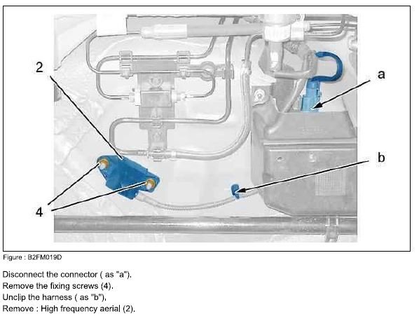

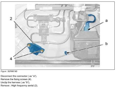

Re: C5 (X7) Pyramid shaped sensor under floor near exhaust?
I win \:D/
It's an HF aerial for under inflation detection.
HF Rx
HF Rx

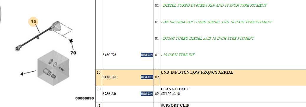

How strange - the workshop manual PDFs have it as an HF aerial, the parts manual has it as a LF aerial. Perhaps it's medium wave :lol:

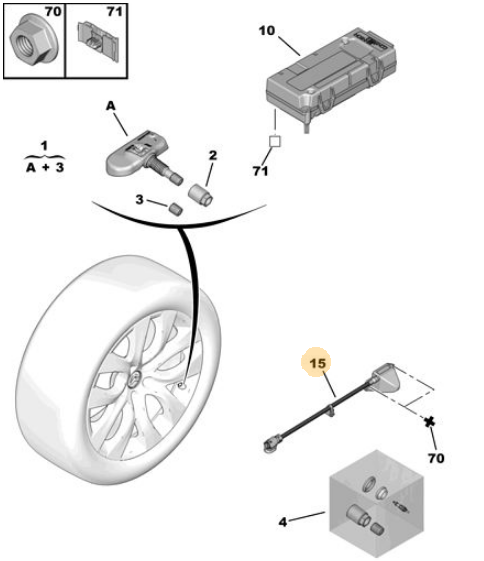

Graeme M
x 6956
No, spot in, it's the LOW frequency aerial for the TPMS, there are 2 different systems on the X7, but for vehicles fitted with this particular system you can see the component that I've marked at (15):
