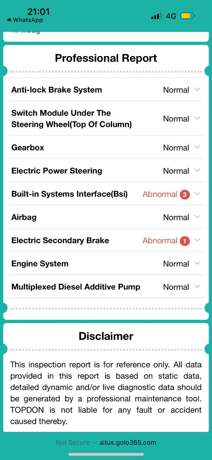

Alan, in your pics the code is coming up in the handbrake. Are there any codes in the ABS ECU? If not, I'd be leaning towards there being a fault in the handbrake unit.

This was the rest of the report I done yesterday… no other codes in any areas apart from a couple of bulbs which I’ve now replaced and something with the stereo..

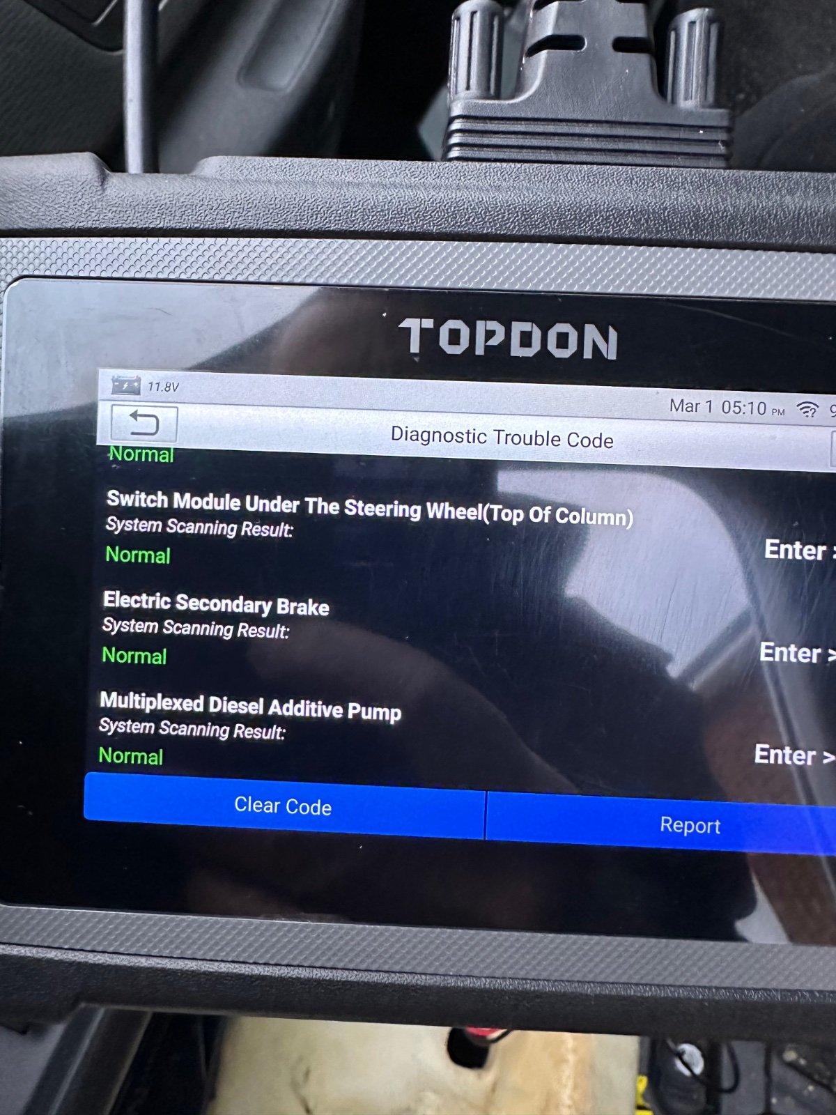

Evening all…. Been a few days so thought I’d update… before digging through all the wiring diagrams and other components I thought I’d change the actual handbrake motor/ecu and see what happens….
The pic was the result
