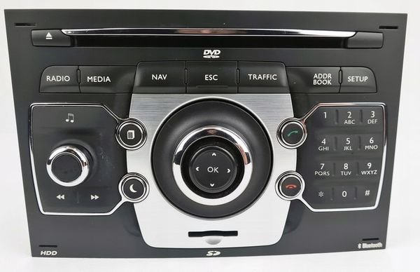

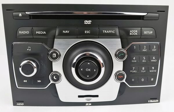

The RCZ ones will NOT work on a Citroen. They have a different fascia with different controls on, not compatible with Citroen vehicles.

Yes, no worries, the NG4 for the RCZ is a different unit as it has that combo fascia with integrated controls, that the other Citroen ones don't, so best to be sure and stick with the correct one for the vehicle.

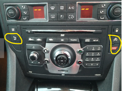

Ah, you mean the phone Peugeot, parking sensor and SOS buttons that the Citroen does not have on its NG4.

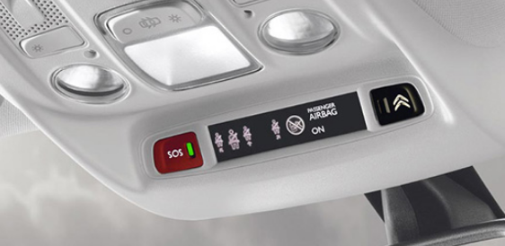

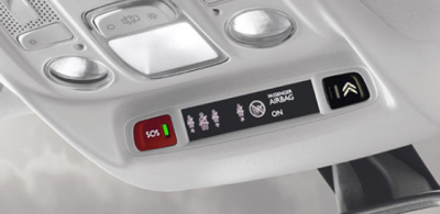

Yes, SOS and Service call are in the roof console on some models and on the C5 X7 for example are on the central console with other buttons in separate banks.

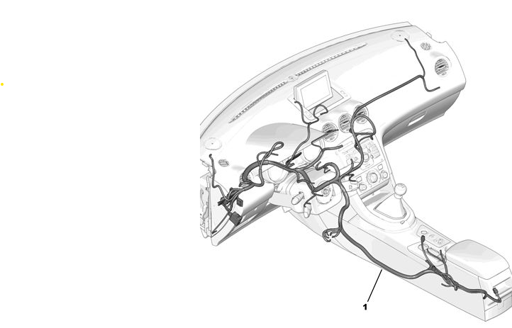

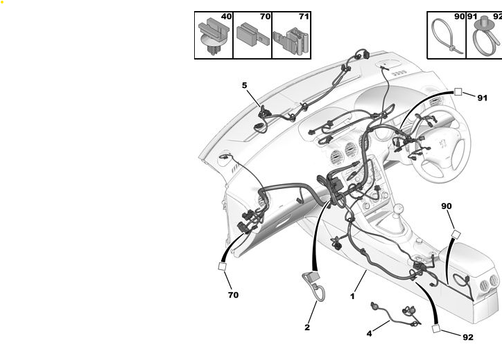

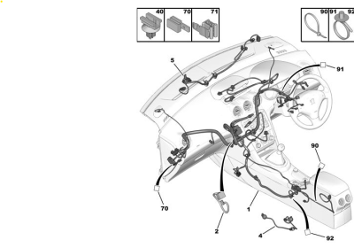

Yes totally different.
Put it this way, on the RCZ central harness alone, for example, there are 18 variations (separate part numbers) for this one harness.
RCZ Central Harness 308 Central Harness

All pinned differently into the back of the NG4, so they must have made separate NG4's for each sperate car config, flippin heck, So the RCZ is a non fit as well then, lets hope it behaves then other wise it will be off on holibobs to the Netherlands
