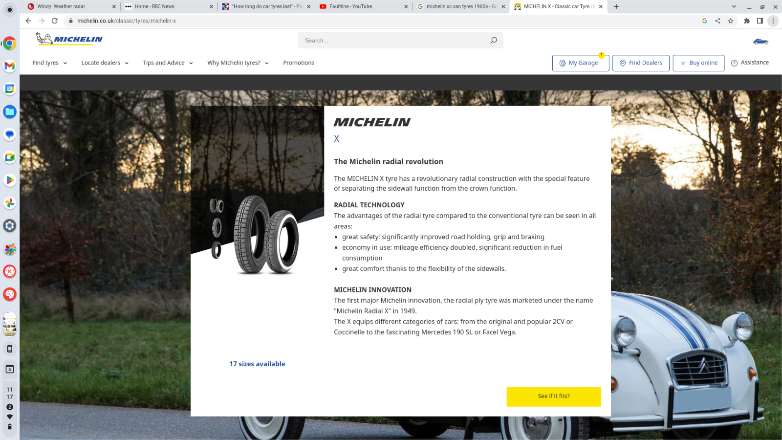

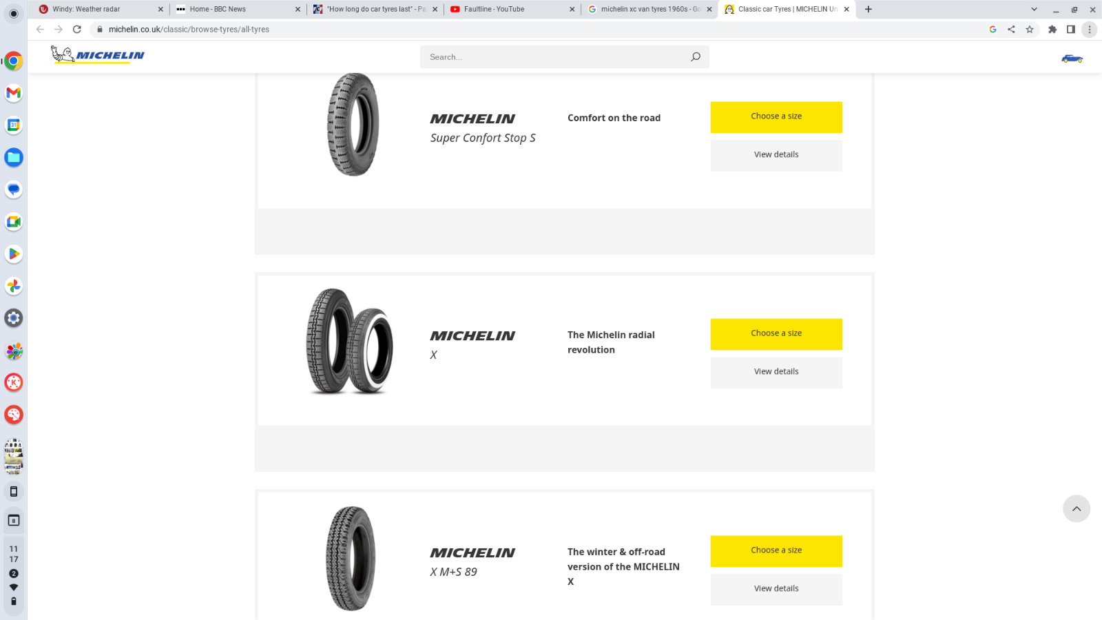

For those of you who have never seen a Michelin X for real, here is Michelin's current vintage tyre offers.
The X was rounded across the tread even when inflated and had "soft" compliant sidewalls which flattened the tread on the road surface a bit, increasing the contact patch. In many ways a revolution in tyres when it was introduced and had many of the modern features like sipes that we see today but flawed in that it was designed for cars that did not have the performance that came over the next decade or so.
The Pirelli Cinturato which followed it started to address these flaws and it has all led to the modern Radial Tyre as we know it.
https://en.wikipedia.org/wiki/Pirelli_Cinturato
https://www.alfaworkshop.co.uk/alfa_rom ... yres.shtml
You will notice the flatter tread profile compared to the Michelin X.
