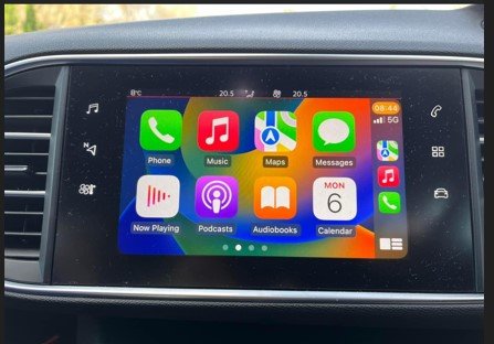

Re: Android Auto option 'missing' from C3 2017 Wave 2.1 RCC
Hi Marc
Sorry I may not of explained my self very well, my fault. The car does already have the RCC installed, so going from my VIN it did have the SMEG+ and someone has changed it. I can use Apple car play, The version that is installed though is -
The details I have
HMI version: 21.616.53.17.00
IMX version: x01011185_171122_16.1B116
V850 version: W2.1_16. 1S723
It would also explain why I cannot update via the my pug app. I would upload some photos but not sure how to
The details I have

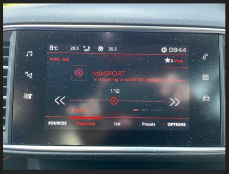

Thank you!! These were taken from my car.
If I could have the links that would be great, I guess the car can only say no.
Also, sometimes the car will come on with no sound coming from the speakers, reading other GTI forums this is/was a common problem and all that needed to happen was a software update to amp, is this something I could do?
Thank you
