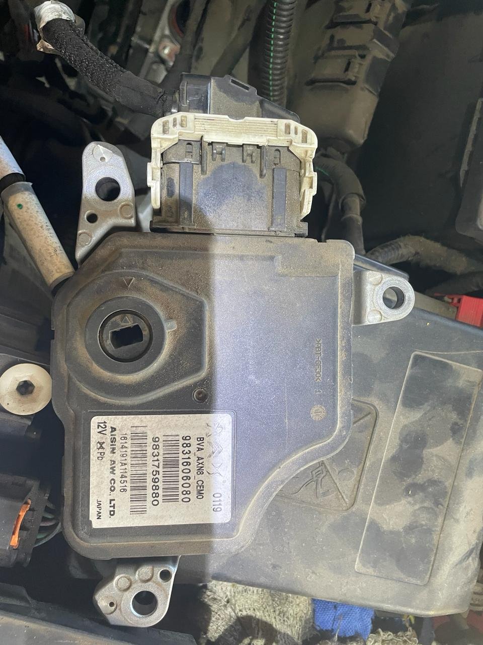

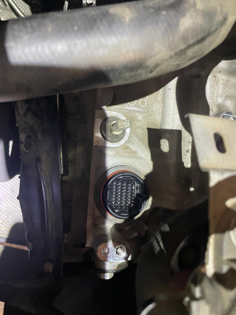

I disassembled the gearbox ECU, everything seems to be normal, I'll look at the pins now.

That looks totally different to the unit on my van.

Hello, I couldn't find anything abnormal on the pins of the gearbox Ecu. About the brake switch, if the rear brake light works well, could it be bad?

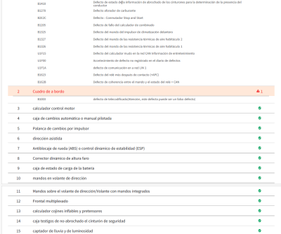

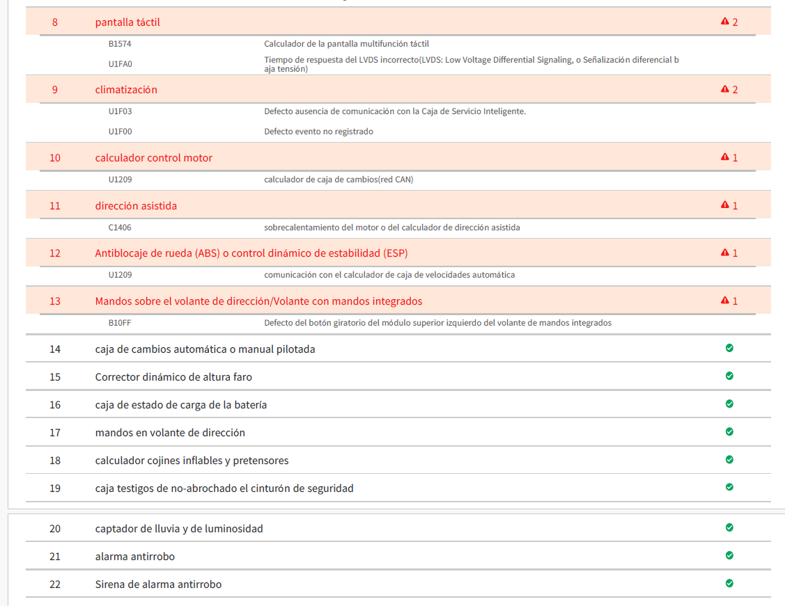

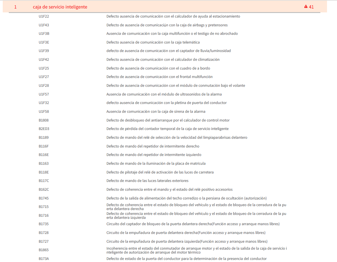

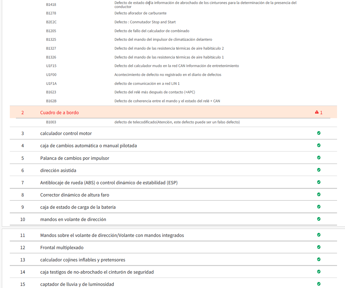

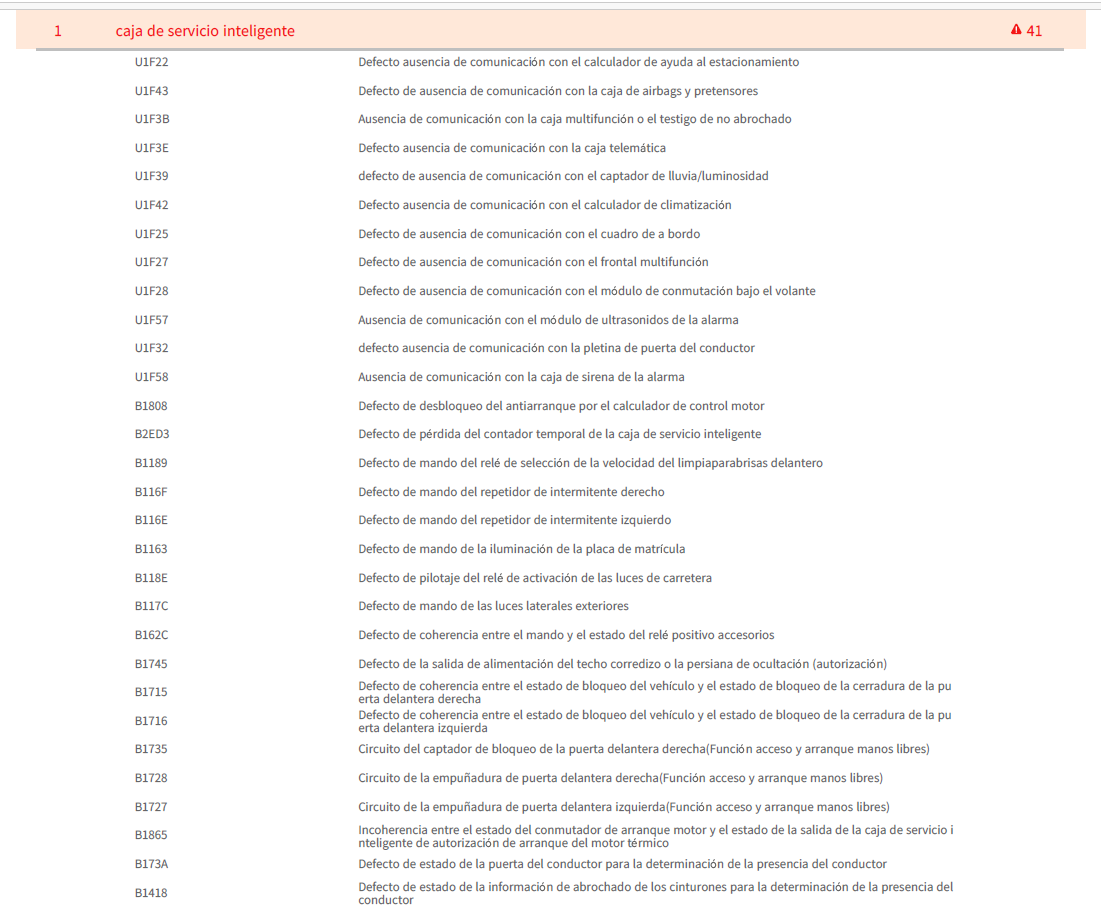

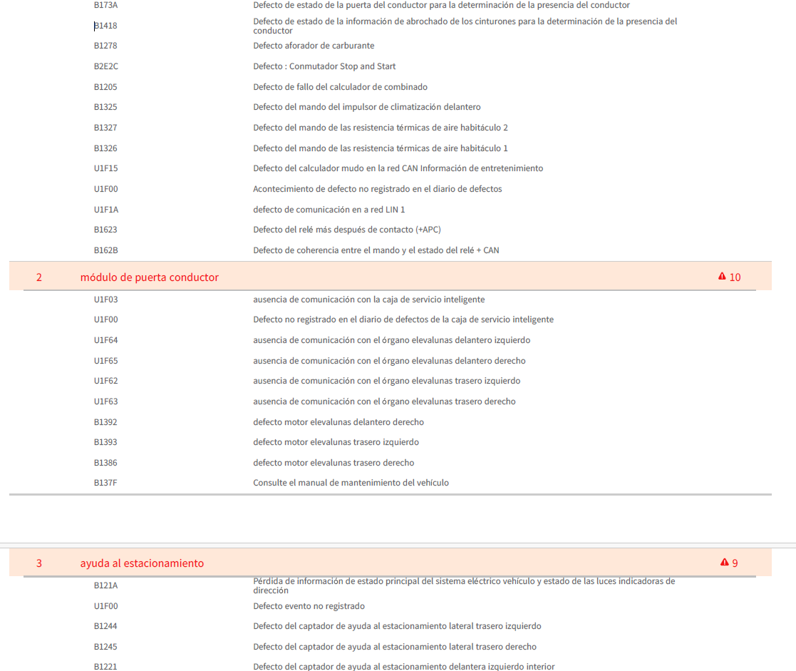

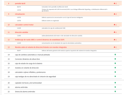

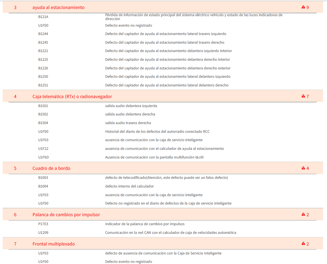

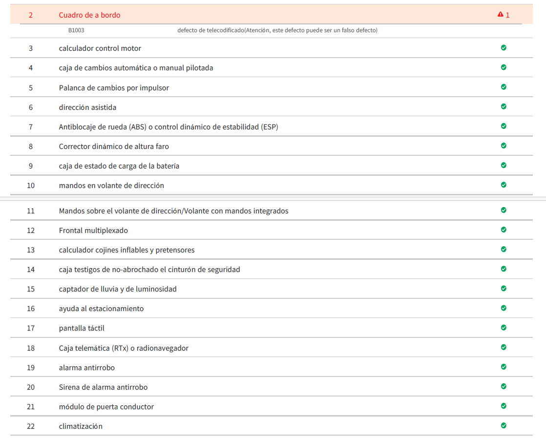

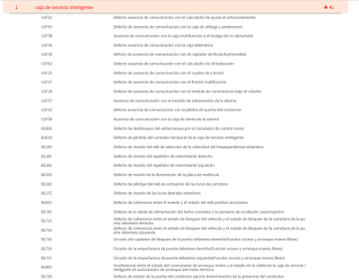

Hello, here are the scan results (Not Alexia).
Errors before cleaning:
Errors after cleaning (Permanent):
