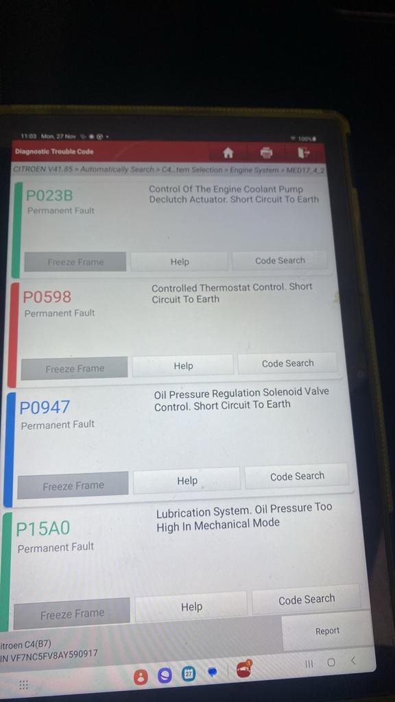

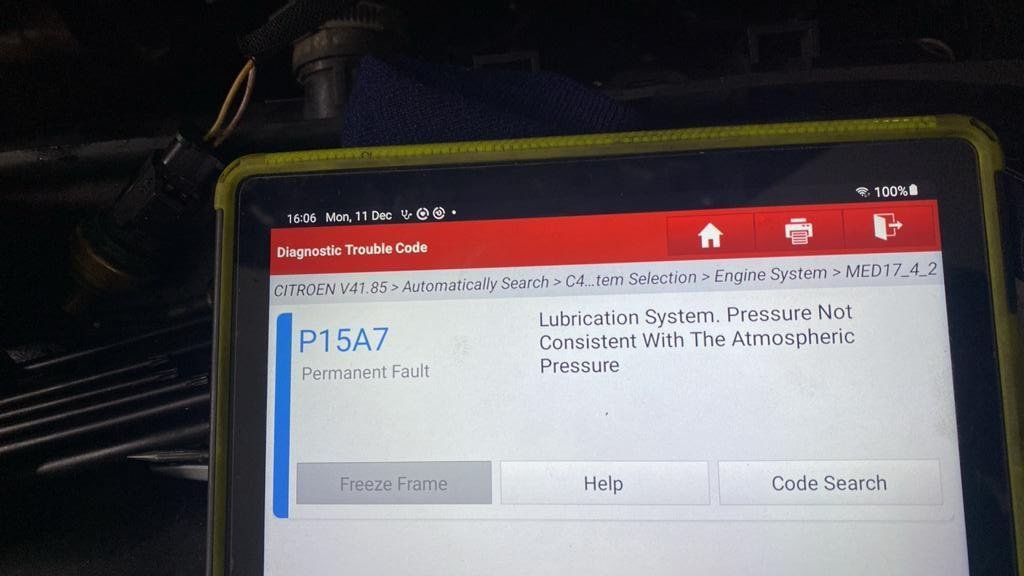

Please help a have problem with my Citroen C4 1.6 thp 156ps
This is the code problem , and a have high pressure oil

For all of those codes to arrive at once, I would be looking for a blown fuse, or maybe a corroded connection, maybe in the engine bay fuse box.
Try erasing the fault codes and see which ones come back immediately.

xantia_v6 wrote: 11 Dec 2023, 22:59 For all of those codes to arrive at once, I would be looking for a blown fuse, or maybe a corroded connection, maybe in the engine bay fuse box.
It did that and it still returns errors
