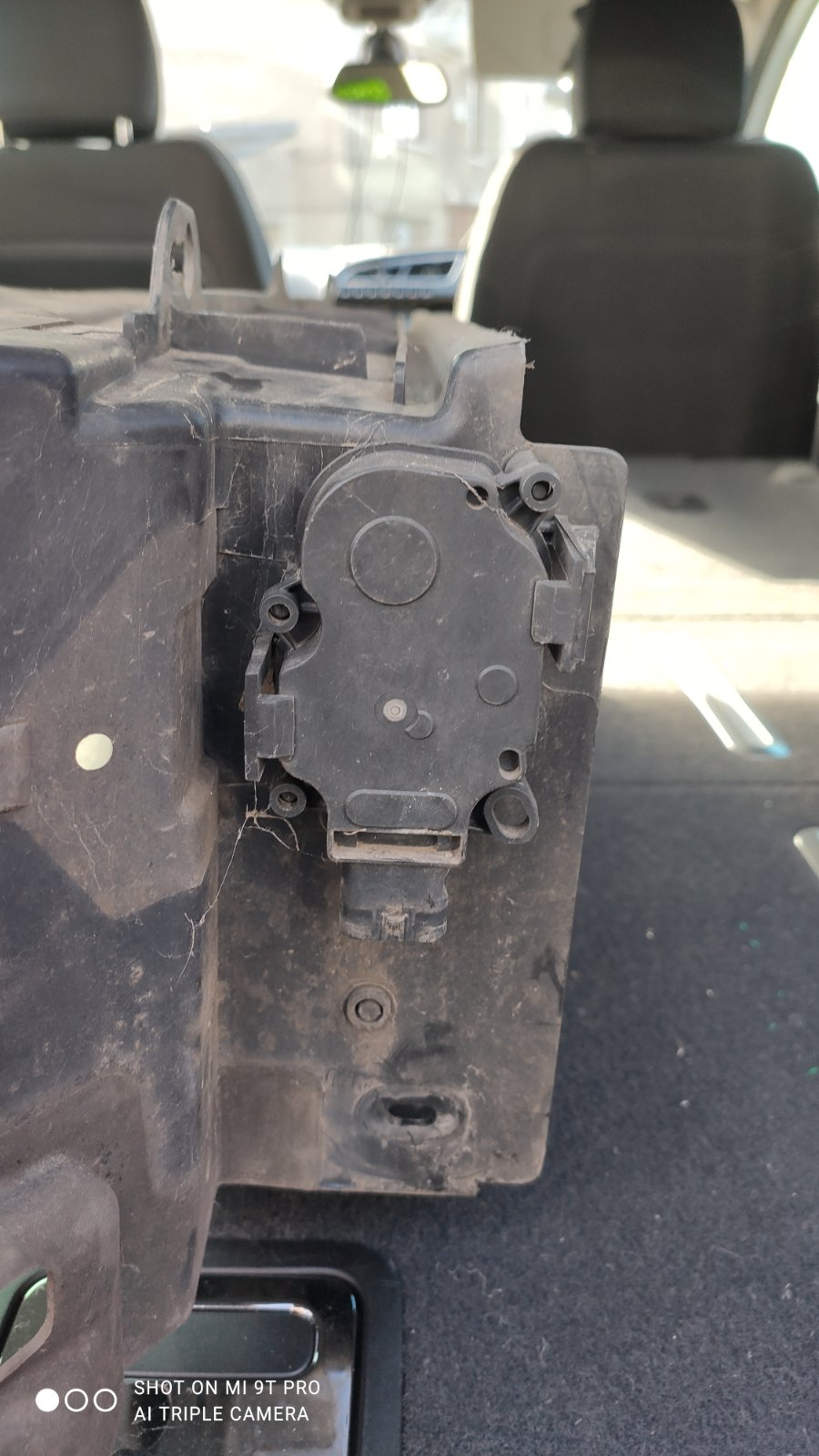

This shutter arrangement is in the nose of the bumper and regulates air flow over the bottom of the radiator and the other rads/coolers. The flaps are operated by a solenoid block on the end. You can see the corrosion in the connector shield which is right at the front of the bumper inlet. The plug terminals were equally corroded and water was obviously being held in the connection as it had water in it when dismantled. This ties in with my wife's description of events upto where and when the first warning light came on. She was travelling behind a lorry in atrocious weather on salted roads in a plume of spray for many miles. The plug was not available from Peugeot but turned out to be a standard VW plug which is freely available. Nice one, Peugeot - NOT!

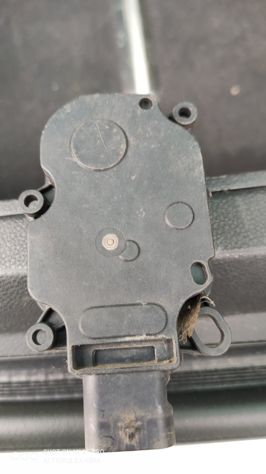

Ever had that sinking feeling that your wallet is £300 lighter than it needs to be? I dismantled the shutter assembly this morning and I discovered that the stepper motor drive is a Sonceboz (Bosch) unit. The main shutter part works perfectly with no obvious wear and is free to move with your fingers. I have tried a quick google of the numbers but haven't tracked it down yet. It simply clips in place so it is a serviceable part. I was only given the option of buying the whole assembly but looking at it now I reckon it is a pretty standard part and should be available on it's own. I have just come back from a test run via Methil Docks Hydrogen Office. Will update this as I find out more.

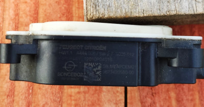

The markings aren't that clear so here is a written version -
PEUGEOT CITROEN
HW1 1 A444 006 / SW 27 S005 012
6460H440 (?) 12010P04516
SB MEAPCEM01
9673420580 00
I think most of it is correct except maybe the 646 bit
Oh and I think the circle mark might be an Opel badge
time to play hunt the stepper motor

Hi again. The large chunk of plastic is called a "controlled air intake Module". I have still no idea why it has thrown up the codes it has and it was a ****** to track. Eventually found it through an anomaly in the LIN network. A proper wiring diagram for my model would have helped so if you can track one down in your "spare time" I would still like it. I suspect the Airbag faults will creep back - just a feeling! Battery voltage (service) has settled around 12.5 volts if it is left for any time and charges at 14.6 downwards when put into "Ready", The car drives well and everything including the air con, gear selection, traction battery, sat nav and radio traffic announcements all work as they should. I am planning a shroud and some Vaseline for the plug connector when I am fitter. My knee and now my ankle are still giving me grief but, once they are ok, I plan some preventative waterproofing. Will update this thread over the coming weeks. Cheers.lorddevereux wrote: 27 May 2021, 15:51 That's one mad piece of design - I didn't know that feature existed! On my C5 of a similar vintage, there is a note in the handbook that says "when towing heavy loads, remove X piece of plastic cover from behind the lower grille to assist engine cooling". I can attest, that this piece of advice is redundant in the UK![]()

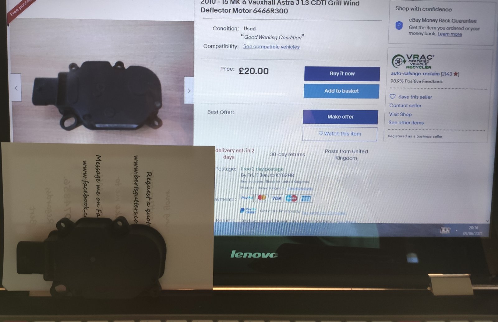

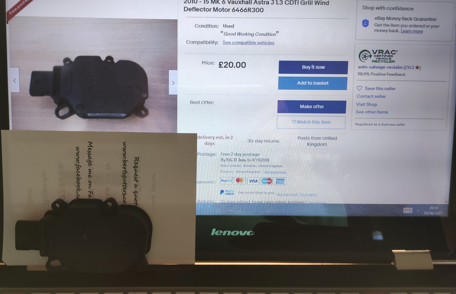

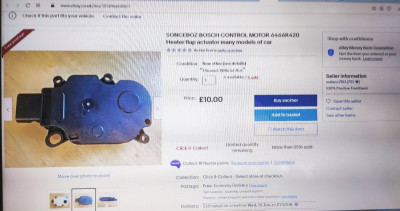

Breaking News. Sonceboz actuator motor tracked down,
And the assessment that I was £300 lighter in the wallet! Yes, I was pretty much spot on. FECK!

I just found several listings for that SB MEAPCEM01 by googling it.
You got there too!
The potential PSA numbers 6460H4 or 6460H440 don't come up with anything relevant (just a hose on C5).
You got there too!
