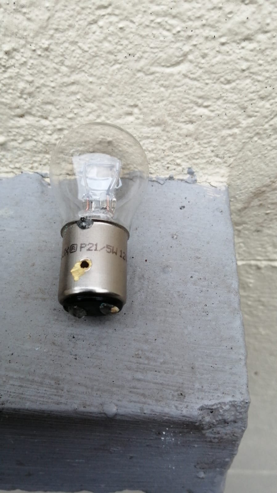

You will not believe what it was on both sides. It must be cheap bulbs. Both bulbs worked when tested outside of the car and visibly looked ok when tested a few days ago. Tested with negative from battery to casing and positive to base.
But both bulbs had one of their studs hanging off/loose and were not sitting correctly in the receptacle. Not visibly but obviously enough to stop the connection. I suspect the studs were hanging off and were not quite sheared off but today I twisted the bulbs and they flashed on and off. I twisted them in frustration as to what was the issue. When both were taken out they had a stud on each side missing. My twisting sheared them off completely. When I did the test on the battery I suspect the studs were there as you would have noticed one missing but they must have been loose and about to go. Never seen that before so I assume badly made bulbs.

Well done for persevering with it. It won't be the first time something like this has happened. I wonder if the wrong bulbs were put in - some have offset studs that could of been the wrong fitting and subsequently snapped off leaving it anchored in at an angle - but at least you know now.

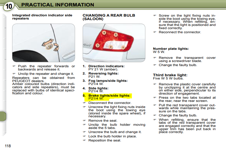

They're not the right bulbs as it happens - they should be P21 / 4W not 5W according to the handbook.

Re: Peugeot 407 Hdi 2.0 2009 Brake Lights not working ABS/ESR er
I dont trust any of the bulbs now. Is it the owners handbook? I want to ensure I have all correct bulbs. Is there a list anywhere?
- x 6945
Yep - Here:
