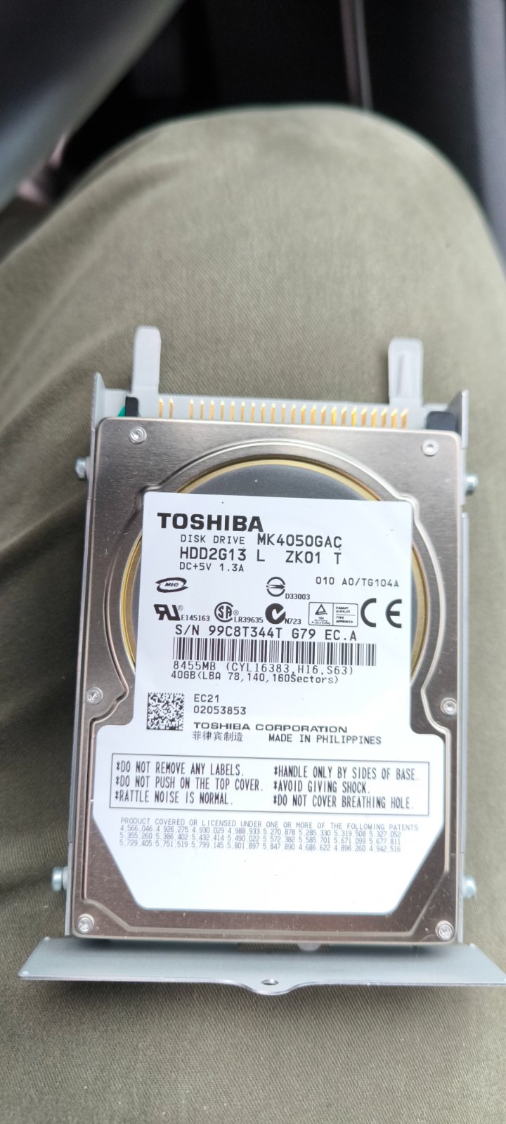

If it's understand you correctly, you still get no sound, with the HDD removed from the unit?
If that's correct, then it's no use to buy an other, because there's a other problem with the hardware, maybe the EPROM.

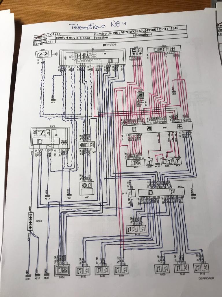

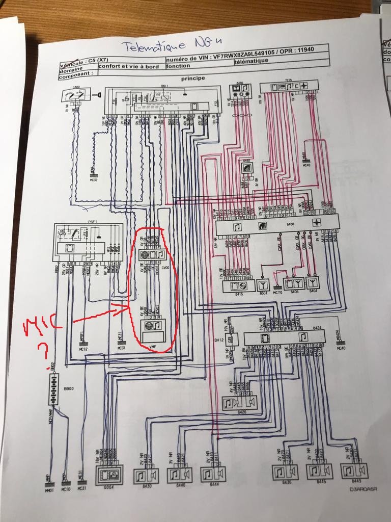

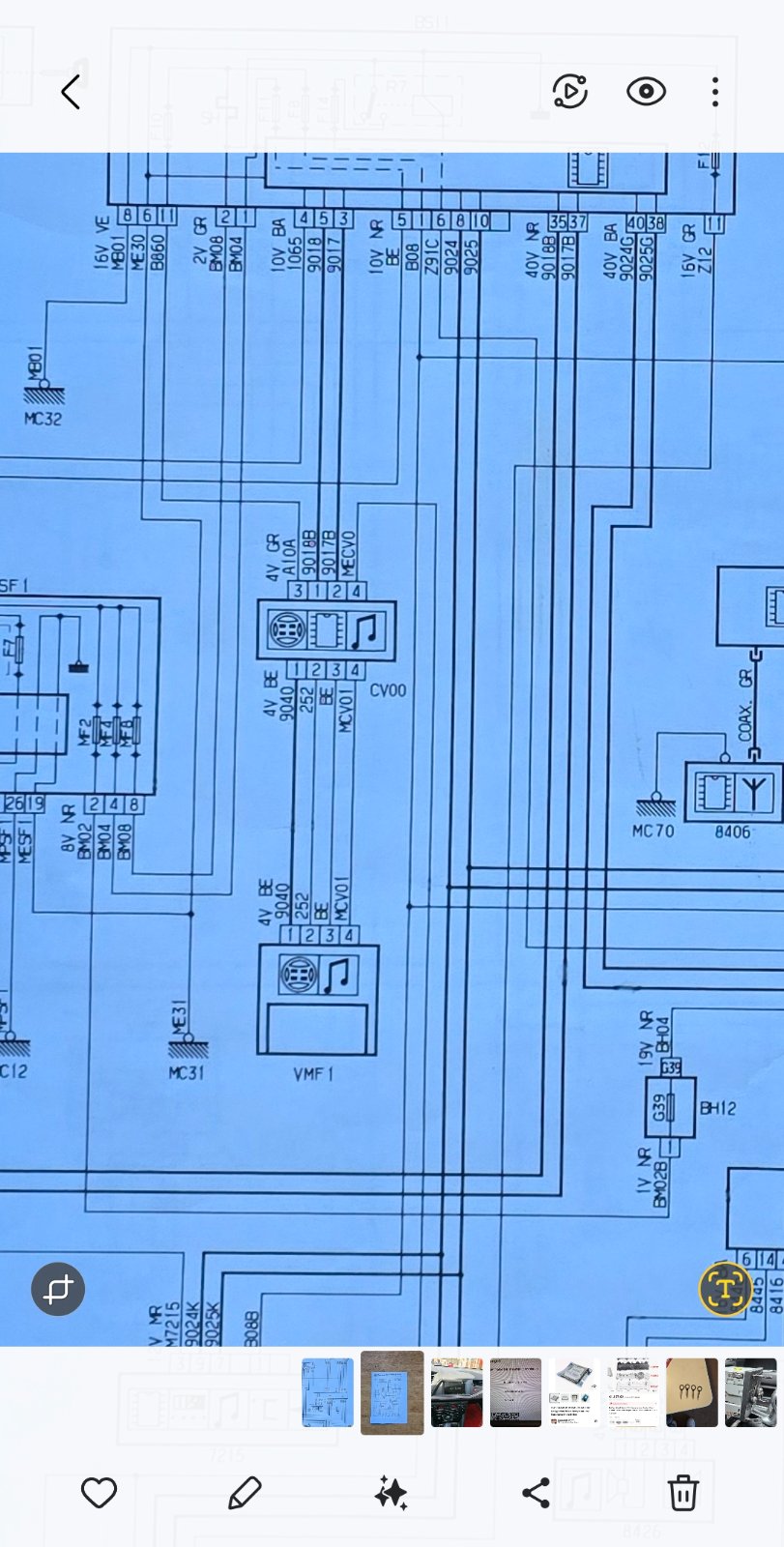

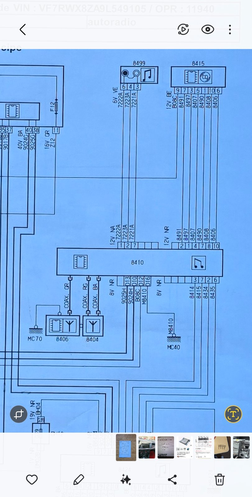

Kees wrote: 23 Apr 2025, 21:08 Here you see the connections between the NG4 and the amplifier.
do you know where the microphone is connected to?
slibby
Posts: 23
Joined: 21 Apr 2025, 16:06
Re: CD Changer fonction on the WIPCOM3D / NG4 - Peugeot RCZ
Unread post by slibby »

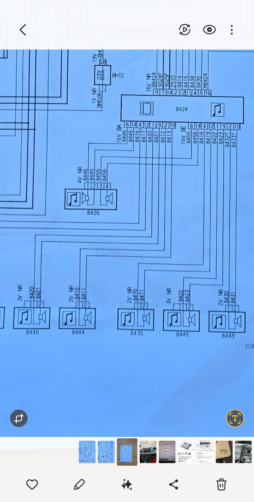

possible to have the file in HD? I can't read the numbers on connectors and wired
