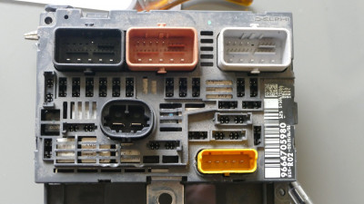

Fuse box strip down
Has anyone managed to remove cover of a 2008 C5 and split the two halves of the fuse box to check and clean the wiring. (see photo)
I have removed all the fuses and bypassed the 6 latches on the edge but the cover seems solid, seems the sensible thing to do before paying out £185.
Cheers
Cheers
- x 6945
Re: Fuse box strip down
These are not supposed to be user serviceable items Barry and more damage could be done if you were to break it apart, as I think these are bonded units.
There are internal relays and components that can become faulty, so unless you're a pretty skilled in electronic circuits, I'd leave well alone. These have been known to catch on fire too to, so be wary if dismantling with the intention of replacing it on the car.
BKS
- (Donor 2021)
- Posts: 45
- Joined: 07 Jan 2021, 16:23
Thanks again Marc, looks like I just have to bite the bullet.
If you're definitely going to replace with new you'll lose nothing except your time to take a peek inside.
I know I would...
I know I would...
Tempting, It would be good to find something wrong, but it is solid and would never go back together again, they usually make sure you can't service unserviceable units.
That looks like a CAN BUS BSM. The CAN BUS BSM's were (are) potted. That is, the circuit boards are conformally coated in RTV. Meaning, even if you did get the two halves apart you would be confronted with a huge blob of RTV! The VAN BUS BSM's only had a lacquer coating on the board(s).
The major failures in PSA BSM's are the crap relays the contractors use. Most other manufacturers use plug in relays, knowing they are a potential failure point.

Thanks' ozvtr, it's reassuring to know so many on this Forum are ready to condemn this fuse box, it will make it less painful buying a replacement, although I will still have my fingers crossed.
Sounds like there are plenty of variants, I am waiting for the supplier to cross reference the Part Number with the car Vin number before handing over £185
