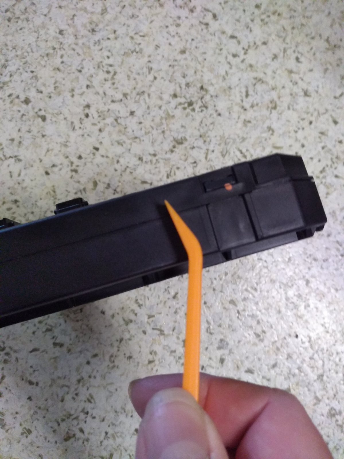

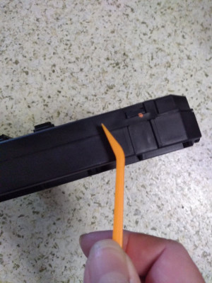

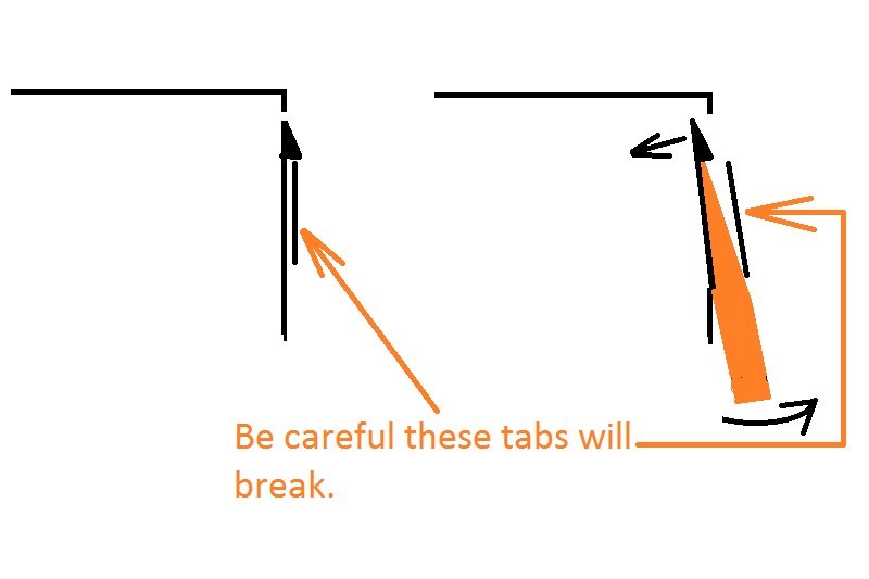

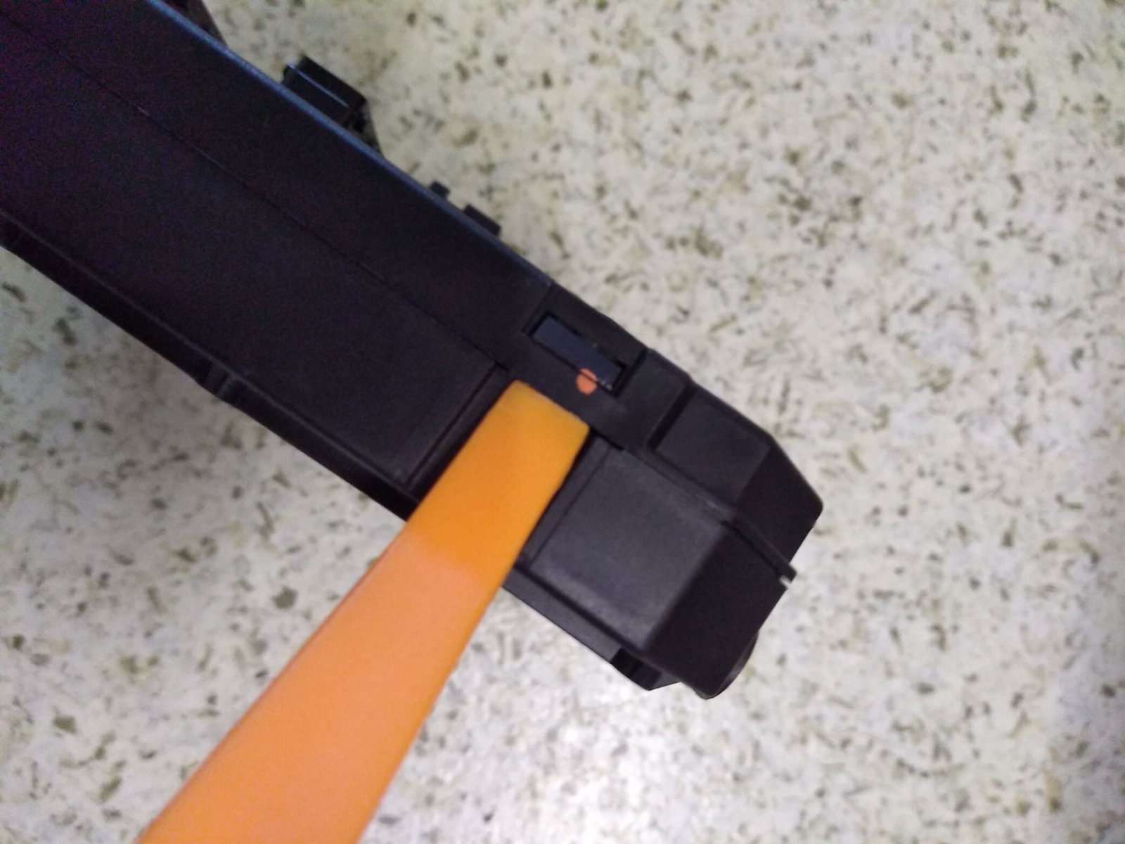

The photos are the tabs for a BSI but the BSM (PSF) is similar.
Use a sharp knife and cut through any labels along the separation line of the upper and bottom halves.
I have a tool from a door panel removal kit that does this job. A screwdriver will work but some thing sharp is better.
Be careful, the tabs can be easily broken.
Unfortunately yours is a MK2 and the upper part of the BSM is potted in a resin. So there isn't much you can do with it.

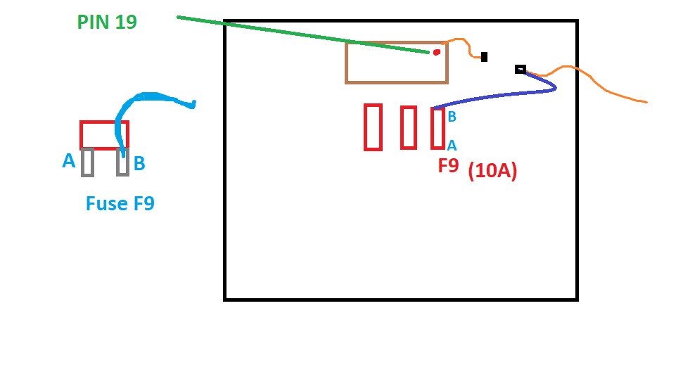

Took the fuse box out today, tried opening was close to smashing it with hammer at one point, so didn't bother - they do not like to be opened, one side felt glued down.
Instead I have done a temporary fix until new (used) fuse board arrives.
I have cut the Orange cable going to PIN 19 on the Brown 28 Way connector and connected this to the wire I soldered on to Fuse F9 to bypass the connector
Started the car up, ZERO problems (other than a coolant problem which has only been present since mechanic replaced steering rack, which I'll start new thread for)
Wiped codes in Lexia, only faults showing now are radio related (because an aftermarket one is in)
Thank you to Ozvtr, Wheeler and GiveMeABReak
I checked for continuity between various pins and the fuse holders (I removed all fuses), they all seemed to be connected at top of fuses. I took the Fuse F9 (10A) and soldered a wire to the top side (pin closest to the connectors at back of fuse board).

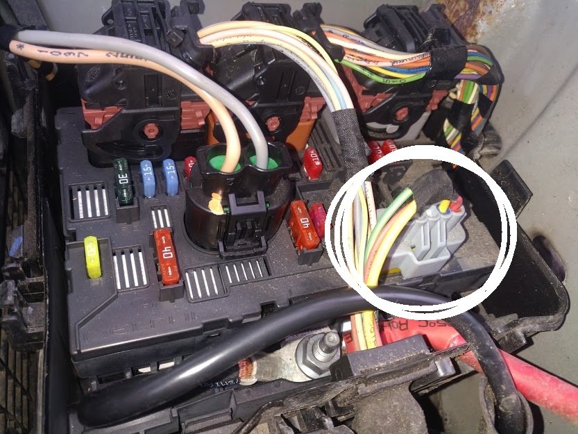

Just bringing this back up
After finding information online about many PSA cars having a water ingress problem in the fuse box (PSF1), is there any sort of recall for this fault?
Replacing the engine bay fuse board but surely this problem will keep occurring if it is happening from some sort of capillary action.
