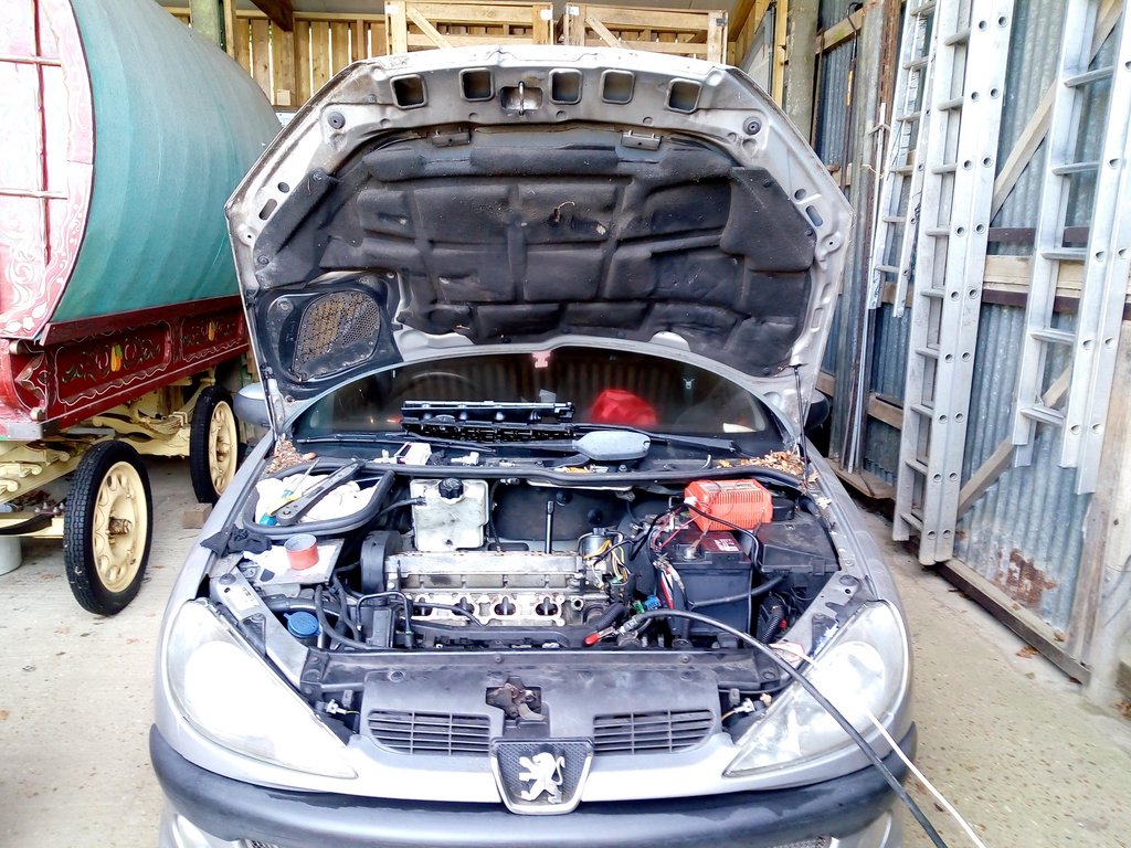

tonights job was removing the removing inlet manifold. all 8 valves are shutting and opening ok.
I wonder if I can do a leak down test with bit and bobs lying around, just for fun.. will have a think about that..
otherwise, no other news :-D

the poor thing .. can anyone tell me if they can or cant see the image?

interesting observations..
I left oil in 6 inlet ports from Thursday evening. 5 still had oil in them this morning.
by adding compressed air into any cylinders that are off-cam(s), i can detect bubbling through the oil sitting above the inlet valves, or hear it escaping down the exhaust.. its not very scientific, but air is not staying inside various combustion chambers..
Is Mike's suggestion what actually happened? is it really possible this car got so low on oil, that the hydraulic tappets have messed things up?
If I put all back together, and bump it down the drive (all downhill) may it come back to life?
:shock:
wait - i have that wrong.. Mike said the valves may not open enough to allow compression, i am finding they are not really shutting enough...
