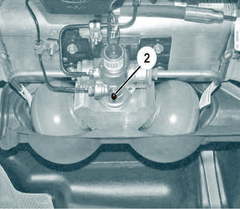

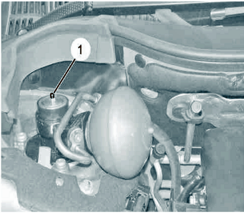

I’ve started to replace the front spheres on my X7 following the procedure posted above by Marc.GiveMeABreak wrote: 30 Jun 2020, 14:56 B) If you don't have a kit, you can manually depressurise the front or rear axles independently, depending on the spheres you are replacing.
Disconnect the battery.
Raise the vehicle and support on axle stands, wheels free.
You will loose fluid, so don't re-use any reclaimed LDS that comes out, so make sure you have sufficient new LDS fluid to hand.
BSI Reset / Battery Disconnect / Reconnect Procedure
I don’t have Lexia so with the suspension set to normal height I’ve loosened the LDS fluid tank cap and jacked up both front wheels so they’re hanging free. The rear wheels are on the ground as normal. Made sure the battery is disconnected.
Put a pipe over the suspension bleed screw at the offside rear of the engine bay and gently released the screw (10mm ring spanner). I’m a bit concerned because literally only a little finger full of fluid has escaped even with the bleed screw loose by a couple of turns (and moving on the threads - ie an indicator that it’s loose). With the cap removed from the LDS reservoir tank I can see fluid about 25mm from the top of the screw cap threads.
Before attempting to remove the first sphere I’m hoping that someone can confirm that this small amount of fluid being released is normal. I was expecting 1/2 litre or so!
Thanks
Steve
Edit: I suppose that providing I remove the bleed screw then there can’t be any pressure remaining?
2013 Citroen C5 Exclusive Tourer, 2.0 HDI Automatic with Techno pack
- x 6958
Re: Rear Left Suspension Bucking
Steve, I would have the car on the lowest suspension height to ensure that the system is not holding pressure in the system before you full loosen the screw. The above procedure was carrying on from the main procedure when using a Lexia to depressurise it. So lower it first to release as much pressure and fluid back into the reservoir as you can before releasing the screw fully.
But before you do that, you may find that before you release the screw, try undoing the sphere slightly (just enough to get it loosen it), then go back and depressurise when you are ready to take the sphere off. A little pressure in the sphere can help loosen it beforehand. They are only supposed to be tightened by hand in any case, but can become tight over time.
