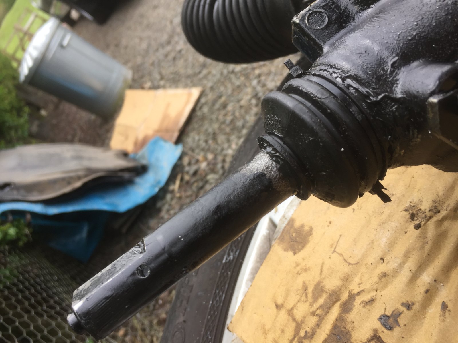

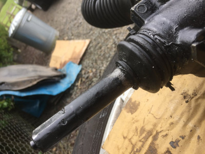

Re: The curse has struck again
Well rack off and it appears it is not leaking from the top pinion seal.
The pipes seemed well sealed and needed a little assistance to come off.
But there was a mixture of water and oil in both track rod boots a lovely off green colour ( definitely NOT LHM fluid) as I know I filled the rack with orange LDS fluid.
Could the seals at both ends showing signs of wear due to the ingress of water. I changed the boots just before the MOT in Jan 2020.
Thoughts please everyone.
Kenny

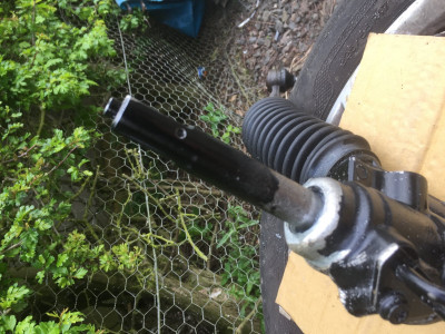

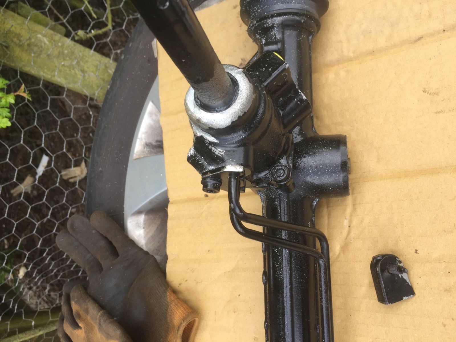

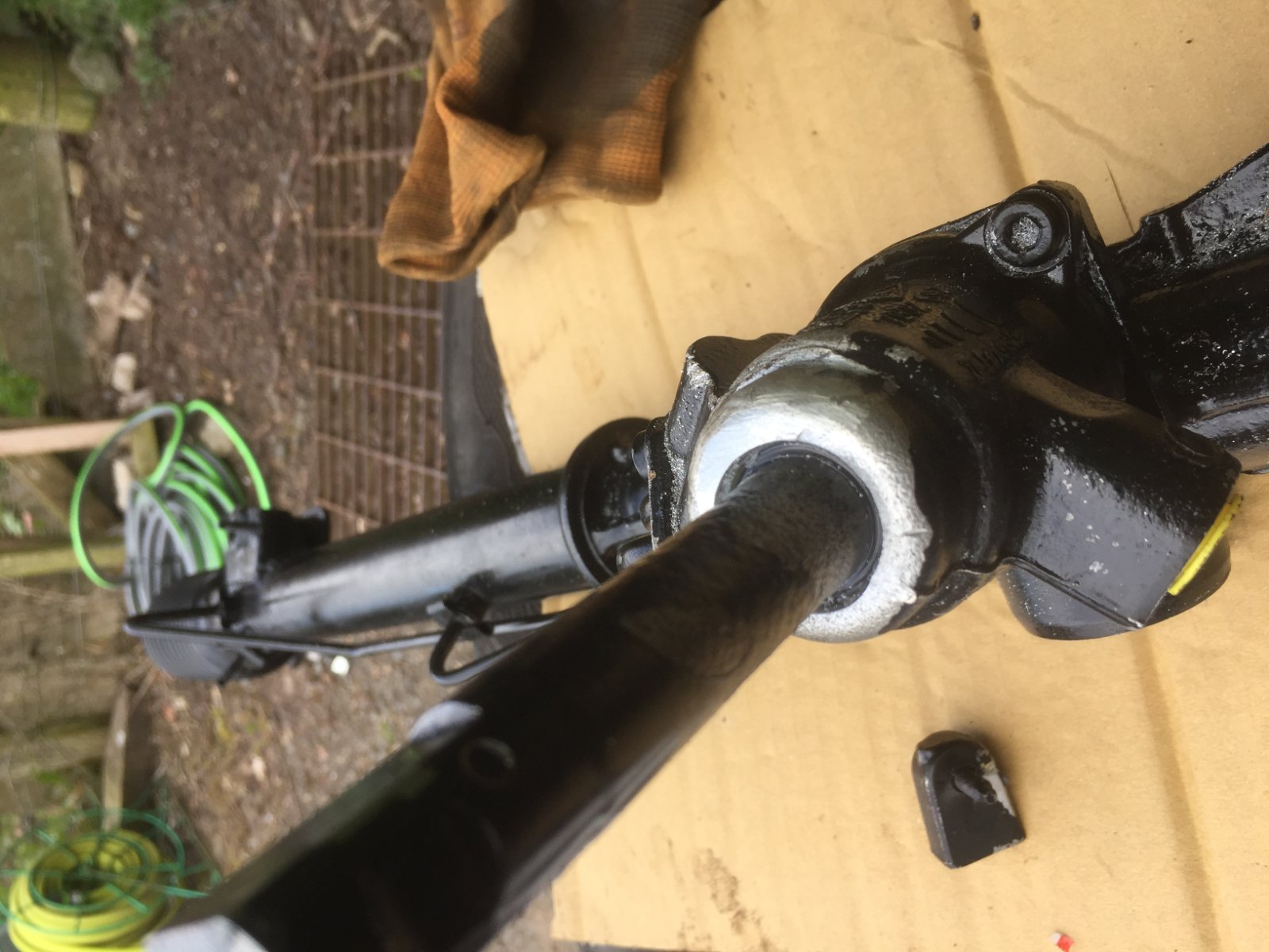

Well collected another rack today from Glasgow Power steering, speaking to one of the mechanics he said they strip down the rack fit all new seals and have the pinion shaft turned down until clean then fit an oversized seal to finish the job.
I have made slightly different mod by removing the small metal bracket attached to the top of the pinion to create a good securing location for a ball joint dust cap.
Here are some photos,
Sorry,the photos are the wrong order and I need to find an original.
Thanks to Chris for borrowing your photos that's the bit I cut off
