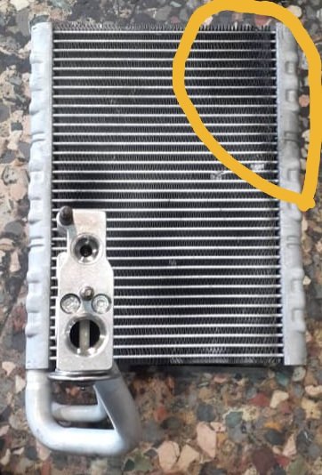

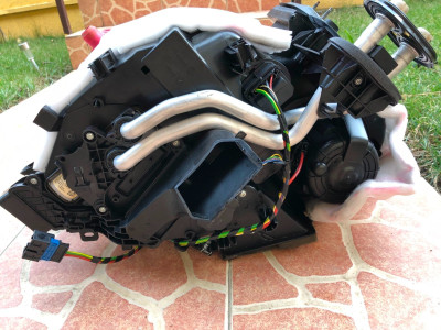

Finally I dismantled the dash and pulled Evaporator out, , As the repairman had diagnosed? leakage is from evaporator. What is it interesting the evaporator of my ds3 is completely different with ds3 (1.2 turbo). I dont know how can I attach the pic to share here.

Click on the "Full Editor & Preview" button, Attachments tab, and go from there.

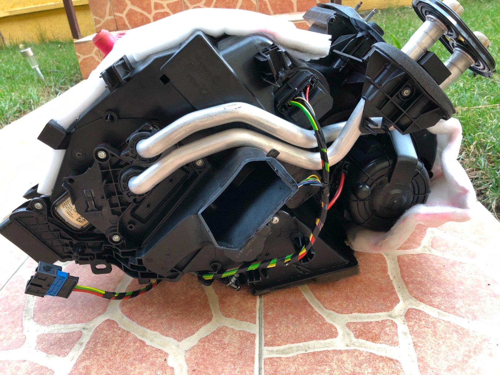

x 6955
Re: Citroen DS3 A/C Evaporator leak
That's not an evaporator, that's the heater matrix.

No, heater matrix is a something like that, but smaller.
Look at the link below
https://eurofrance24.com/catalog/produc ... 30780-0km/
x 6955
Citroen don't sell these separately only the complete evaporator assembly.

It is interesting. I have to assemble something by using tubes of this unit and other PSA evaporator :)

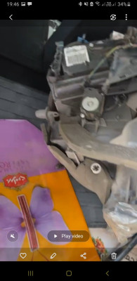

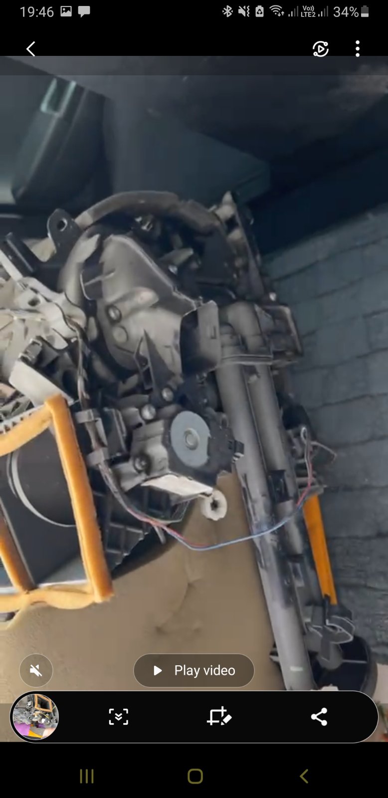

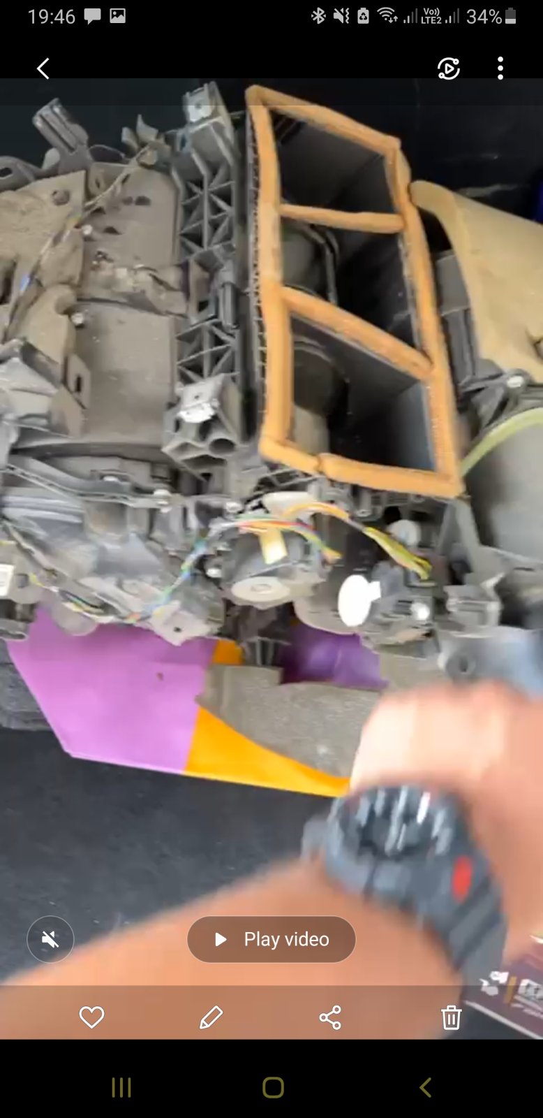

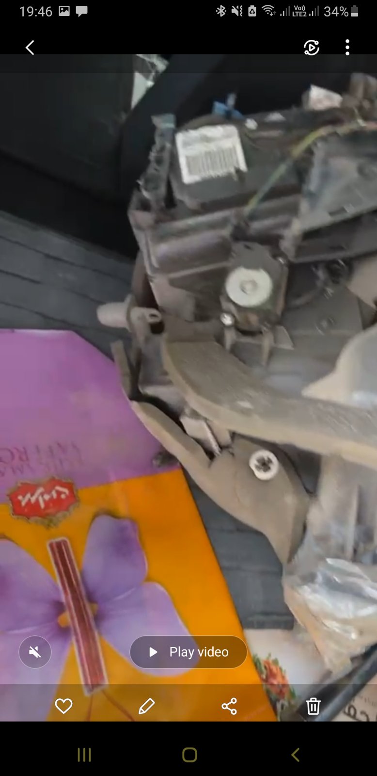

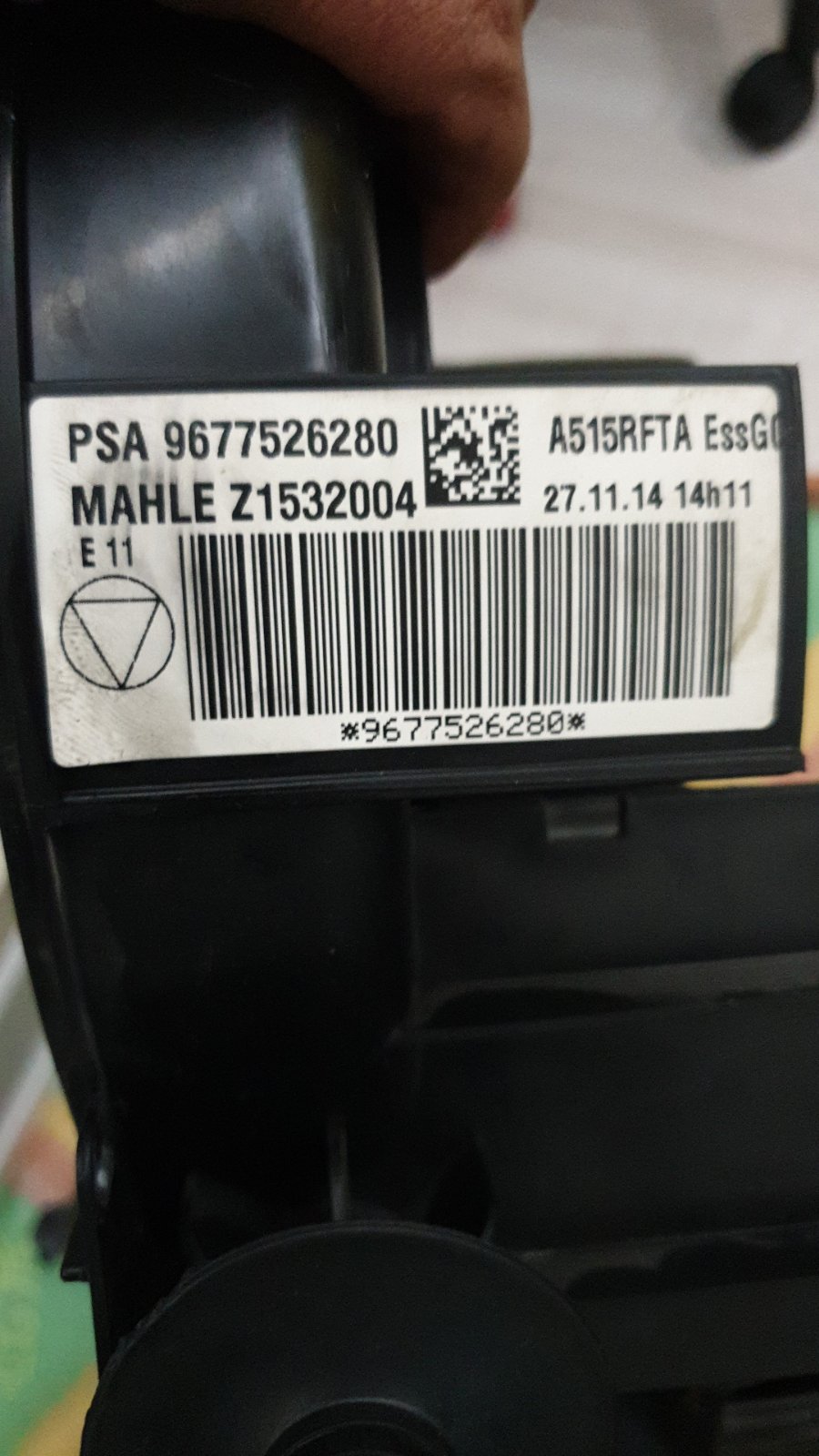

Hello again
I order the unit (heater matrix box) from dubai, they take the unit from some ds3 which is out of services an send me its movie clip, unfortunately it is completely different. Apparently many types of units were installed on ds3 cars.
And also I try to find the exact PSA number, but it is unknown in web.

Anybody can consult me, if is it possible to match this apparatus with my ds?.
For your information my ds3 is So chic model. 2015, 1.6L 120 hp, petrol
My heater box is the same with what was shared in second page of this forum.
