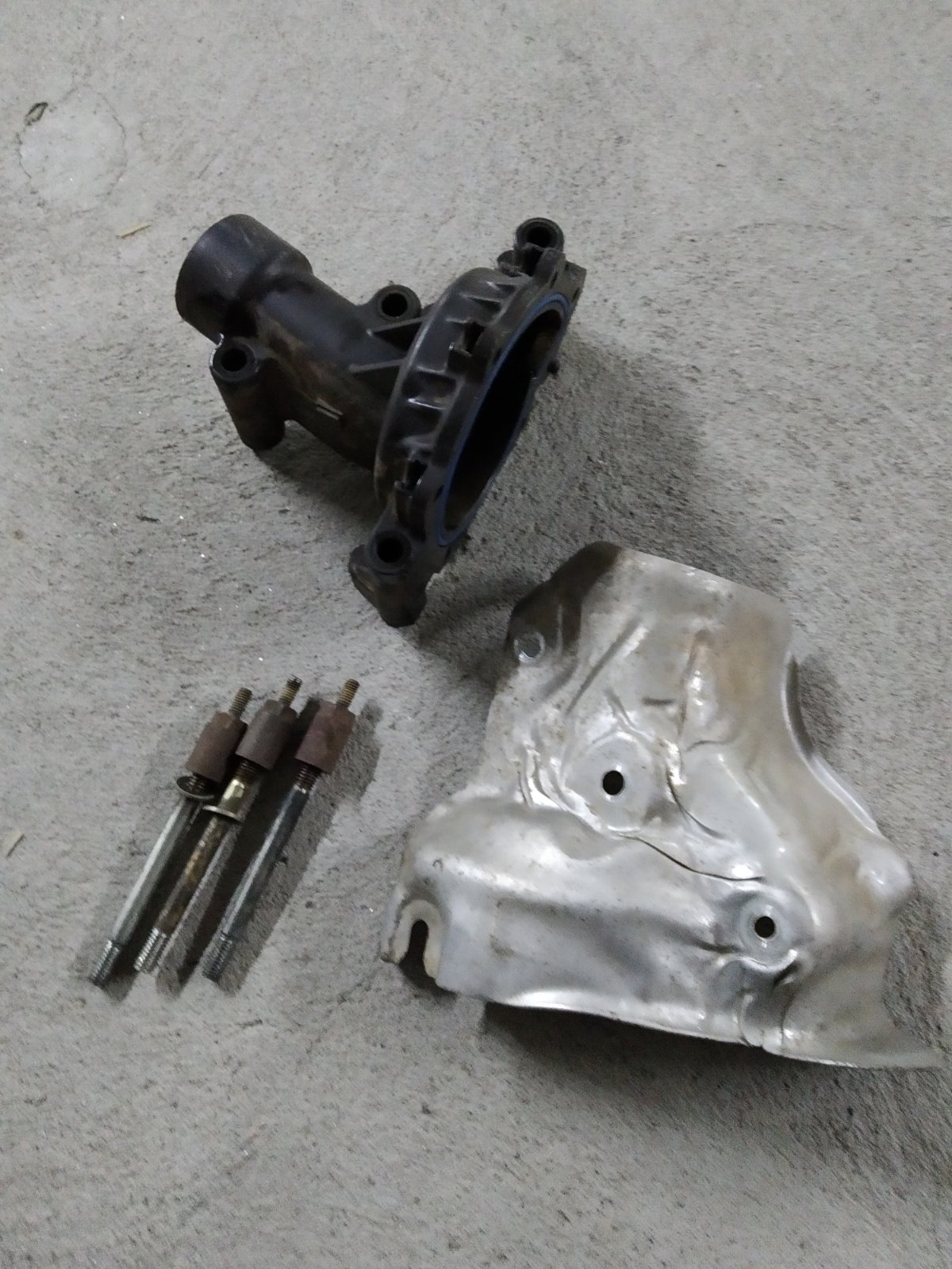

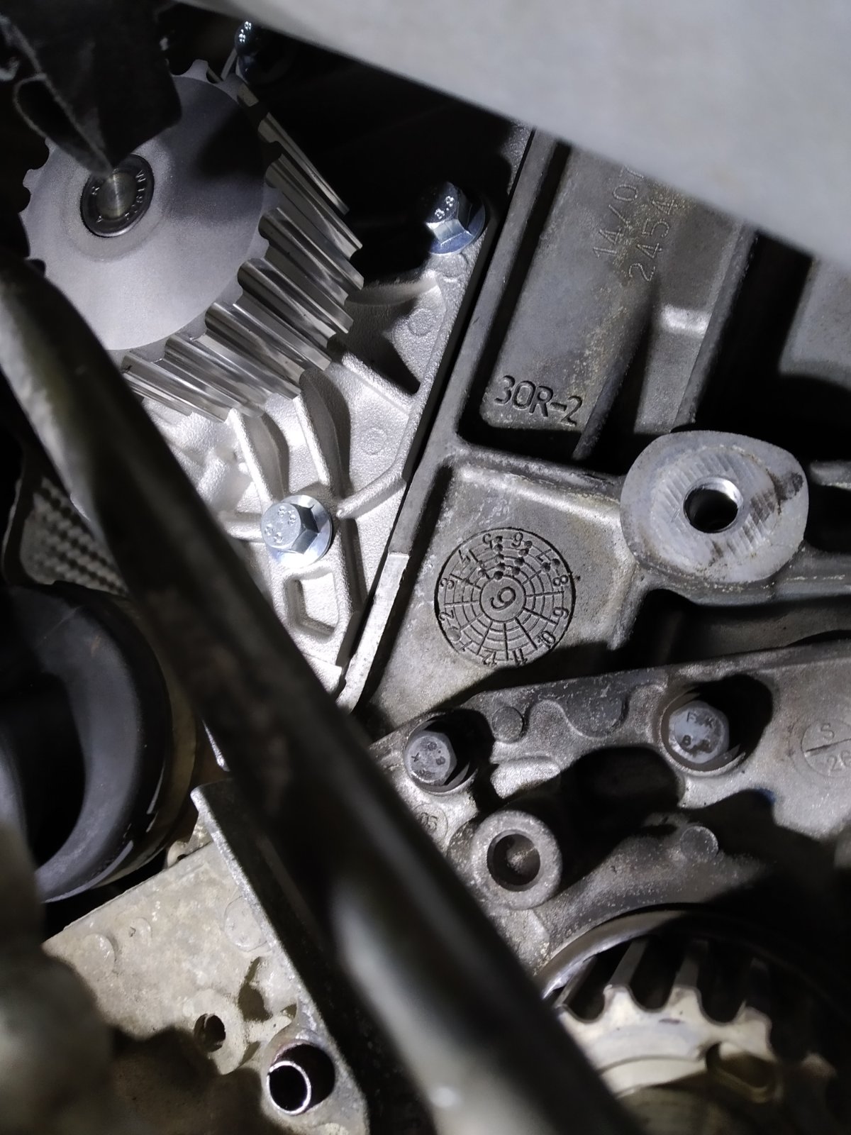

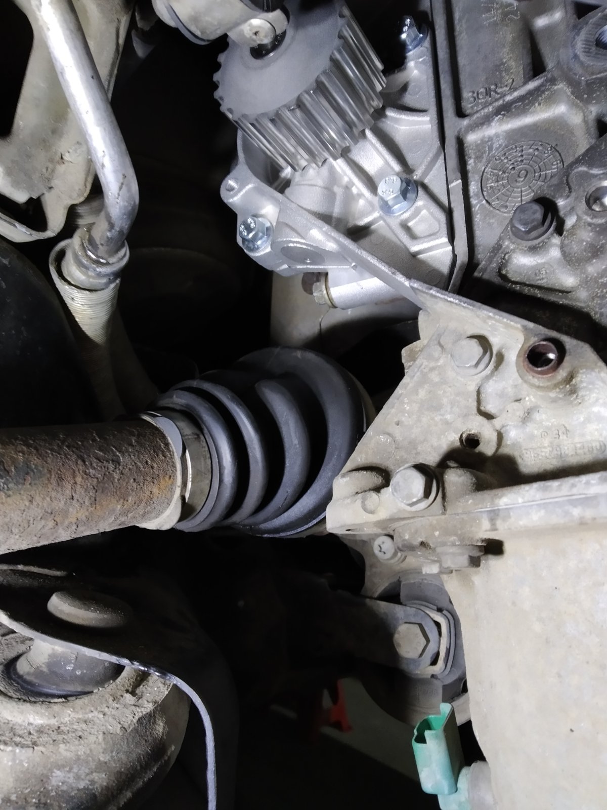

VICTORYYYYYYYY !!!!!!!
Finally i was able to dismount this bitch shield, and then it was easy to unscrew the studs and remove the old pump !
And finally... the new pump is mounted !!
Now for the fun part, put on the new belt, tightening, checking, and look if i forgot some pieces here and here :-)
Thanks to all for your moral assistance !

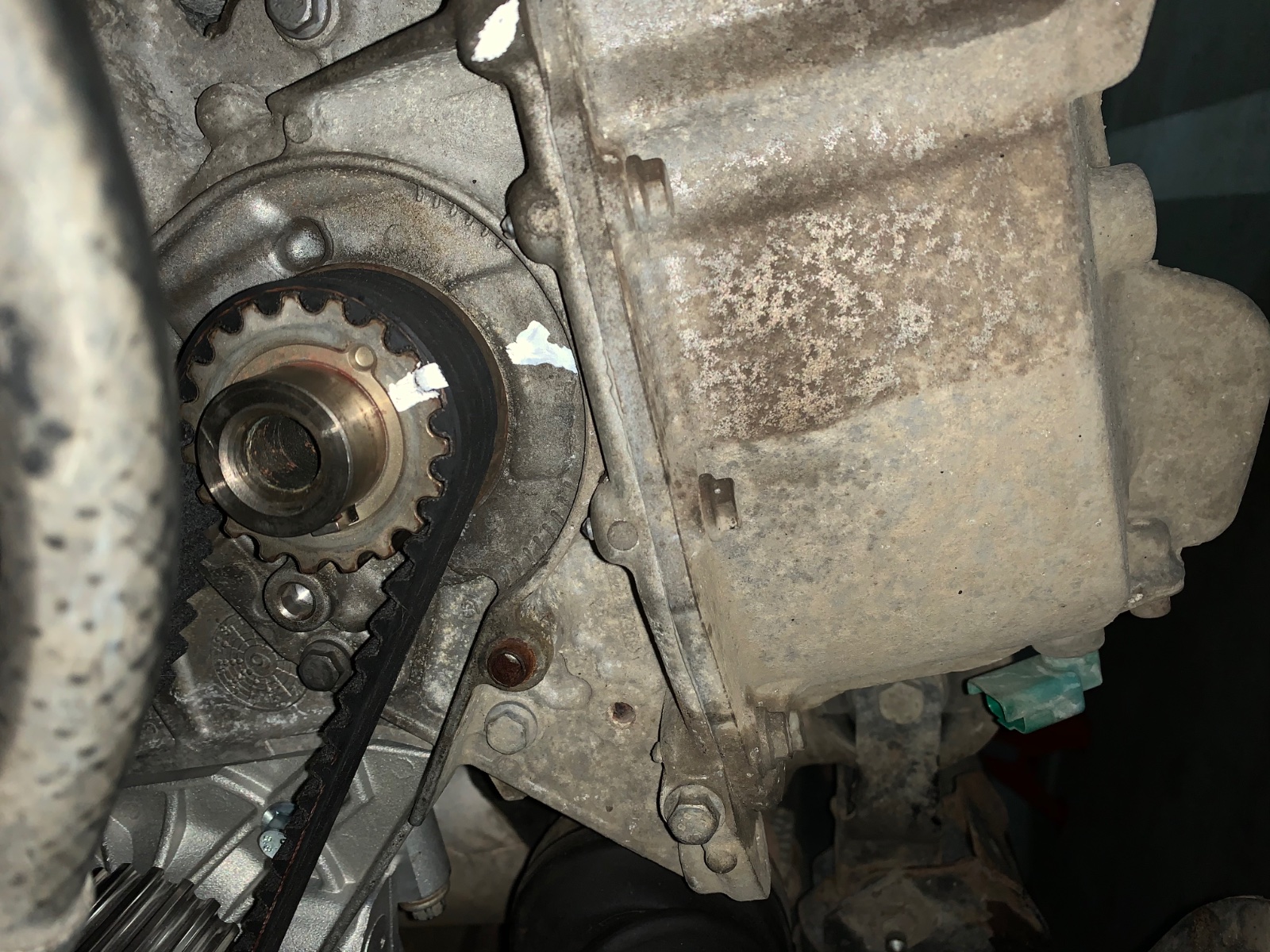

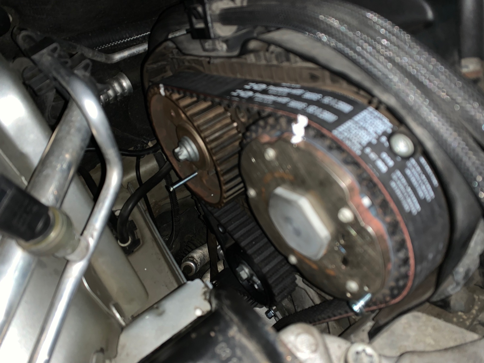

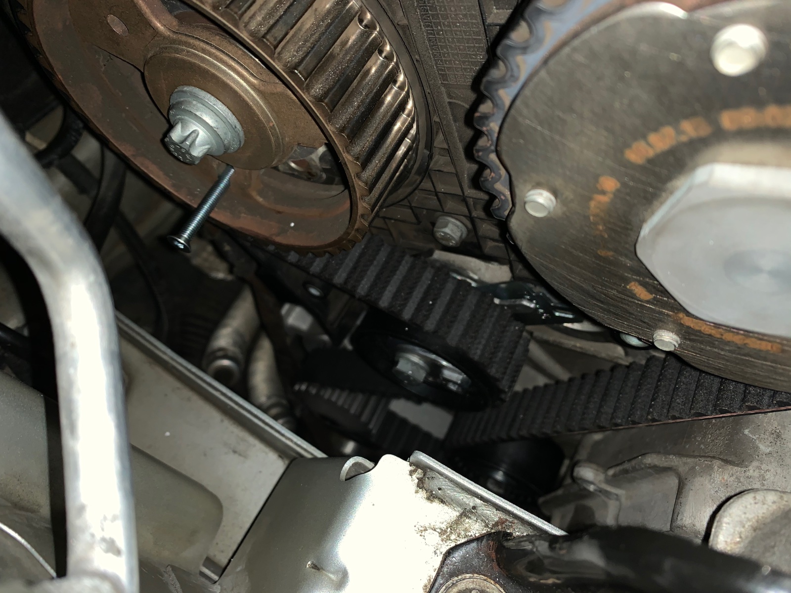

New timing belt on place. Tensioner set as the manual.
All the markings I have done at the beginning match perfectly with the new belt, so it should work.
The only “problem” is that the space is so tight that I can’t fit a torque wrench to set it at 21Nm, I hope my sixt sense is enough to judge.
