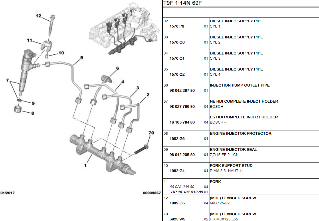

The Engine ECU is a Bosch Paul, as are the injectors - at least that was what was factory fitted: (7) Part 9802776680:
He has the incorrect engine - Siemens were fitted to the DV6C - yours is a DV6FC which have Bosch ones fitted.

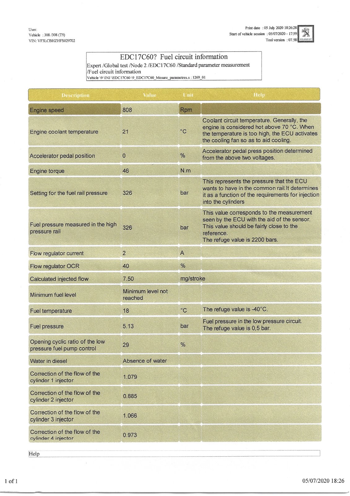

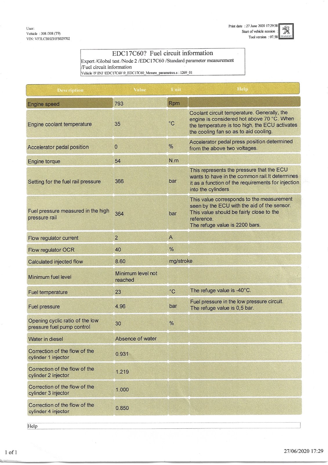

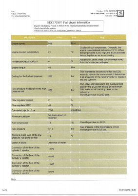

I did some screen shots showing before and after fuel circuit information.
This is the engine at tickover. The engine had been run recently so was slightly warm to start off with. The correction for No 2 injector is quite a bit higher confirming that it needed replacing.
I then increased the engine speed to about 2400rpm. The corrections for injectors 2), 3) and 4) then seemed to fall more in line with each other. Injector 1) did seem to rise above the others though. I'll be honest that I'm not sure what this means though.
This after the injector change. Engine was still at atmospheric temperature. Injector 2 correction has dropped right down, in fact it's now the lowest of the four. It almost makes the others look high!
I went for a short trip into town today, literally a couple of miles each way, and the engine hiccupped once. Now I may be hyper about this but now I'm worrying about the other injectors, specifically No 1).
